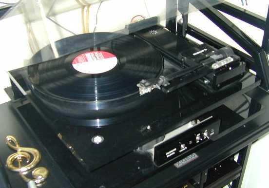

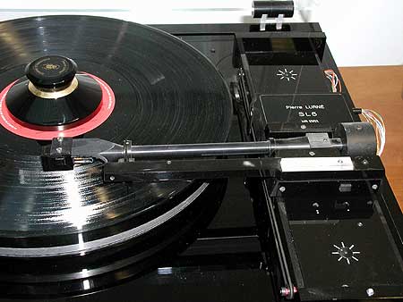

I was trying to see if there's any existing product out there that is thinking along the same line. All I can think of is the Pierre Lurne designed Audiomecca SL5 tonearm. If you gut the tonearm part out and keeping just the track and gliding mechanism and the armbase, what you have is close to what you have in mind. I would like to have something like the SL5 and try it with a high quality conventional pivot arm, say, a la Clearaudio Satisfy, straighten the offset angle at the headshell and mount that on the Audiomecca and simply using it as a linear tracking base with sensor. So the end product is more like an accessory that allows mounting different arms. If we use a 12" arm the whole thing can be assembled outside of the plinth of the turntable as a tonearm island.
Here are some interesting pictures.
Conrad Hoffman: "Rotating the head of an offset arm is not the answer! You must eliminate the offset. So, keep the standard tonearm, remove the offset and make it a bit longer. Now, just drive the pivot assembly along the back of the turntable in a track. Servo it, probably photoelectrically, but don't try for perfection. Let the tonearm do what it was designed to do. Try for silence and smoothness on the drive. I'm not sure what the best drive method would be, maybe a lead screw and DC motor, maybe a thin thread and drum drive or even a linear motor track."
SL5 & T5
More pictures of the SL5 arm.
Goldmund also introduced the same arm called T5 under their name, usually mated with the Goldmund Studietto turntable.

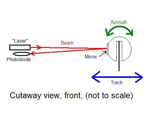

I have a similar plan as to that goldmund. It is going to be a short unipivot arm, with a mirror mounted perpendicularly over the pivot point. I will mount a laser/reciever on one end of the track, and bounce the laser off of the mirror and against a photodiode to control the speed. The speed feedback will not be on/off, but proportional to offset. This system should assure smooth travel, and perfect azimuth to boot.

@directdriver: You'd be well advised to leave the original armwand/bearing assemblies on the Lurne/Goldmund arms. They are vastly better(less resonant) than the Clearaudio Satisfy.

@tade: What's the connection between the system you're describing and perfect azimuth?
Did you mean zenith or tangency instead?
Frank
Frank
Berlinta,
So long as you set up the laser/reciever such that the headshell is level, any later change in azimuth should cause the laser to no longer fall on the reciever properly. It would be obvious then that something was amiss.
I would mount the laser/reciever as far away from the tonearm as possible. If you mount it a foot away, that is two feet of beam path. This could be much more sensitive to a change in angle than any of the other designs I have seen.
Thoughts?

Yes! That SL-5 is exactly on the lines of what I've been thinking about- thanks, never seen it before. No doubt, it too is far beyond my means.
As for laser and other position feedback, if you do the design right the sensitivity will be so high that there's no need for any extra beam path. The problem I worry about is manual cueing. I want to be able to grab the headshell and cue with the action no different from any manual arm.
