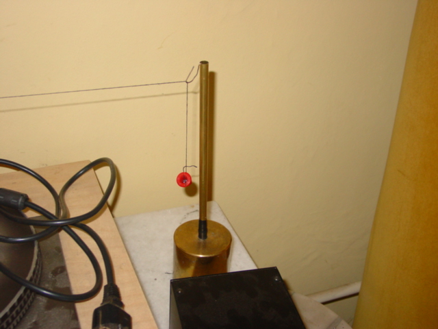

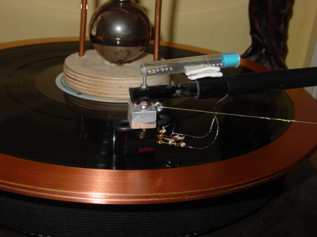

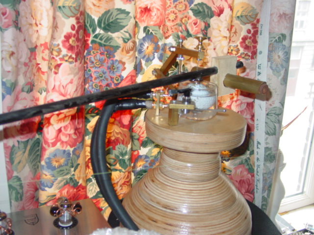

The tonearm I have is made by myself and it is a hybrid between Schroeder and the Well Tempered with a length of 60 cm. The wire is 2 meter long. I found out that it becomes better this way.
Care to tell us more about your DIY tonearm? It appears the headshell pivot point is not above the stylus.

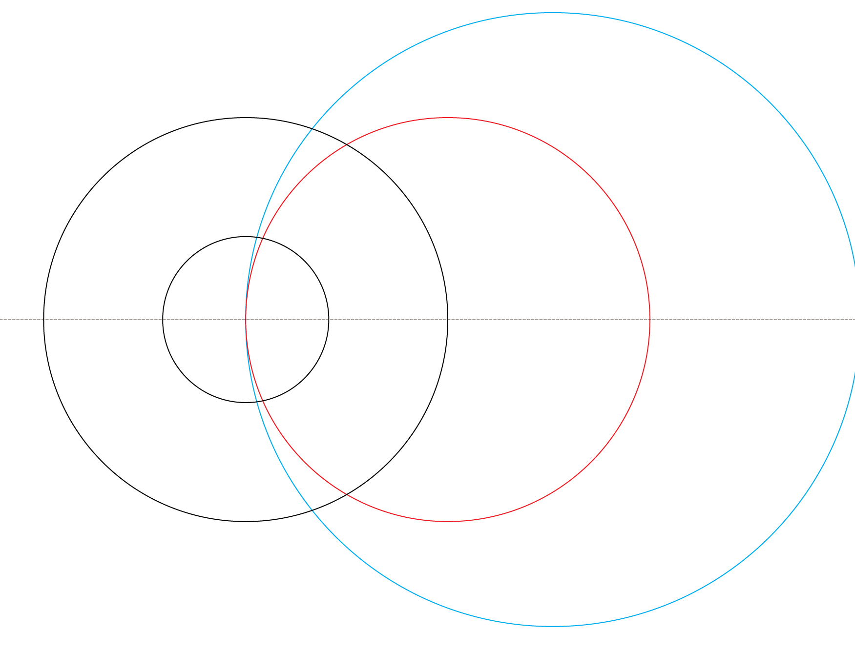

I have one question for you. If I understand it correctly, there is no anti skating device on your tone arm. So, I assume that there is no skating force exists.
Please see the drawing. As I understand, if the stylus travels on the red line, there is no skating force. If the stylus travels on blue line, skating force doese exist although it is smaller than the skating force on regular pivot arm.
Jim
Hi Jim,
The stylus(assuming the cart was mounted in a LT arm) travels neither on the blue nor on the red line(if I interpret your drawing correctly).
It is not correct, that there is no skating force present if it were to travel on the red line only.
If I could imbed a video here, I could show what I demoed a few times at the High End Show in Munich last weekend with a blank test disc...
Frank
Skating forces happens because the arm, or the cartridge is mounted with an offset angle, thus the friction has an "arm" respective to the horizontal pivot point of the tone arm. The Thales "easy" has skating forces that changes from positive to negative as it plays the record.
BTW the tracking error on the 9" Thales is not too much better than what you can do with a 10" "normal" tonearm.
Hi Jim,
Frank

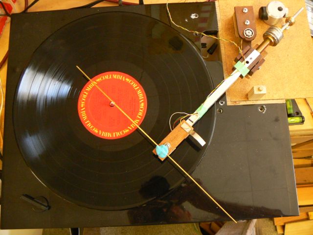

birch approach

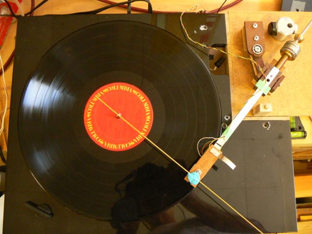

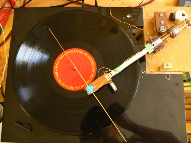

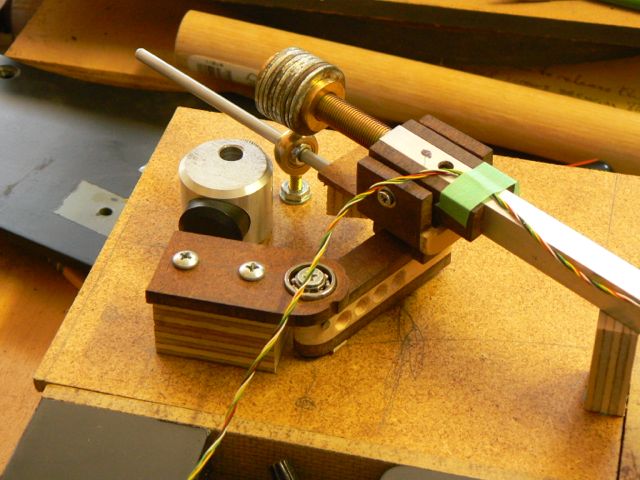

I've just been testing this arm. It's based on my understanding the Thales-Birch alignment DD posted and, obviously, in part on Frank Schroeder's LT. I also waded as best I was able through Mark Kelly's math thicket to glean what I could. They are both blameless for the results. The posts from Frank, Mark, and DD between pages 21 and 27 of this thread were very helpful
I've been fascinated by Frank's pivoted LT for several years and wanted to attempt something similar that wouldn't infringe on patents or otherwise step on toes.
The arm works and with an M44-G/N44ED @ 3 gr produces pretty good sound, very detailed. As the photos show, it maintains fairly accurate tangency across the record and doesn't mis-track. When everything is correctly adjusted, the stylus is centered in the cartridge and doesn't hunt at all.
The point B pivot is a Heim joint. I know there's gonna be flak for that, but it does deal with all the functions of that point and operates smoothly. There are a multitude of options for implementing point B, some not involving a point B at all - the Heim joint was just simplest. Since the weight of the tube is carried by the primary pivot arm, the joint can be adjust so the tube barely touches the hole it rides in.

I have not been able to follow this completely, but am I right in assuming that it is ony stylus friction that moves / keeps the stylus at the optimum point ???? What type and quality are the bearings?
BTW- nice execution, interesting .. if only time will permit me...... Oh well, some time....:(
AuroraB,
Thanks for your reply. Yes, the stylus does the work. Currently, the pivot arm bearings are a mix of two small hybrid ceramic and two larger stainless steel. The steel bearings are working well enough, but I've ordered hybrid ceramic replacements and I expect them to be significantly better. A critical factor is pre-loading the bearings. The vertical plane bearings are tiny flanged air tool bearings.
This isn't an easy DIY, but can be done with a modest shop like mine.
I really hope someone else takes a shot at this so we can compare notes.
