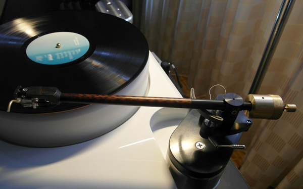

a pivoted arm(just a modification of the original) with zero tracing error that I built for this year's Frickelfest. Easy to implement on many a deck that started life as a record changer... and it can be done in less than two days.
Thank you for showing the interesting arm. I think that's the most doable arm for DIYers. I have thought about such designs before but simply cannot think of a way to deal with the vertical movement that can affect the tangency. I guess when you have a warp record you will have mistracking regardless of design. Is there's any picture showing how the spindle is implemented? I have to assume the spindle is one of the fixed corners of the Thales circle. When the headshell goes up and down which creates a vertical arc and how can you deal with the spindle side when it's a vertical straight line as guidance? Do you just let it simply mistrack on those warping occasions? Instead of a single light mass straight tube as guiding rod, I thought using a fork-like two-rod guiding mechanism sliding pass the tall spindle. Downside is that it adds more mass...
I have a salvaged arm from a Kenwood KD-770D turntable that has a removable headshell and the armwand is straight which will be a great candidate for this experiment and it's reversible. The Graham Robin is also another good candidate.
Thanks again for your kind contribution to this thread. I really like keeping the spirit of playfulness in this thread, as some people are just so serious about everything. Keep the fun coming! 🙂
Okay, from the higher rez picture, I think I know how it's done. The spindle is an adaptor over the existing spindle space with top portion being a half diameter cylindrical piece and the skating force will keep the rod touching the spindle constantly. (How do you set anti-skating?) And the contact point is the dead center of the spindle. Clever!!
Frank, you're a genius!
I have to assume the plastic spindle is stationary and probably only works on a record changer as the spindle is hollow with a hole all the way to the bearing. I think a fork like rod will work for regular spindle in normal turntables.

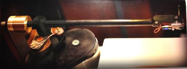

Another angle:

Hi again,
The white center spindle is stationary and, since it's made out of Teflon(no stiction!) will only add (minimal)friction to the lateral movement. It can be seen as a damping device(working in both planes).
The headshell-plate can rotate, thanks to two ball bearings in the black, upper headshell section. The wiring can be bent to act as a spring so the headshell-plate and the carbon fibre tube(mass: 0,3gr!) that is attached to it at a 90° angle "leans" against the Teflon spindle. The slight pressure required can be generated by other means as well, but I wanted to keep it as simple as possible.
I actually should have left the Teflon piece at its 7,15mm diameter and should have mounted the thin CF tube a little forward of the stylus plane. Would work just fine and omits the need to turn the smallish Teflon piece excentrically(somewhat tricky to do, since Teflon "gives" quite a bit under pressure).
Since the bearing after the conversion is super quiet, no noise is transferred from the bearing to the headshell/cartridge via the CF tube.
One of the original ELAC spindles(for single play operation, used here) has a rotating section at record "height", so no additional noise from a stationary spindle "rubbing" against the inside of the spindle hole is generated.
Antiskating is set via the built in mechanism of the deck(its arm).
No mistracking occurs when playing warped records... I tested it with a tracking ability track with the test record slightly wedged to simulate a warp 🙂
Downside: If one uses the somewhat stiff tonearm wiring to push the rod against the spindle you need to have room for the arm to be moved far to the right or you'll find it difficult to put on a record.The CF tube could be hinged off course.....
Try it, it works very well and it's worth the effort. Easy to compare(no tracing error vs. regular tracing error) the arm when the headshell plate is fixed in a conventional way(take out the washer between the black section and the headshell plate, fix it at the required offset angle, if need be, remove the CF tube...).

Looks like Frank's LT arm is a commercial reality, as exhibited at this year's Rocky Mountain Audio Fest/RMAF. Here are some pictures I found on the internet. It looks more refined than previous versions. So far, no picture that shows the guiding mechanism underneath the rotating cantilevered plate... just like any trade secret. 😉
It's being imported to the USA and sold direct by Xact Audio and the introductry price is $8900.

Frank Schröder interview for the 2012 RMAF:
What's new about the new Schröder tangentially tracking tonearm?
First of all, it does what all linear tracking tonearms try to achieve, namely holding the stylus assembly, not just the cartridge, in a position that equals that of the cutting stylus at all times/radii as it traces a record.
But where conventional linear tracking tonearms rely on either a servo mechanism to keep the error below a certain threshold or a passively driven, low to near zero friction bearing assembly, the new Schröder utilizes a patent pending mechanism that moves the foot point (base) of the tonearm as it traces the grooves such that perfect tangency is maintained at all times. No servo, no air pumps and hoses, no excessive effective mass in the horizontal plane.
You'll notice that the headshell doesn't feature an offset angle, indispensable for conventional pivoted arms to minimize tracing error related distortions. Here, the cartridge suspension will not be loaded asymmetrically as (when properly set up) there is no skating force for which to compensate, nor even an asymmetry in the mass distribution of the main arm.
The total displacement of the foot point is less than one third of the required equivalent for a conventional linear tracking tonearm. The forces required to move the entire arm are considerably smaller due to the proportionally greater leverage and the use of the finest bearing available. This accounts for a total bearing friction in the horizontal plane that is lower than 3.5mg.
The bearings for the vertical movement are zero friction/zero stiction designs, combining the virtues of an airbearing with the rigidity of a preloaded ball bearing.
All relevant parameters are adjustable, including VTA/SRA. I opted for a simple, yet mechanically sound shaft/collar arrangement. A preloaded set screw allows for changes without the risk of the arm "dropping". VTF is fine tunable via a small knurled weight screw behind the main counterweight. Azimuth can be adjusted within a range of +/- 3°
The effective mass falls into the medium to high category. Depending upon your choice of cartridge mounting plate (a proven concept taken over from previous Schröder tonearm designs), it ranges from 14 to 21gr.
The effective length of the main arm is 250mm, the pivot to spindle mounting distance 275mm due to the additional pivoting bar. Obviously, the overhang is Zero.
The armwands are handmade of either Snakewood or Grenadill, both treated extensively (a time and labor intensive process) to assure total immunity from changes in humidity or temperature.
The headshell is fabricated from a proprietary material that combines stiffness, low mass and high internal damping.
The cryogenically treated, high purity copper wiring runs uninterrupted from the cartridge clips to the RCAs Bullet plugs(XLRs available upon request).
