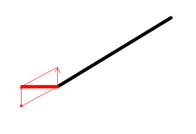

I can't copy the diagram in question so you'll have to refer to the above post.
With due respect to Horii-san, the diagram in section 2 and the explanation of it are pure bunk.
The stylus friction reaction force occurs because of relative motion between the disc surface and the stylus and it therefore must be in the plane of the record and at a tangent to the groove. The relative magnitudes of the stylus friction reaction force and the downn force are determined by the coefficient of friction between the record and the stylus, not by the geometry of the tonearm.
Since the magnitude of the forces shown in the diagram is completely wrong, the rest of the diagram is useless.
Admiting the stylus dragging force appears in the plane of the record and tangent to the groove, the force that appears just by friction is up and not down as suggested by our japanese designer.
You are absolutly right. May-be what means the Japanese designer is that this force (up) applied on the cantilver at the diamond point tend to reduce its angle with horizontal. Same effect than a *down* force applied on the head itself, right ?Admiting the stylus dragging force appears in the plane of the record and tangent to the groove, the force that appears just by friction is up and not down as suggested by our japanese designer.![]()
Fore once, physical laws are on our side: big modulations increase the friction forces, thus, the pressure on the diamond, increasing slightly the tracking ability ;-)
