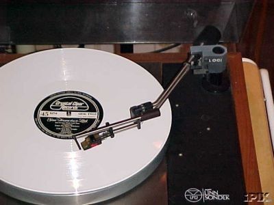

Sorry, but i do not understand. This is not a *strait arm*:The only other straight arm with detachable headshell I can think of is the tonearm on the Kenwood KD-770D integrated turntable.
Looking at your image, it is obvious that the headshell makes an angle with the arm, so the centipede force is there.
What i called "strait arm" is an arm where the cantilever supporting the diamond is aligned with the pivot.
The form of the arm between the headshell and the pivot is just a matter of design. "S" arms are just the worse response in matter of rigidity, resonance, and weight. The form of tha arm itself changes nothing in geometry and centipede force, as long those two pieces (head and pivot) stay at the same place.

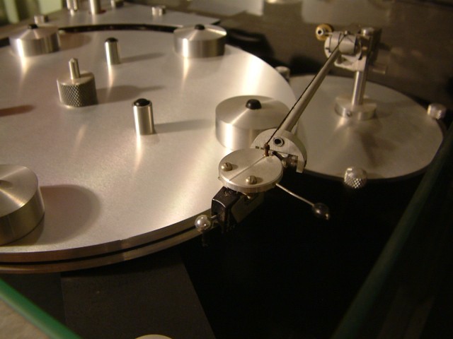

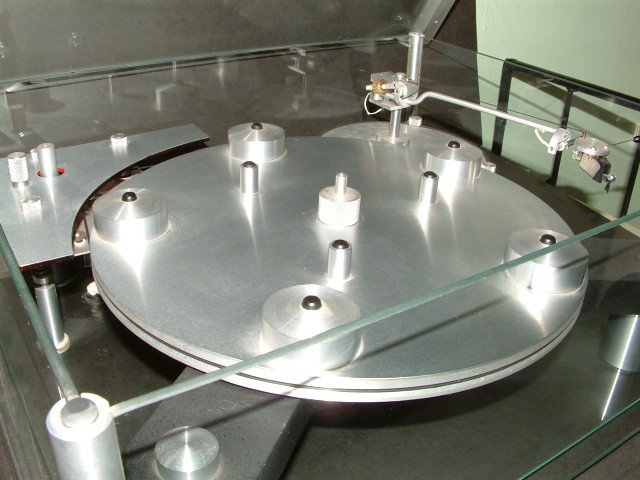

Now that weird arm above reminds me of the Vestigal tonearm:
Another tonearm that inhibits vertical motion at the base is the Loci tonearm:
