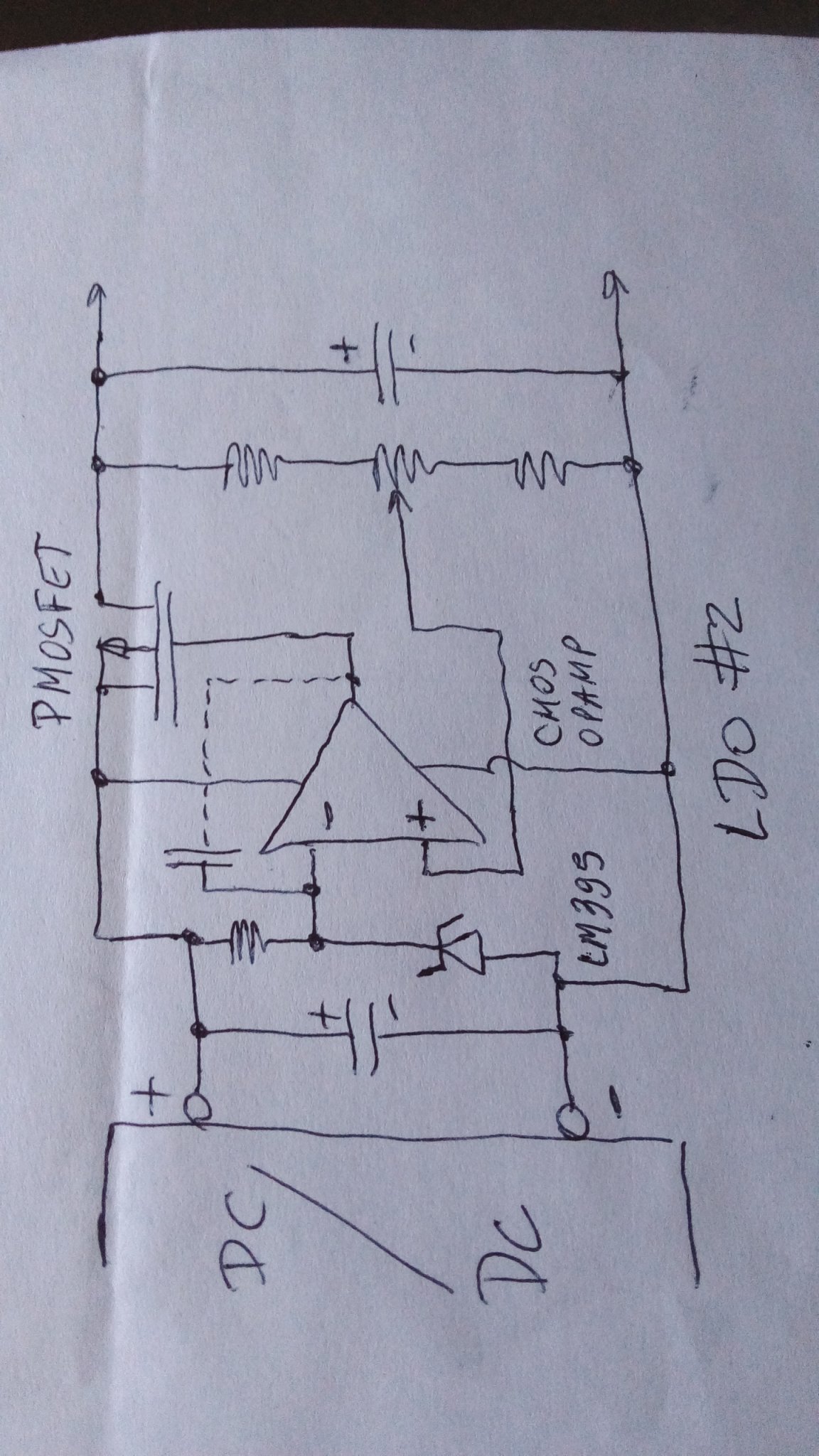

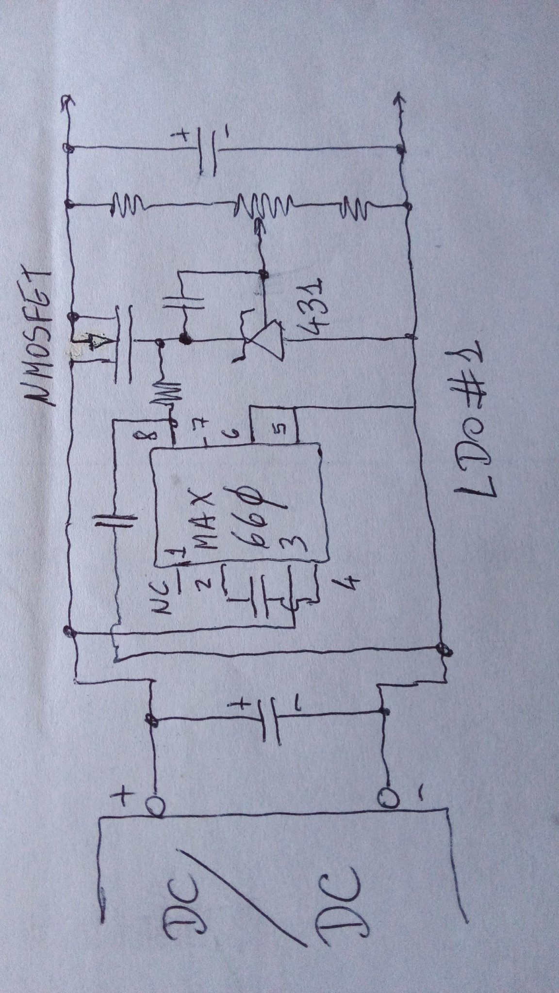

Two ideas about home made LDO.
The #1 uses a charge pump to create twice the DC/DC voltage output to have large enough gate voltage over its source to operate NMOSFET as series pass.
The #2 uses a PMOSFET plus a CMOS OpAmp and a micropower reference. As PMOS needs gate voltage below its source, no need for charge pump.
Obviously each has their pros and cons.
Reactions: ximikas
