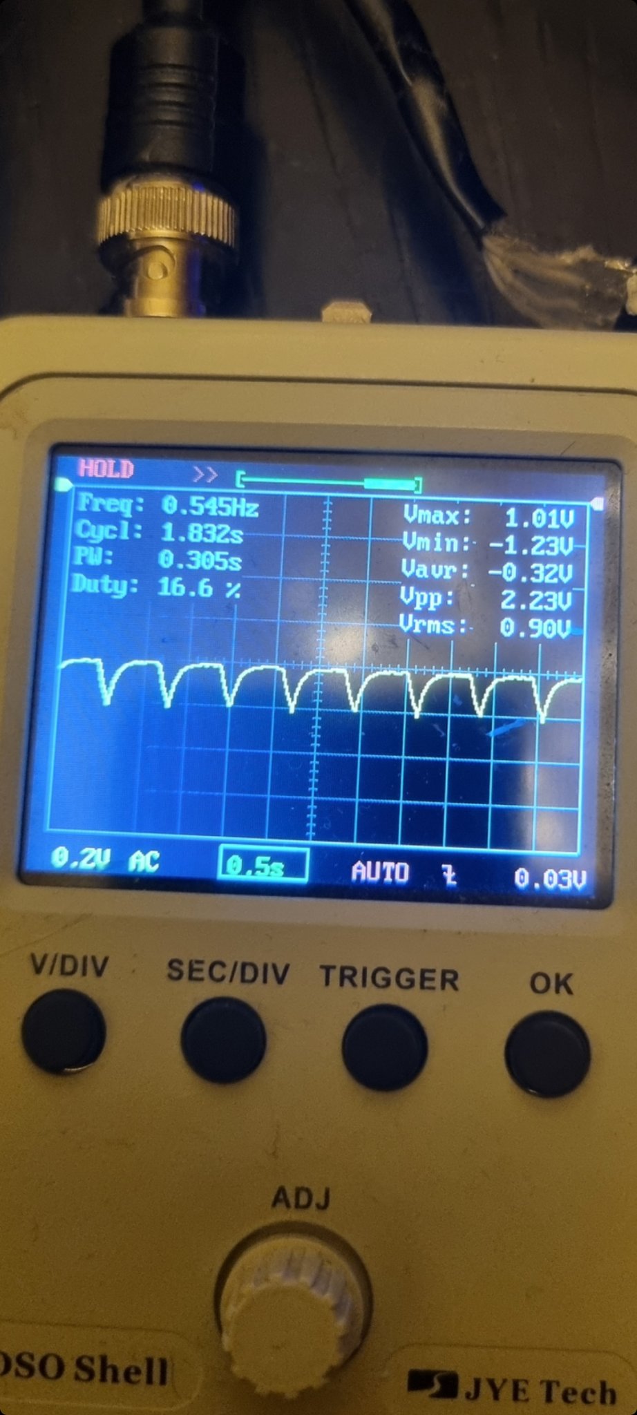

This is the oscillation if I use resistor in series, also if I use a diode. Adding capacitance on the tablet side lowers the frequency, this is the waveform with 100ohm resistor and 7 x 4700uF capacitors.
What could be causing this?

Oscillation caused by internal dc dc converters starting and stopping , or changing duty cycle quickly ,inside tablet. Cpu power consumption is not constant, reducing it while idle , changing operating frequency , thus causing these current peaks. If you put resistor in series , voltage will be lower , thus current will increase. With inductor you may a little smooth it , without dc voltage drop. But you can't put it on ground line, because then you will add all the ripple to audio ground wire .
Thank you for explanation. While I understand why resistor would cause this, I still can't understand why a diode would cause the same behavior.Oscillation caused by internal dc dc converters starting and stopping , or changing duty cycle quickly ,inside tablet. Cpu power consumption is not constant, reducing it while idle , changing operating frequency , thus causing these current peaks. If you put resistor in series , voltage will be lower , thus current will increase. With inductor you may a little smooth it , without dc voltage drop. But you can't put it on ground line, because then you will add all the ripple to audio ground wire .

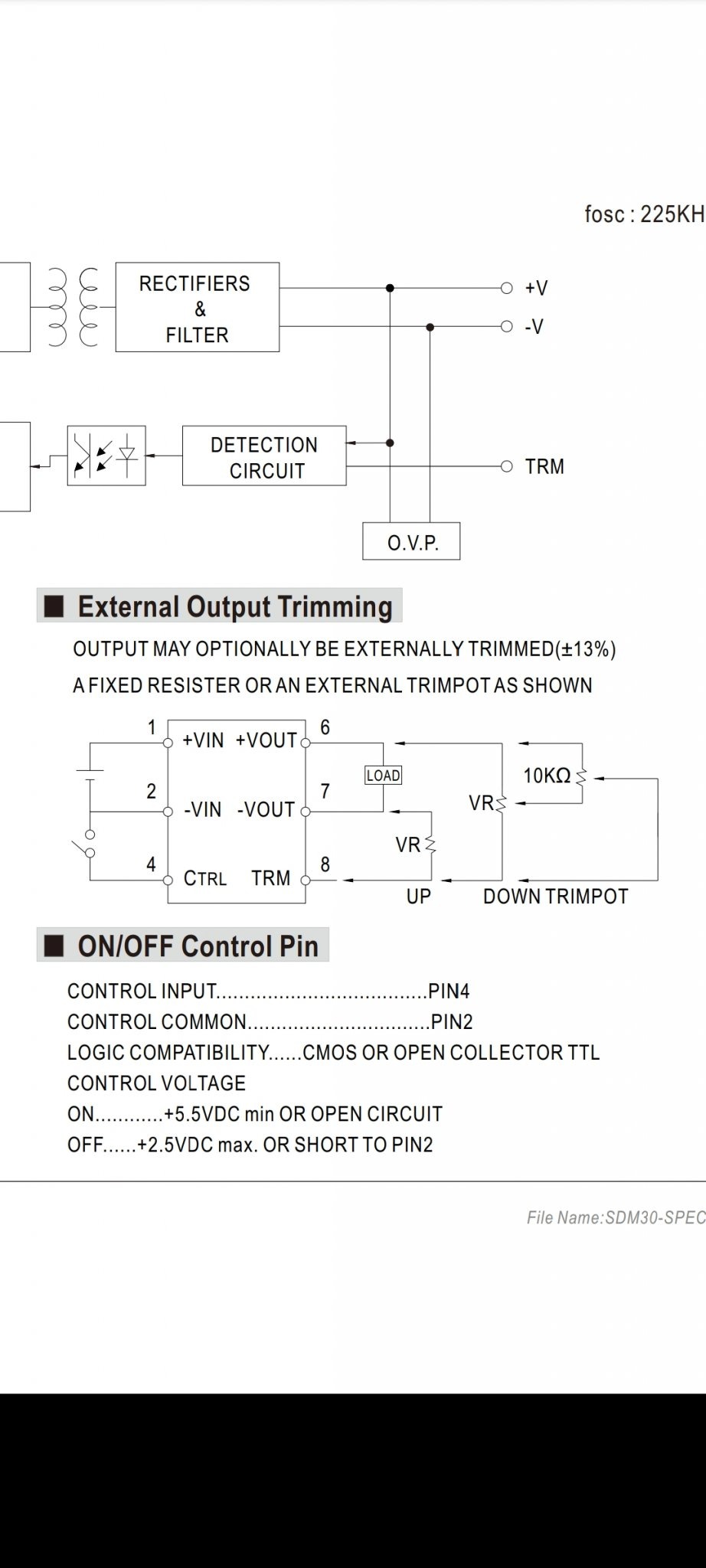

I am about to order Dc Dc converter,
Meanwell SDM30-12S5...
5v 5A
There is a trim pin and datasheet claims that it's output can be adjusted by +-13%, this means that I will be able to set voltage to 4.35v, thats great.
Is there a reason not to use this one for my case, before I order? I think that this one is as good as I will get.

Looks expensive , but it should work . Datasheet specifies efficiency 80 percent , but thats because of low output voltage , probably diode at output ,not SR. Unknown parameter is maximum load capacitance allowed ,but because converter limits output power , it should charge some additional capacitor without problem, if you separate it with inductor.

It is isolated & regulated, 47 - 100 uF input cap required, no info if output cap is required, I guess it isn't then.Check that it is isolated and regulated. Many of them are unregulated. And verify the need or not for extra output/input capacitances.
Only thing I'm not sure about is what resistor to use for trimming voltage. Datasheet states fixed resistor or pot.
This is all about trimming stated in the datasheet. If I understand correctly, I don't need a resistor at all. I just need to connect TRIM pin directly to -VOUT pin. Based on how use of pot is shown.
According to trim pin connection from picture ,on the right, named down , trim pin should be connected to out+ via small resistor or directly for decreasing voltage. Internal resistor limits adjustment to 13 percent as i understand. You can use small resistor for load like 47 ohms for test , anyway output voltage is regulated, load independent.
Ok, you both confirmed my assumptions.
Will try with low value resistor and see if it is down to -13%.
