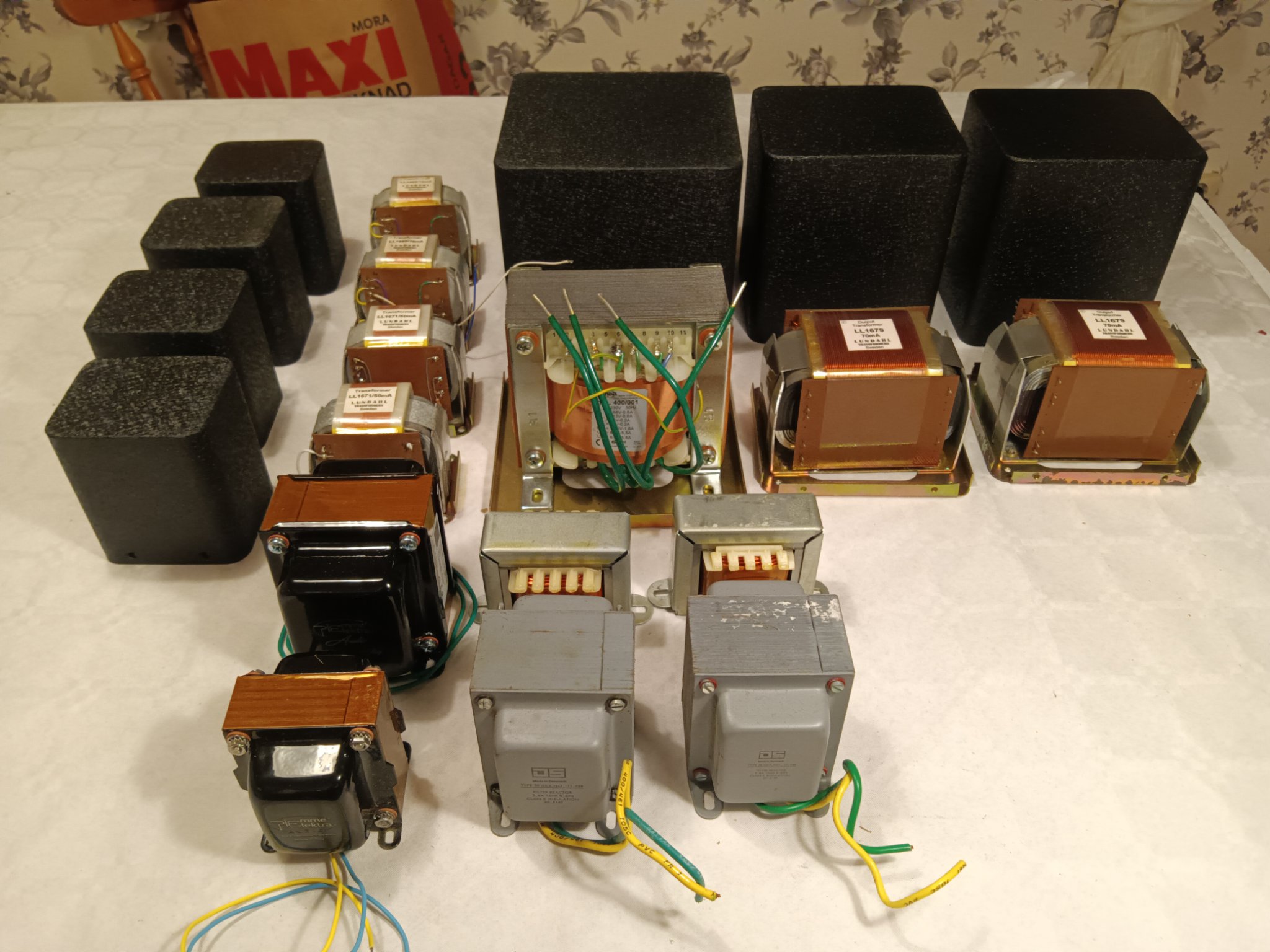

To be fair, only some of it arrived today. The black chokes, the open fram ones, the Lundhal OPTs and the large mains transformer are recent purchases. The ITs to the left are leftovers from old projects that never happened, and the large grey chokes are pulls from some kind of low voltage power supplies.
The idea is to use all this stuff and more to build a nice IT-coupled 300B SET with LCLC filament power supplies.
The little that I have built using transformers for output makes me wonder why I waited so long. Something about the sound is addicting. Have never used chokes a power supply. Maybe that will be on the short list. I have 6SN7 tube build that is up next.

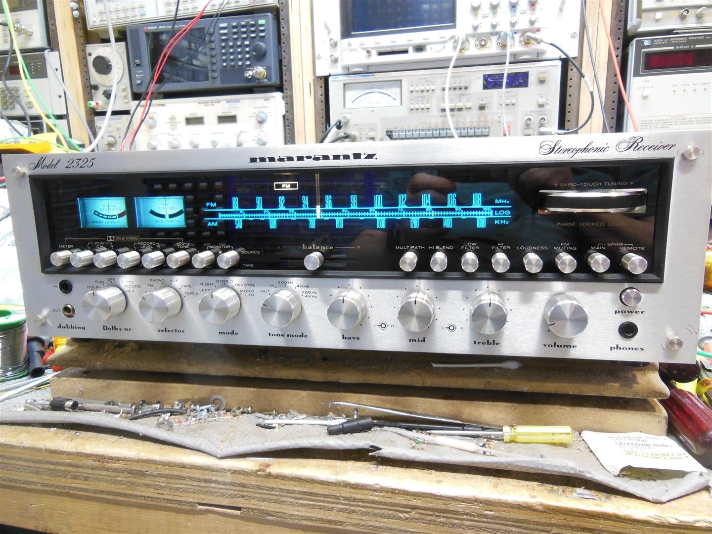

Just working on a 2325. Degraded big time with multiple faults I wasn't told about. Someone scratched the faceplate and nuts by using pliers. 🙁

This is just a quick snap of it so far. Any complaints? The last fault is no stereo on FM, and I already fixed a few other faults in this area. I'll be overjoyed when this one is done. But guess what? It is every bit still a Marantz 2325, same schematic.

2325, no stereo on FM? We ran into the same issue. Check out the traces on the board. We had to bypass a couple of lifting traces. Note in the schematic how the MPX decoder works...
It is a bear. I saw it when it was all taken apart and he took before and after pictures of everything. But it is a good looking unit. Sort of like a 747 before they went to a glass cockpit.

Yes, checked all that. Thank you. Been down this road a few times over the years. Someone had chewed on this problem and had messed up the detector alignment so badly the FM didn't even work.
No, it also had problems with centre tune varying with signal strength as well (after alignment). Rebuilt the detector using some matched parts, problem gone. Now all the various mute signals are fine and I still don't have FM stereo. Shorting the HA1156 pin 6 to ground lights the lamp, osc runs and locks. Before I was getting excessive HF noise, and that killed the stereo. Shorted that to ground (H319 anode or C333) and it switched to stereo no problem before. I am sure the HA1156 is fine, it worked before and I haven't touched anything near it. It still detects the pilot and happily locks to it. H303 is now off as it should be for stereo. No trace problems found on this one - yet. I'm also not happy with the sensitivity, not awful but not normal either.
I'm just really tired of fixing all the problems it had. It had a dead left channel in the buffer amp, low bias out of range on one channel and a bunch of small stuff, bad relay of course.
It came in for lamps and noisy controls. Right.

The nightmare receivers to work on? Marantz 2500 and 2385 in the phono / function PCB. Once someone else has been inside you have your work cut out for you! I'll include MPX faults in these older Marantz receivers (like the 2325) tough nuts sometimes. Far too complicated, too many places for faults and sometimes they almost work (like this one). Other brands could be just as much "fun".
