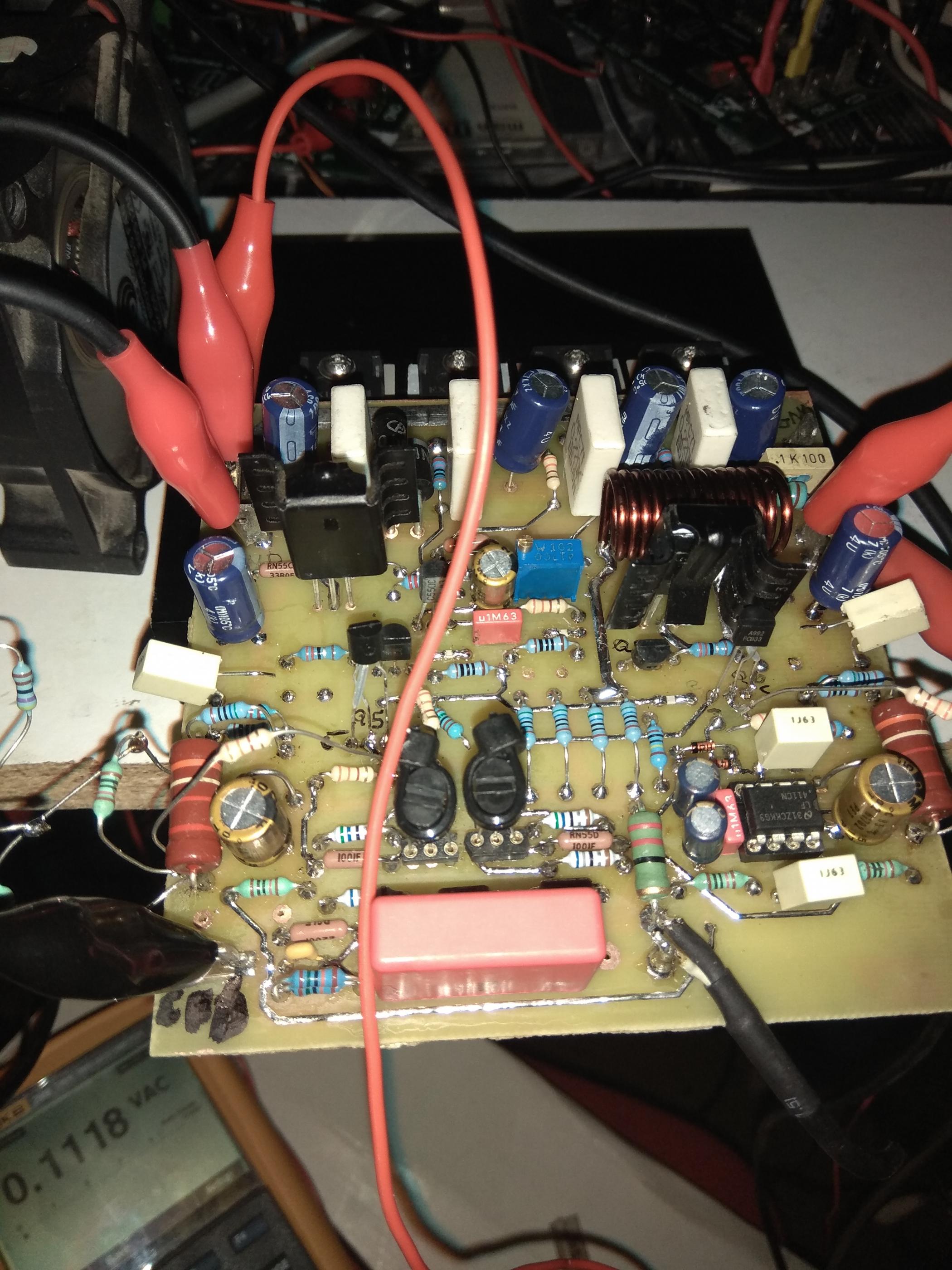

Indeed! That's a good looking board there, George.
Thanks. It does look good in the small photo, but it does contain many flaws. I live with them since these are just protos. In this case I laid this thing out over three days while my wife was in the hospital. Most of it was done on a crappy laptop and I didn't do such a great job. I started putting parts in it yesterday and have decided that I need to do it all over, since too many parts don't fit or collide. I will populate several subsections to test them. If the results are good I may build up one or both complete channels to see how it sounds. As with any of the boards that could become a Tubelab product, there will be several proto boards made before I shell out big bucks for production quality boards.
Do you guys ever have problems with failure of soldered thru-pins etc. on homemade boards with no plated vias?......I've always wondered if this was a common problem in this situation
I solder the parts on both sides, and where this isn't possible (radial electrolytics) I solder a wire to the track on the top side and run it through the hole with the part lead, then solder both on the bottom side. I have been making boards this way for nearly 50 years, and some of my old ones are still working. The boards from those days that are not still working, were not bad due to the PC board......just crappy designs, most just didn't work in the first place. They are now in the "box of broken dreams" to be robbed of parts.

Thanks for your replies. I guess it's safe to assume this was just some sort of glitch in Baldwin's process. They used little square pins (like wire-wrap only shorter), pressed in place at the vias. When I think about it, they were likely wave-soldering the bottom side of the boards, but the pins on the top sides would've required hand soldering. There must've been some incompatibility between the 2 processes, because it resulted in many failed joints. Kind of a shame, because it's rendered useless a lot of otherwise-viable instruments due to prohibitive repair cost.

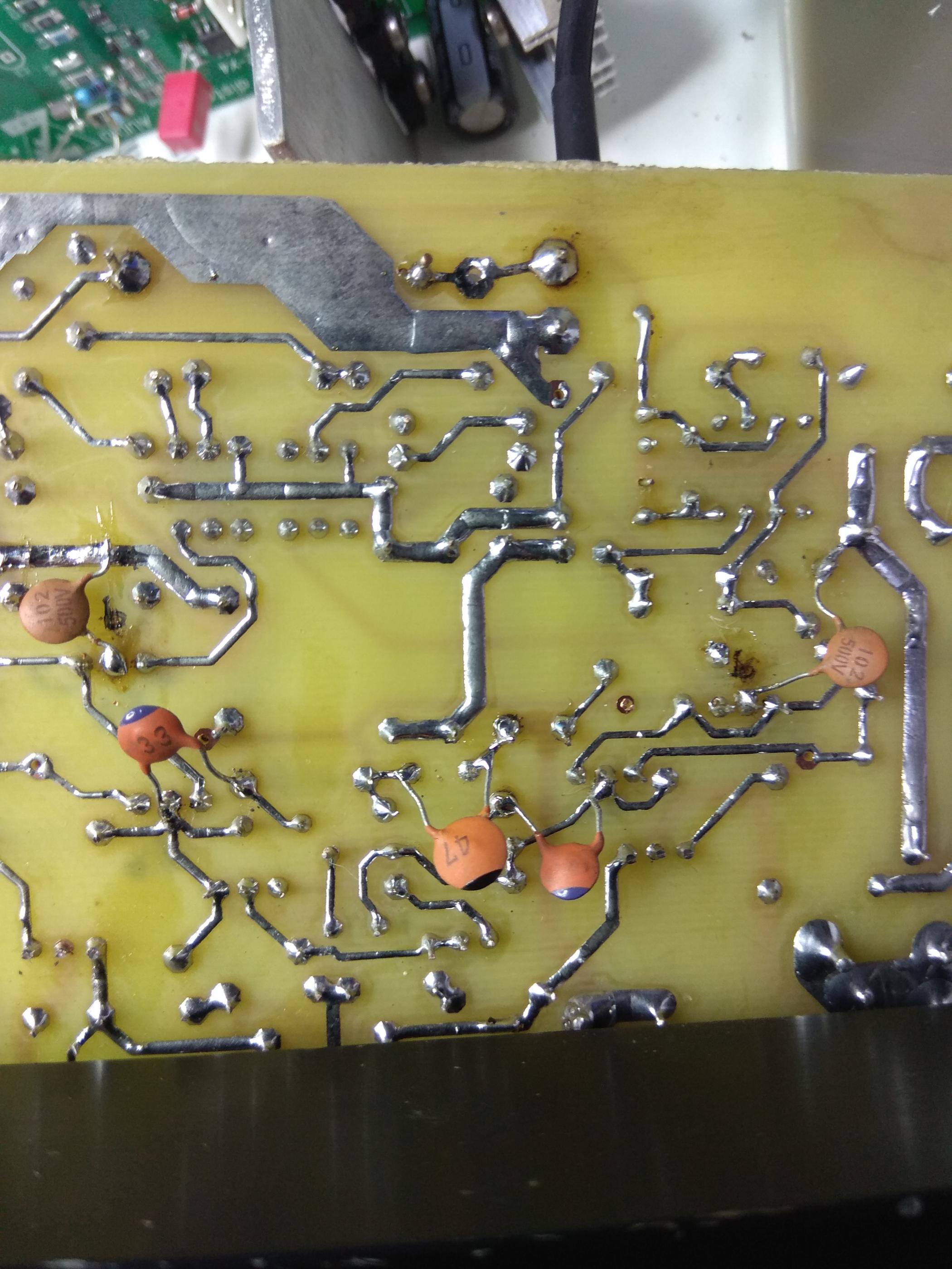

Two side pcb
Here is one of my last double side home made pcb.
Always i use small guide drill for two side transperance alignment.
No vias, just two side soldering.😉
I manage to lift electrolytics a little to be possible the two side soldering.
Never failed!

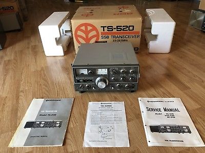

I bought this
I bought this, it just kinda looked cool. I don’t have a license and I have no idea how to use it but it’s old and interesting and should be here in a few days. I believe the receiver is solid-state and the transmitter is hollow state
Boy, that takes me back. My wife purchased some clothing for me at that very store in 2007 after I took an unintended dunking at Lake Lure. How time flies!It was hot so I stopped at Mast general store and bought a Tilley hat.
Nice rig! The transmitter has two 6146As in push-pull, driven by a 12BY7 (I think). The outputs are easy to find, but the driver is becoming a bit scarce. Anyway, you should consider contacting your local ham club and see into getting a license. You'll have a blast. 🙂I believe the receiver is solid-state and the transmitter is hollow state
