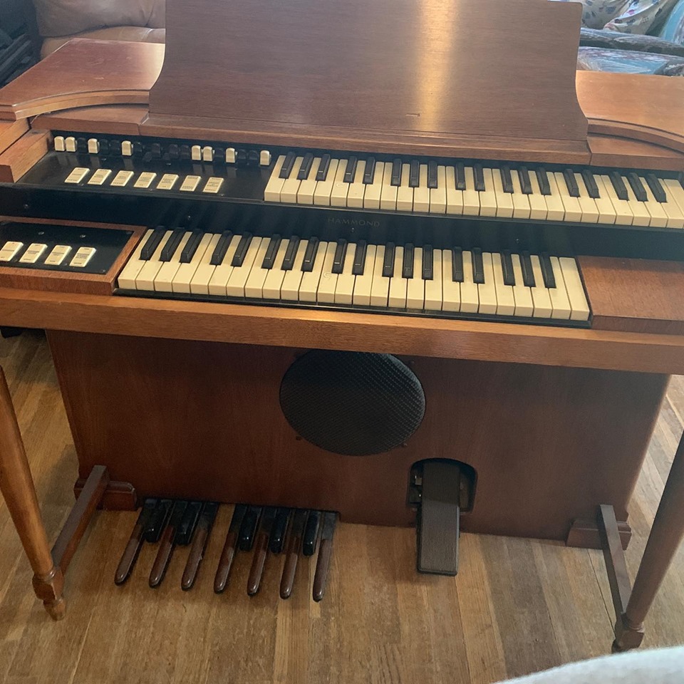

Hammond M3 organ. Did not really buy it. Got it for free. Needed some oil and is mostly working otherwise. Vibrato circuit may need a little work.
Sweet! Always does me good to see those lil' Hammonds going to a good home and not sitting out on the curb.
Does the vibrato have a reiterating, 'uh-uh-uh' sound instead of the smooth wavering effect?
Oddly, the vibrato sounded like it went into cutoff the first day I fired the organ up and then settled into what I would expect for that organ a day later. It is not the Leslie sound for sure, but not so bad.
