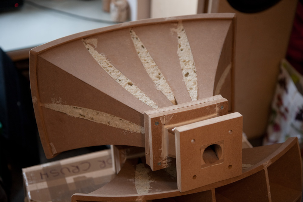

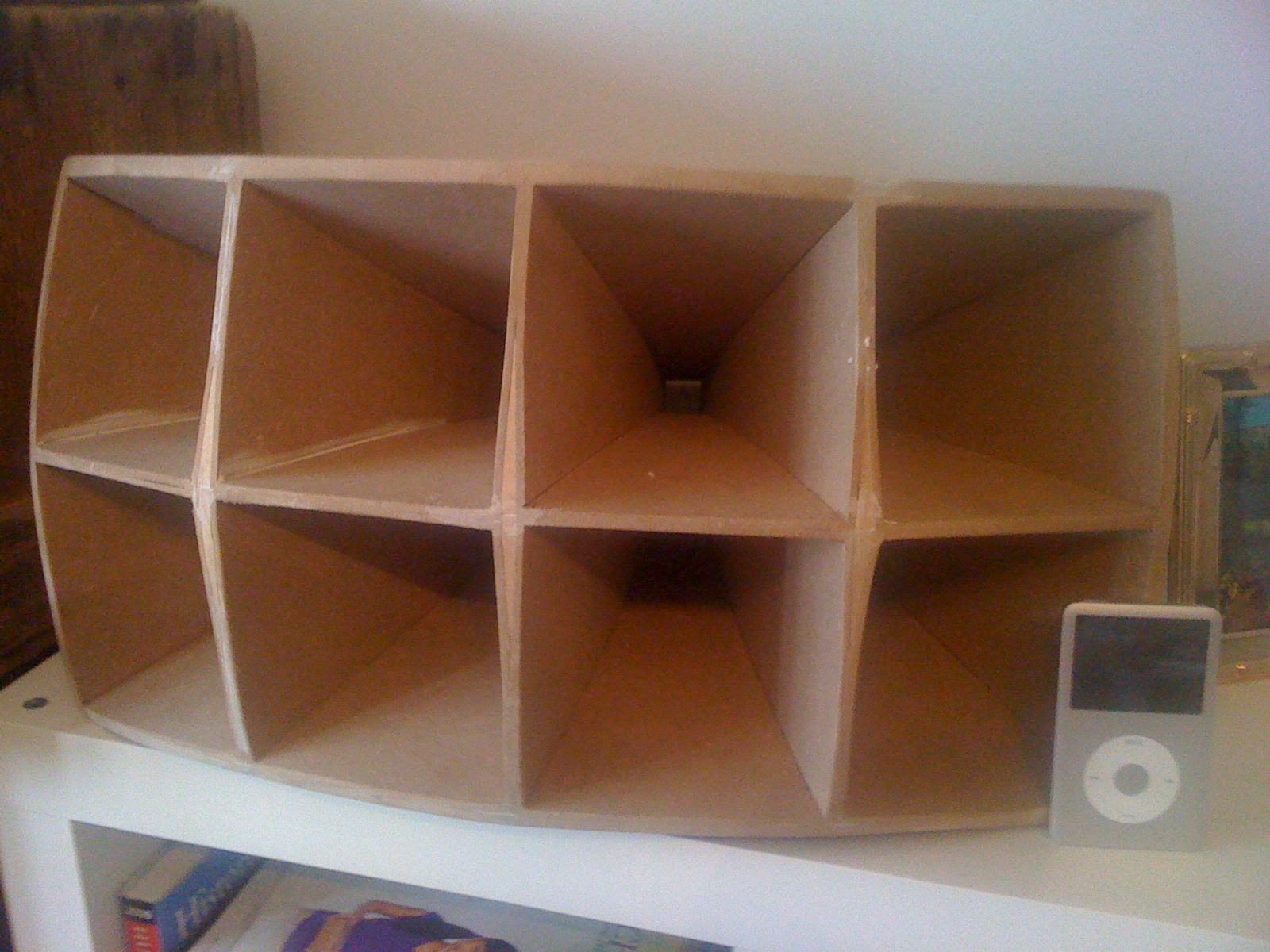

They have arrived!
pics will need to wait a couple of hours I'm afraid as my Lightroom library needs a rebuild.
heres a bad one from my cellphone to keep you going

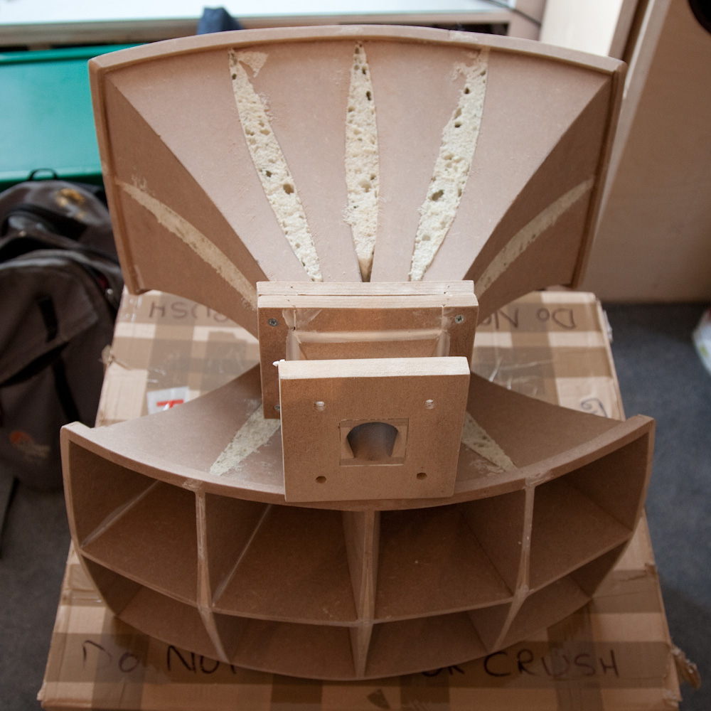

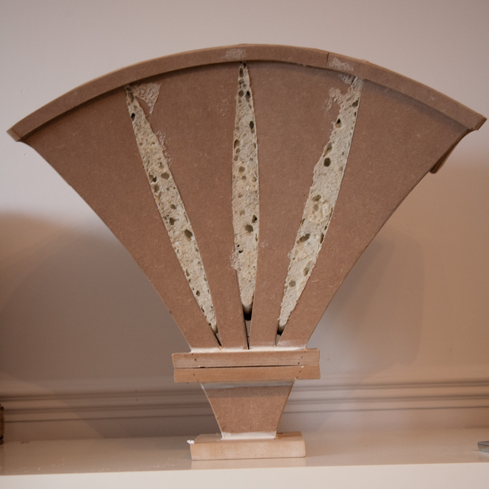

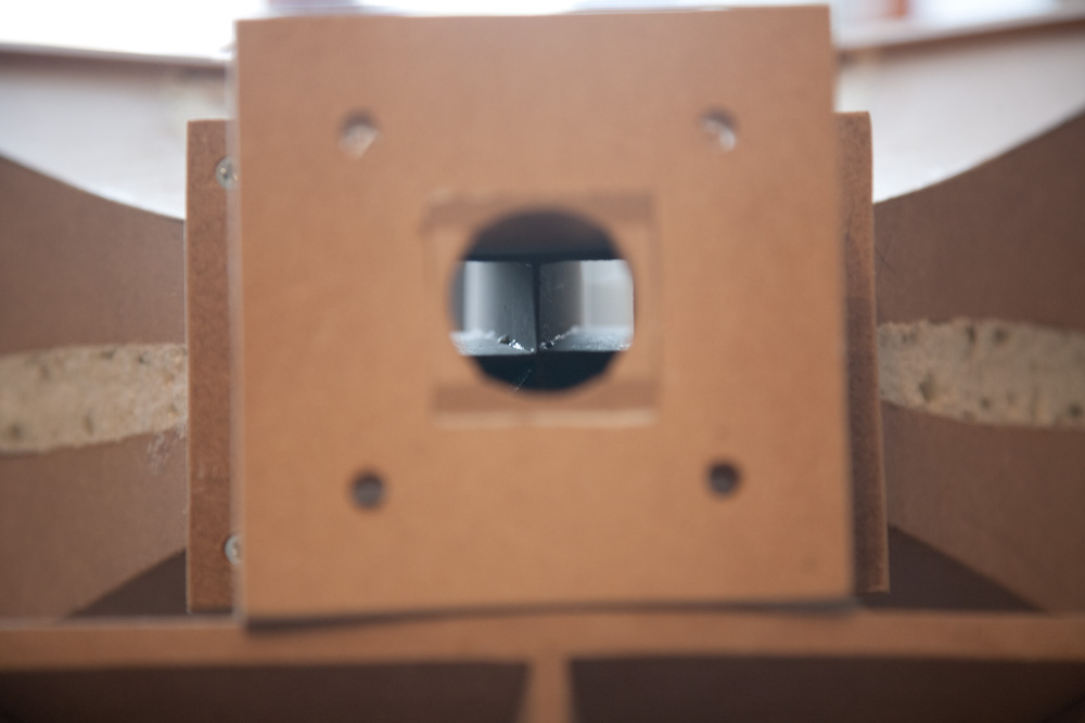

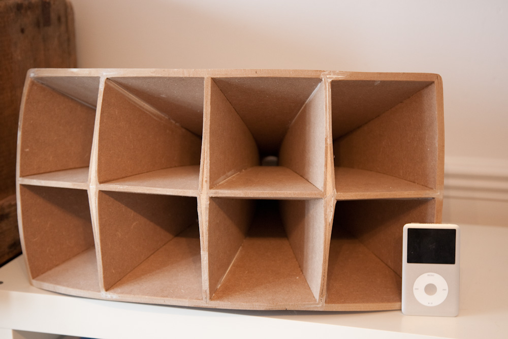

Here they are
Need a little finishing but way better than I could do. filler & paint and I'm away!
