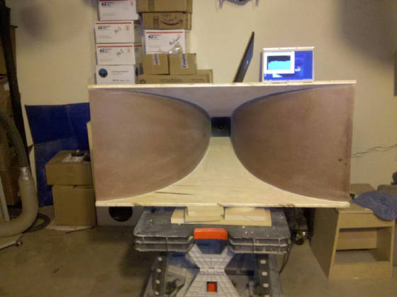

Thanks Cal. I cant quite muster the £50 I need to get a laser gut guide for the final paper horn - especially if I cant make the general basic working model 😀
There's always this type of tractrix to try. It looks a tad simpler....
.....famous last words

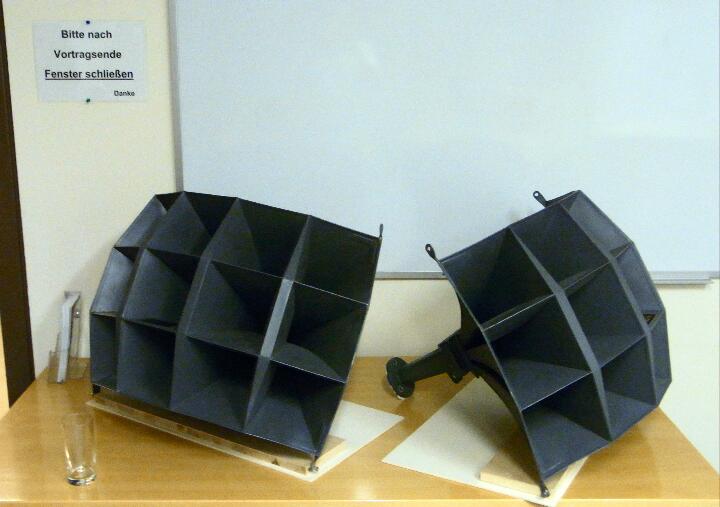

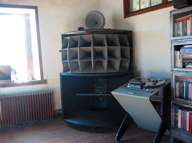

BTW have you seen this little setup?
multicell heaven click on the images to enlarge
I love the multicells as stand alone speakers in their own little cabinets.
Dream indeed. I think that's a great way of serving up a multicell. I also can't help but notice the similarity of the bass horn with a Cornu. I wonder if he has incorporated some Fibonacci in there.

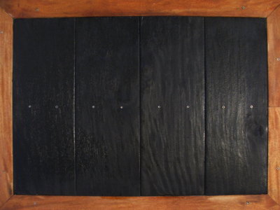

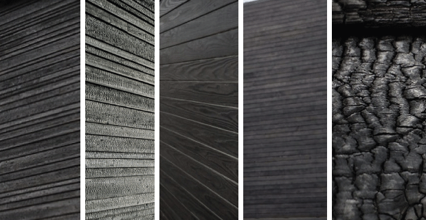

here are a couple of pic ideas for the bass cabs. Its called Shou sugi ban. Heres 2x little video linky:
Shou Sugi Ban being in Japan
http://www.youtube.com/watch?v=L4CeJIaI5Vg
You can brush and wash it to smooth it out as well if you prefer a smoother look
What do you think as a facia cladding for the bass cab?

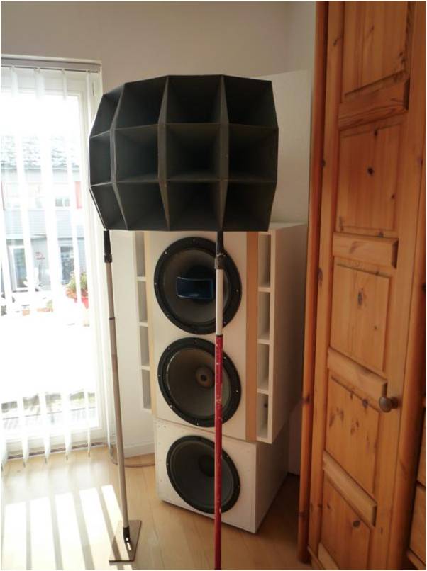

I also like large drivers and still believe that You cant beat qubic inches.
But, i don´t like x-overs, especially if they´re used in the fundamental voice region, say 300-3kHz.
This means i have to use LF drivers that are very good in the voice area, 10-12" is, in my opinion, the best choice for this.
We still want the fantastic low level dynamics that large drivers deliver, what to do?
First try, turned out really ok, was this:
A tiny litle speaker that actually is allmost a 2-way design, the larger of the round parts is a Beyma 21L50, this ,unfortunately out of production, 21" driver is lowpassed at about 85Hz, the smaller round thing is a Beyma 10G40, only lowpassed at about 3k, firing backwards in what could be regarded as a TQWT but with exponential expansion.
The square thing is a Beyma TPL150, AMT driver, system sensitivity at around 100dB and fantastic low-level dynamics.
It moved furniture at pretty modest levels so the 21" was perhaps a bit too large for our livingroom.
What to do then?
Ingvar
Your speakers are beautiful Ingvar! It's ironic that I saw them because I've been conceptualizing something very similar in appearance. I plan to build a similar set but quite a bit more modest with a tiny 15" woofer, 8" mid and a planar tweeter. Although mine will be a bit smaller, I'll separate the speakers into top and bottom cabinets.
Thanks for posting the pics; it's great to see what I'm shooting for.
looks more like a modified Iwata to me
add rounded solid wood at front edge of top and bottom, and you have it 😉
the construction still does have a few weird angles that tend to be difficult
but it looks cool

Several of those non circular tractrix type horns show up in a google search for tractrix. Only the two vertical sides follow the tractrix curve

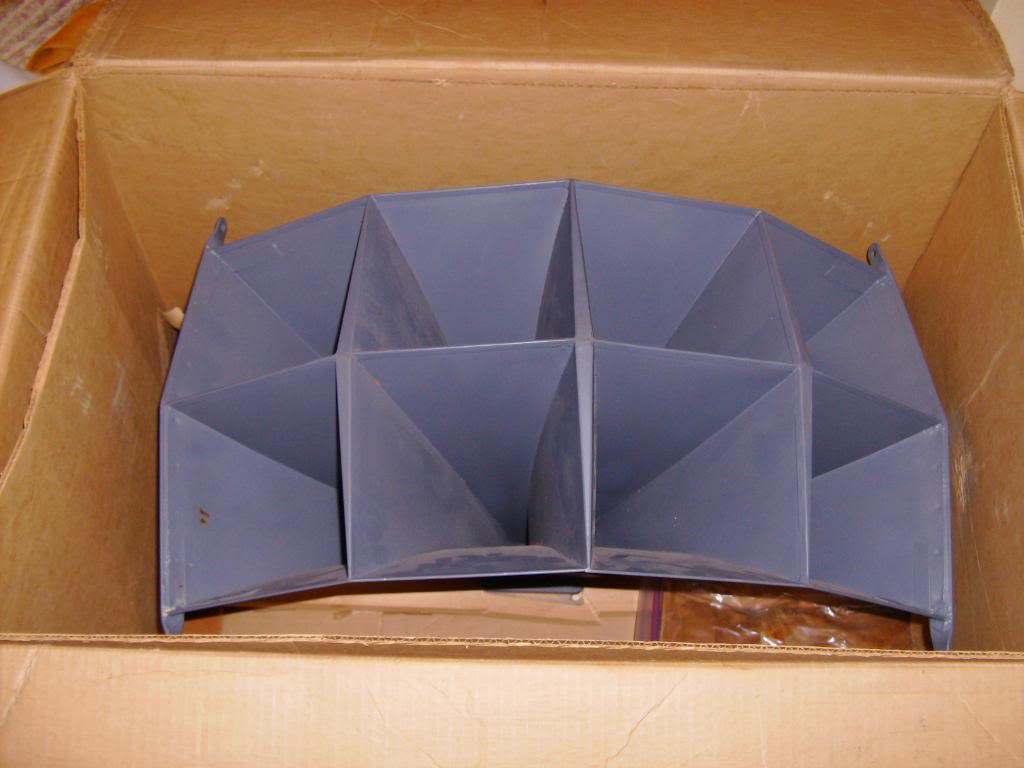

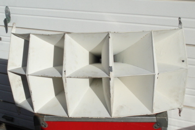

I have to think how to paint the multicells so Mrs JRKO is more approving 😀 Gonna be kind of white inside and natural cork outside
this is the only practical idea I can find - How to paint Multicell horns?
hmm, some surfaces will always look slightly scruffy, no matter what you do
maybe best the answer is the kind of 'structural paint' used for PA speakers
but probably best use it only on outher surface, and maybe mouth area
but if she is to the 'antique' look, there might some other options like maybe a stained copper look
leaf gold ? maybe you can get 'leaf copper' too
As the 'cells are mdf they should take ok. I kind of like the fill a cell with paint then open the bottom idea. I wonder about spraying them with a primer first?
So long as they look better than plain ole mdf its ok
natural cork is supposed to help with resonance of these non metal 'cell sets
