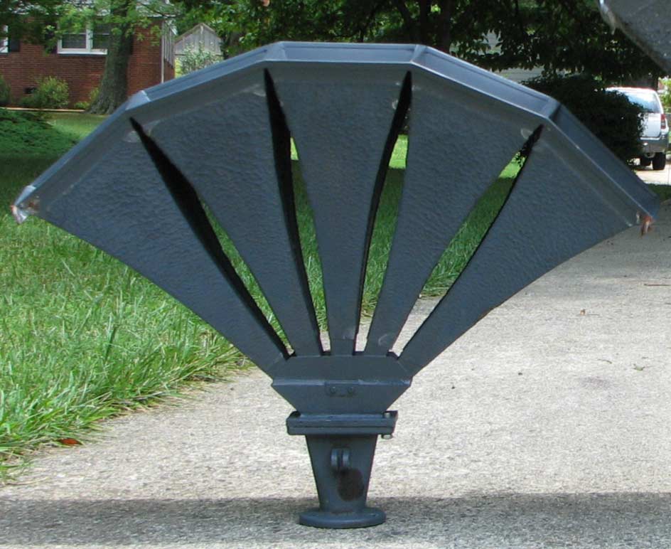

Dunno. Here is some eye candy. Dont kow how they sound, but they look wicked cool.

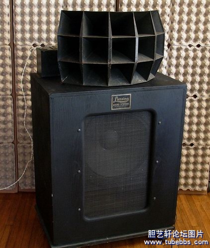

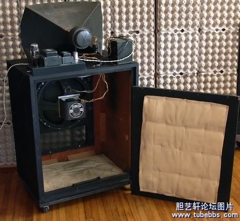

Weren't all multi's a 1.4"?
No, the Lansing 800 series [808 thru 1508] were all 1". Only the 808 is fairly well known though due to being part of the Lansing Iconic and later the original horn for the Altec 800 VOTT.
The once thought [by me anyway] just a catalog number 1508:
GM
This is just a wealth of info here. I've never seen an Altec 1" multi nor an Altec woofer with a return yoke on the Alnico. Mind you I've never seen a 614 cabinet in person either but at least I knew they existed.
