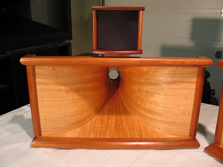

build a skeleton and clamp thin ply in multiple layers to it....or have a giant steam box and put normal play in and then bend it. I believe he used a circular rasp or sandpaper on a stick to shape the throat. JMLC says the throat is the most important part in terms o distortion caused by reflections.
Wow thats some construction there buzzforb. Maybe with the wacky board Charles Darwin just linked to, the hardest part (bending the wood) could be easy?

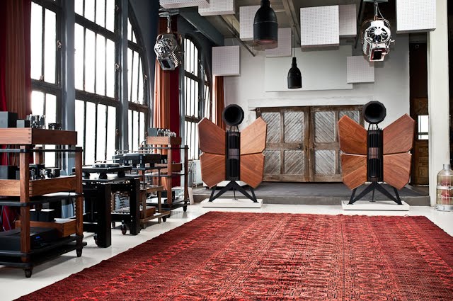

- And Now For Something REALLY BIG
