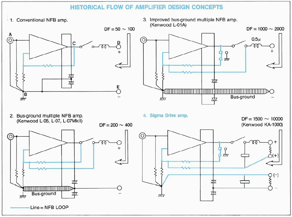

Just a side question, have you ever compared the Phillips MFB system to the Kenwood Sigma Servo system?
Not sure what systems you mean?
The old Philips used a cheap/early accelerometer and "modest" drivers and, at the time, seemed like a frustrating effort to get a "quart of soup from a pint bottle." But I have since learned to keep my biased opinion of accelerometers to myself since economic quality accelerometers seem to be showing up and, with MUCH engineering care, looking good.
The Kenwood system, if you are referring to the circuit on the fabulous old Basic series of amps, is very little different than the bridge method of feedback (if you think of the speaker wires as part of the bridge) which I always like. But I didn't think they thought in those terms ever. Actually, almost any amp can be readily re-configured into a "sigma" concept.
Ben
"Not sure what systems you mean?"
I mean has the group resurrecting the Phillips MFB servo compared it to the more modern Sigma Servo system and done listening comparisons...
Both systems have their merits and I was wondering if either was deemed "better". The Sigma Servo is certainly easier but doesn't include driver distortion in it's error correction such as the Phillips.
Sigma Servo is nothing but a classical global feedback for the amplifier.
Only with the possibilty to choose the point where feedback is sampled.
In other words ... Instead of sampling the output voltage only inside the amplifer, it allows to include the speaker cables into the FB-loop, thereby sampling at the speakers input also.
Onkyo featured similar with their Super Servo drive from Pre to Power Amp.
It might have been of some use with power amps that had to drive very low impedance speakers over long cables.
Most important difference to a MFB is that it does not include the speaker itself into the feedback loop.

The design is meant to be something like the remote-sensing feedback system used on lab power supplies - if that gives some context to some readers. It takes the feedback from the speaker terminals, downstream from the amp.
I think you'll find it can introduce some current feedback and therefore that it is as I described: bridge MFB circuit if you consider the speaker wires (and any added little resistance you need to introduce to get enough feedback) as part of the bridge.
Ben
For those unfamiliar with the Sigma circuit the attached pic will give you and idea of the progression of Kenwood's efforts to wrap more of the amplifier/speaker interface inside the feedback loop to maximize damping factor...which was a big buzz word back in the day. This configuration does not connect the speaker as one leg in a balanced AC bridge for distortion reduction.
