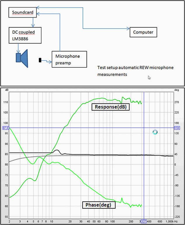

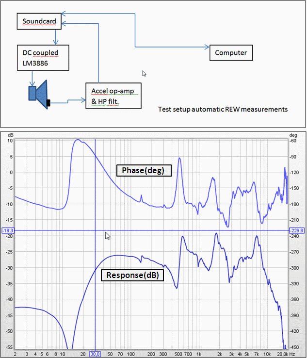

Take a look at the openloop measurements for the microphone (Attachment #1) and the accelerometer(Attachment #2). There is nothing in the signal chain besides the power amplifier, woofer, and mic or accelerometer. No feedback loop. The 13Hz issue is seen by the accelerometer but not the mic, so it has to be some type of cone motion that the accelerometer would pick up on, but that doesn't change the overall average motion of the cone so that the mic misses it. A rocking mode is the simplest explanation I could think of.

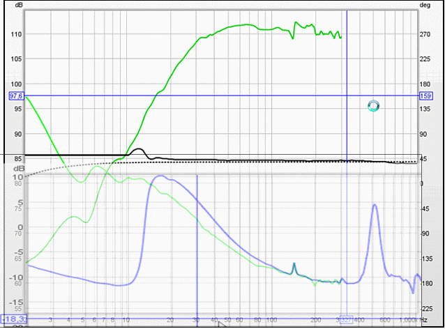

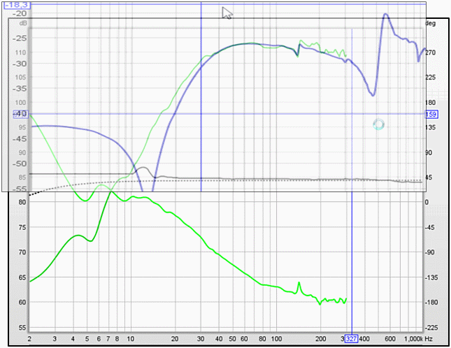

Attachments #3 & #4 are my attempt to overlay the response and phase between the two measurements to make the difference more apparent. A cone rocking mode would explain the cancellation at 13Hz and then the in-phase summation lower down in frequency for the accelerometer response compared to the expected -12dB/oct slope measured by the microphone.
Putting the twin-tee outside the loop removes this but doesn't address the problem of instability....Putting a twin-tee filter into a feedback loop may be OK for diagnosis but it does weird things to phase too...It would be good to see a check of feedback criteria, kind of Nyquist-lite just to examine gain and angle for the low freq region.
I Agree. That is why I recommended the additional openloop measurements with the notch filters to see exactly what they are doing to the loop response in terms of phase margin. It is difficult to solve stability problems looking only at the closed loop behavior.
Bolserst - I appreciate your explanations (and no doubt, Armand even more so).
Why is there a hole in the accelerometer response at 13 Hz? Is that with the twin-tee filter in place?
No. The response has no notch filter, only the power amp and woofer as shown in the diagrams.
The "hole" in the response is due to the rocking mode...at least all indications are pointing that way.
The rocking mode can be thought of as the mechanical analog of a vented box.
At port resonance in a vented enclosure the port is 180 degrees out of phase with the cone and if you have ever seen response plots showing separate piston and port outputs you will notice the cone output going to a minimum right where the resonant output of the port is at its maximum.
The rocking mode is similar in nature, being driven by the motion of the cone. At resonance the cone rocking motion is at a maximum and the side of the cone where the accelerometer is mounted is moving 180 degrees out of phase to the motion of the voice coil, hence the notch in the accelerometer measured cone response as the two motions are tending to cancel out.

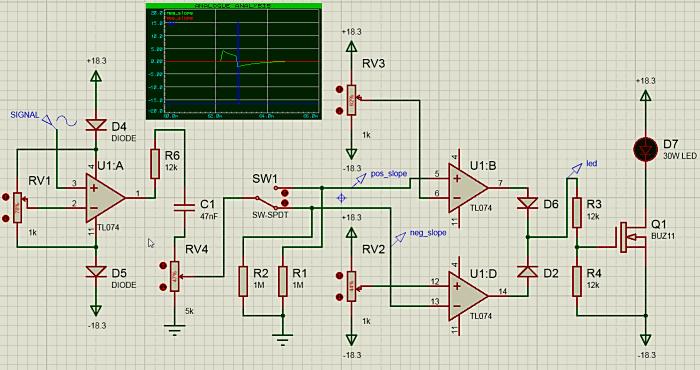

While going to sleep yesterday I must have been inspired by the meteor storm and designed a stroboscope in my head. Now it is up and running and working really good but I need some tip on how to use it.
The strobe lamp is a 30W LED controlled as in the schematic attached.
As input signal I can an external wave generator or use the woofer signal. I have a switch that switches between trigging on positive or negative slope. I can also adjust where on the sinus curve I want to trig the flash.
When using an external signal generator I can make the woofer look like it is standstill in any position, or make it look like it is slowly moving in or out by slightly ingreas or decrease the frequency on the signal gererator.
When driving the stroboscope from the woofer signal it always appear as if it isn't moving and I have the option to adjust the trigger so I can make it "stand still" is any position.
I'ts really fascinating to look at but I have not been able to indentify any rocking. Do you have any suggestions?
