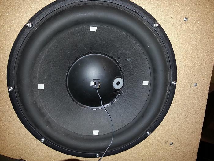

Strobo test

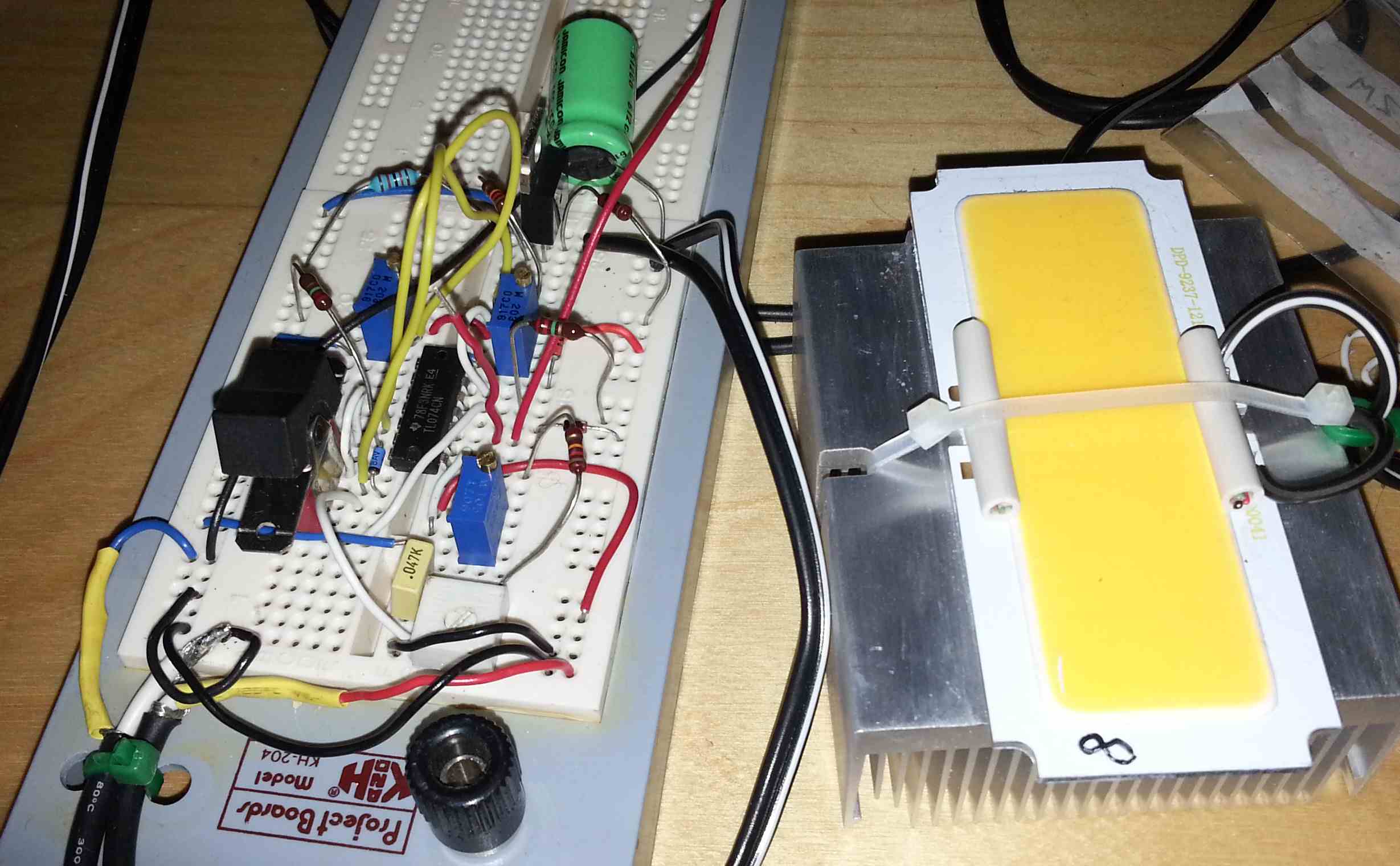

The sun has finally gone down and it is totally dark in my basement. Time to put the stroboscope to work.
I must say I am amazed at how good this works! The woofer looks like it is 100% standstill even when it is moving 1" in and out. Carefully moving my finger towards the cone suddenly hits me with its truly invisible "macic field". :D
I have been using stroboscope before on my car so this is not new to me. But I had not anticipated that this LED mockup would work so good.
The LED I am using is a 720mA 36V 2000lm COB LED:
30W 720mA Strip Bar COB SMD LED Light Lamp 36-45V 2000lm-Warm White $19.67 Free Shipping @GoodLuckBuy.com

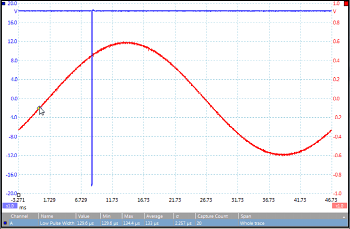

At 36.6V the current is about 700mA so I dont need a series resistor or a current regulator.
I can adjust the strobe pulse from 1.5ms down to about 100us if it is dark in the room. At 300us it's OK with normal room lighting. At 1.5ms the light output is really powerful but I loose a little focus if the cone is in the middle (at maximum speed)
I learned today that rise and fall time of LED are actually in the ns range. Is LED superior to strobe light?
What is the flash duration of a old fashioned stroboscope? I could not find any info on the net.
Anyway. I was not able to identify any rocking or movement at all.
* I have tried frequencies from 10Hz to 30Hz.
* Different pulse witdh for more or less light.
* I have tried with the flash triggering when the cone is at different positions of the curve.
* I have tried Ben's suggestion with external trigger slightly off woofer frequency. I could clearly see the slow motion of the cone but nothing unusual.
But then again, my loop gain is high and just the smallest (not visible to my eye) amount of in-phase 13Hz will be amplified and sent back in phase.

I am going to make a PCB for this and put it in a nice box. :hbeat:

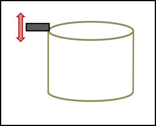

Looking back at your mounting method shown in post#1, is there any chance the accelerometer is vibrating like a cantilever beam? Perhaps with the woofer removed from its enclosure you could try the slow sweeps around 13Hz with the strobe synced to the drive signal to freeze the up and down motion and illuminate the accelerometer from under the basket to see if it is bending up and down relative to the voice coil reference position.
The 13Hz hunt
Todays test.
1. Add a second accelerometer to the center of the dust cap
2. Add a second accelerometer off-center (over the internal one)
3. Add 5 grams off center

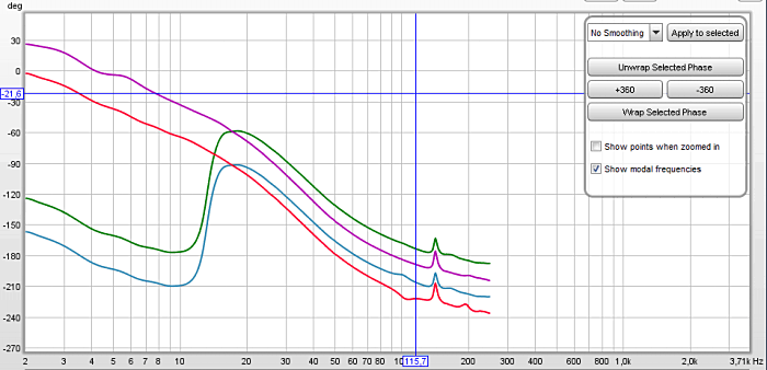

Results:
1. Measuring the new centre mounted accelerometer, the phase follows a second order filter. No 13Hz anomaly. (same as with microphone)
2. Measuring the off-centre mounted accelerometer, the phase also follows a second order filter and is the same as in test 1.
3. Measuring with the internal accel with added mass gives no change.
Phase plot.
Green = Internal accelerometer
Purple= New centre mounted accel
Blue = added off-centre mass (5g) measured with internal acc.
Red = New accel mounted above the internal one
The purple, blue and red plot have been offset for readability.
Picture of woofer in test 1 and 3
Picture of woofer in test 2
Conclusion
Test 1. No surprises here. the microphone measurement had already proved this
Test 2. Adding a second accelerometer on the cone just over the internal one should give same results as the internal one but its not. This supports bolserst suggestion of the cantilever beam theory.
Test 3. Adding off centre mass has no effect. This also supports bolserst suggestion of the cantilever beam theory.
Now its time to take out the woofer and have a look at the internal accelerometer with the stroboscope

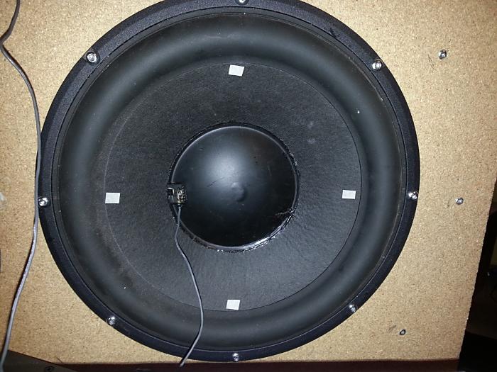

I was not able to see any movement of the accelerometer with the stroboscope. :(
I tried 6Hz 10Hz, 12Hz, 13Hz, 15 Hz 27Hz and 30Hz. I tried locking the trigger to top, middle and top position of the cone.
But then again, would not the accelerometer always be in it's same position at the same point on each wave??

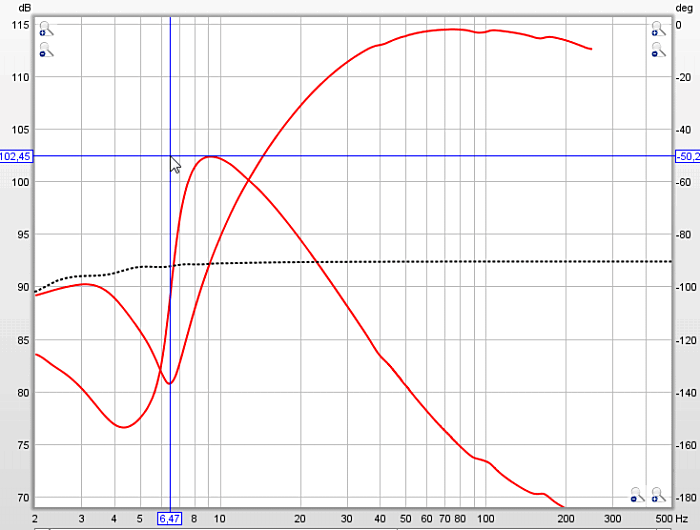

I made a sweep from 10 to 16 and back to 10 Hz with a total duration of 2 seconds that was played on loop. The cone appearead to move slowly up and down but the accelerometer followed nicely without any visible anomalies.
One interesting thing I noteced was that the 13Hz anomaly now had moved down to 6,5Hz. Why is that?? It must rule out that the problem is the cable connected to the woofer, right? The cable is also glued to the cone several mm after leaving the accelerometer.
This is measured with the internal accelerometer with woofer in free air. The high pass filter of the accel opamp is included in this response
13Hz in the cabinet, 6,5Hz in free air...hmmmm...
Assuming this is not a one time event, and you can repeat results of 13hz when woofer is returned to its cabint, it appears that whatever the resonance mode is, it is responding to increased stiffness from the air spring acting on the woofer cone.
I tried 6Hz 10Hz, 12Hz, 13Hz, 15 Hz 27Hz and 30Hz. I tried locking the trigger to top, middle and top position of the cone. But then again, would not the accelerometer always be in it's same position at the same point on each wave??
"If" there is a cantilever resonance:
The accelerometer position relative to the lower surface of the cone would change.
Since the free air resonance is 6.5hz you would want to look just above and just below that frequency where the motion relative to the cone would be greatest.
Just above resonance at say 8 Hz the motion would be 180 degrees out of phase with the cone. So as you moved the trigger from the middle cone position to the top position you would see the separation distance between the bottom surface of the cone and accelerometer increase, and as you moved toward the bottom position the separation should decrease. Just below resonance at perhaps 5 Hz you would see the opposite trend since the cantilever vibration would be in phase with the cone motion.
(let me know if the words don't make sense, and I can try and put together some drawings)
