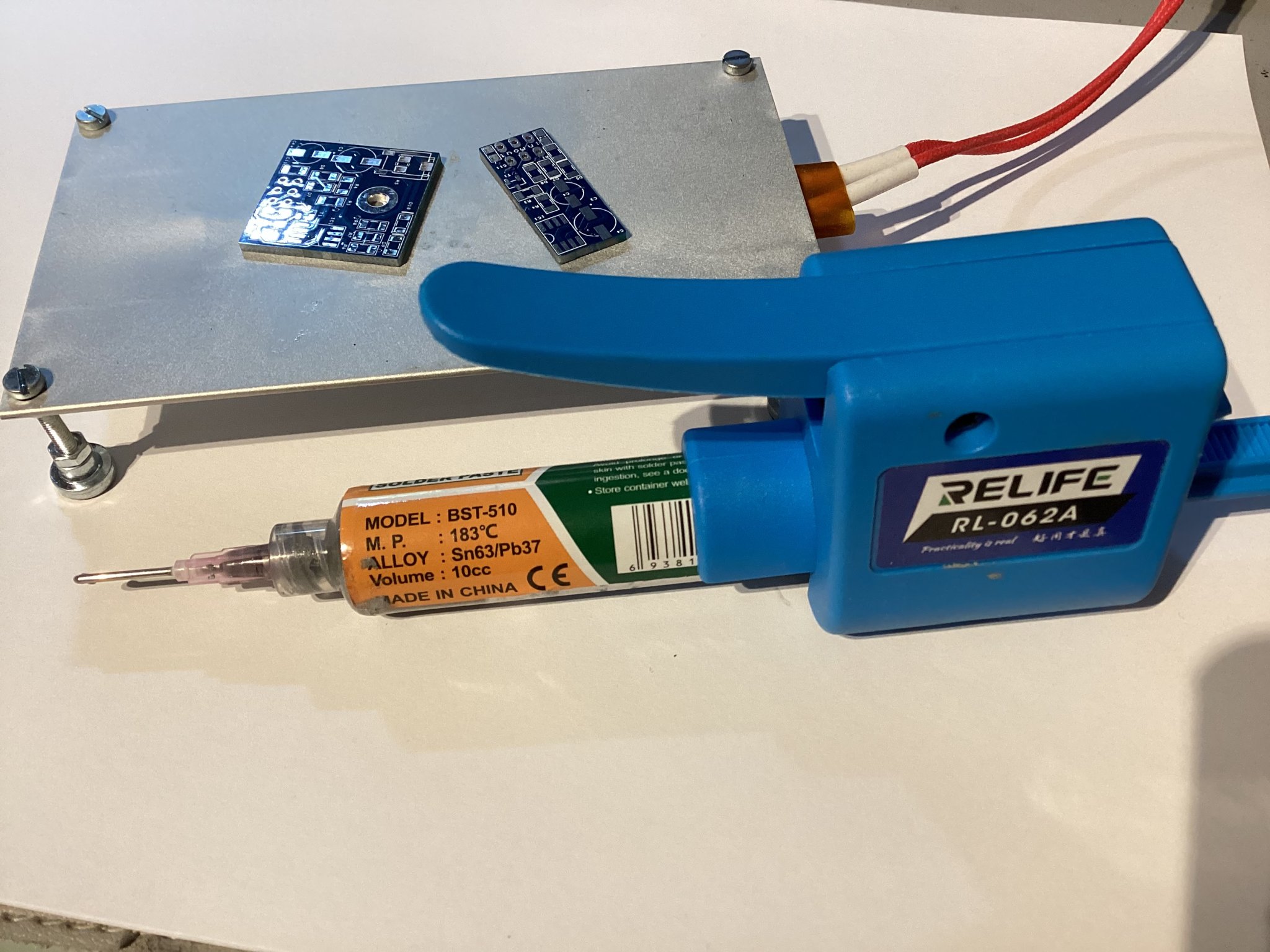

Thanks, no problems with the MELF resistors but you can also use other packages as you stated.
They stick nice in the solderpaste.
From aliexpress Best BST-510 just a view euro.
I do not use the needle. Just apply a big drop on a piece of paper and then apply the paste with the point of a pointed tweezer.

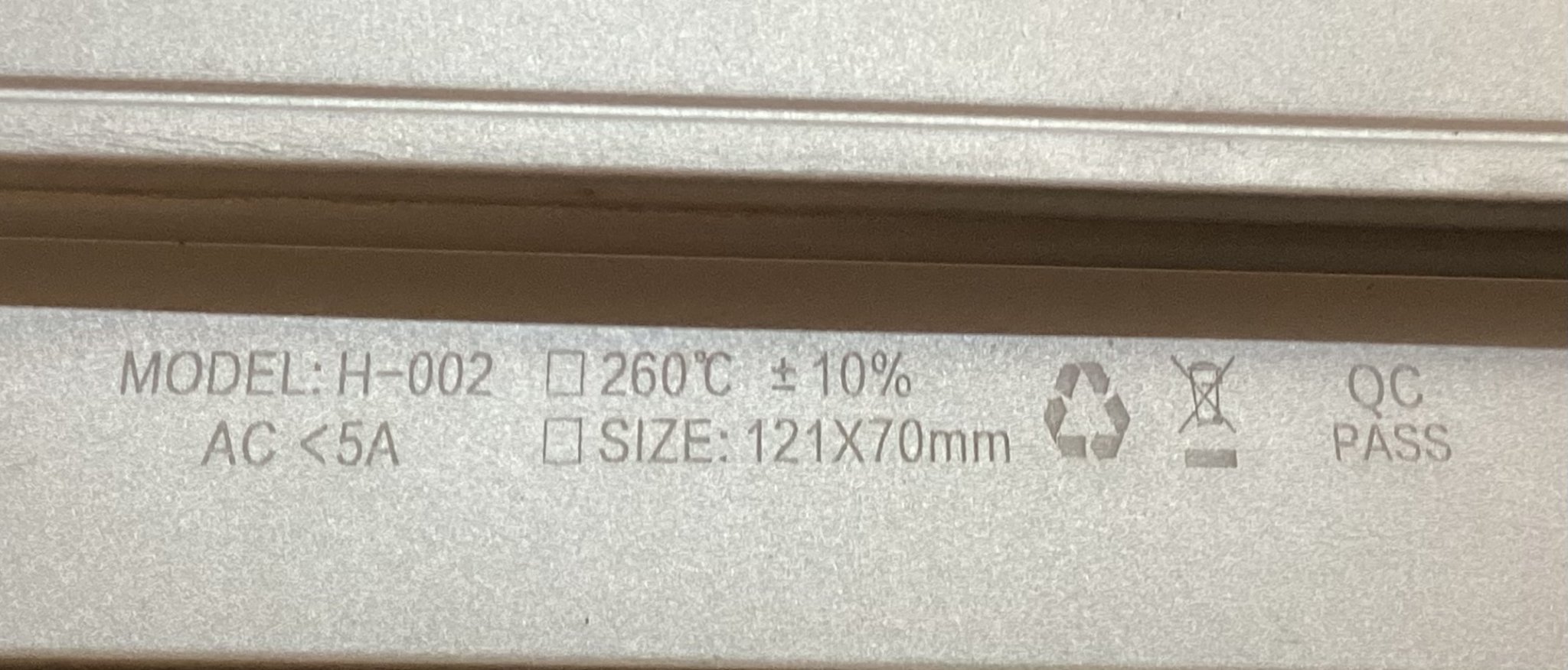

Sorry for OT, but can you tell us more about your hot plate ? is it DIY ?, is there a temperature regulation ? I only see two wires.
I use the same method as yours : applying the paste and removing surplus with screwdriver and tweezer.
I found this solder paste not so good : it produces more flux residue than the one I was previously using (Chipquick) but was more expensive; and the board may remain sticking after IPA cleaning.
Just from aliexpress, no regulation. 600W.
https://nl.aliexpress.com/item/1005..._main.155.2f1979d2Bw4csP&gatewayAdapt=glo2nld

Ok, thanks, I found one, very cheap ! https://fr.aliexpress.com/item/1005...89225063982e6238!12000035455141608!rec!FR!!AB
I'll try one.
I'll try one.
This one I have. 600W heating power.
https://fr.aliexpress.com/item/1005...386e1739!12000029383180402!rec!NL!3320251976!

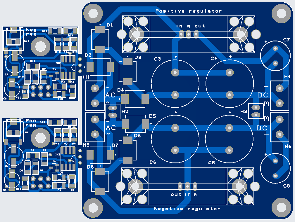

After ordering the mainboard at JLCPCB, I had to pay extra money because of the two attached regulator PCB's.
Now I have connected the regulator PCB's with some traces to the mainboard and no extra payment is ask.
Updated the gerber file.
I am lucky to have slipped through without being asked to pay more.After ordering the mainboard at JLCPCB, I had to pay extra money because of the two attached regulator PCB's.
