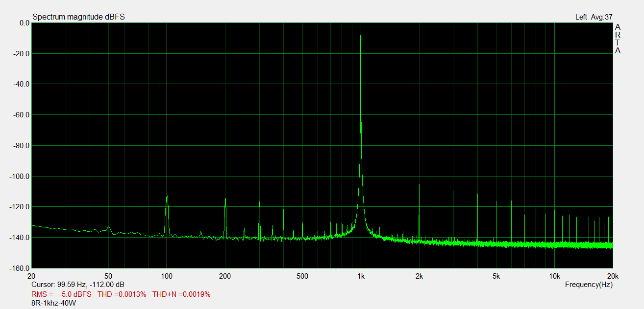

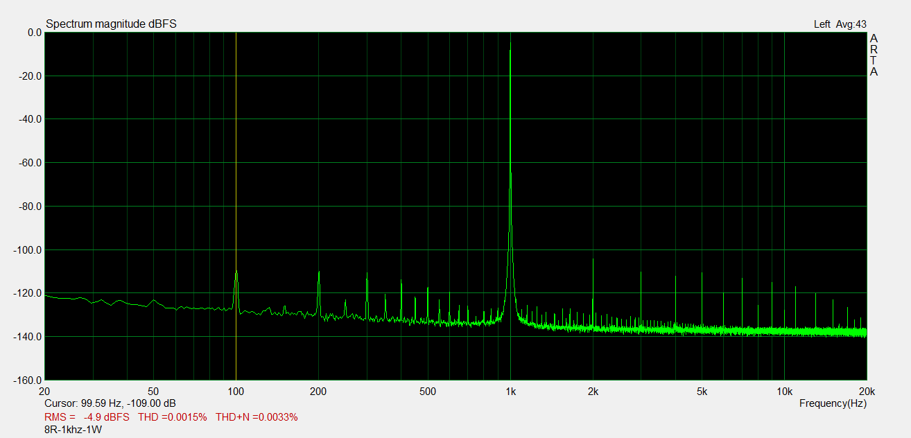

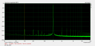

Ok, I've pretty much fixed my test setup (by cutting the gnd plane in my test load). Since it has become insensitive to the connection of the scope, groundloop should be over. Very marginal improvements though. Nicer graphs as I took the time to do some linear averaging. 😎
So 1W becomes 0.0033% thd+n (down from 37) and 40W becomes 0.0019% (down from 24).

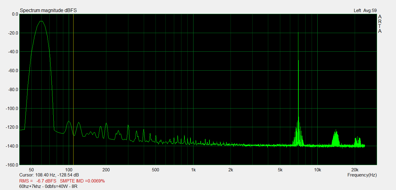

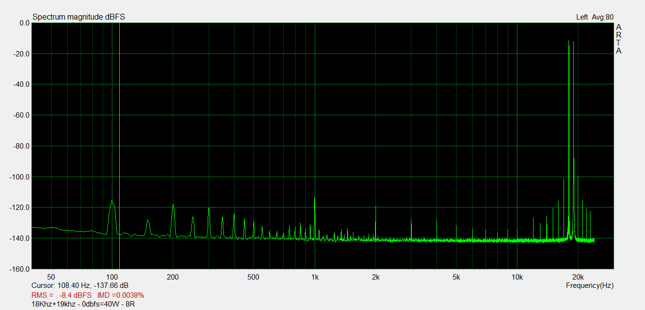

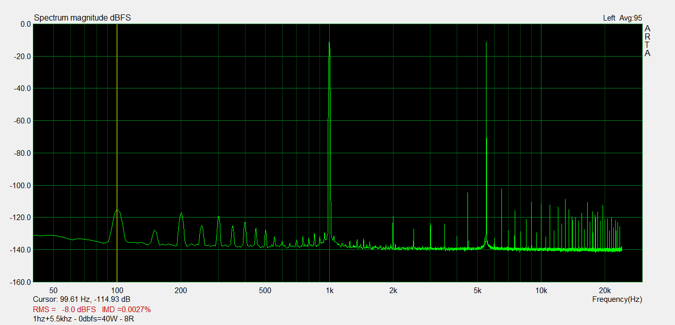

How about IMD? 60 Hz + 7 kHz; 18 kHz + 19 kHz; 1 kHz + 5.5 kHz, for example?
THD+N vs frequency would be interesting as well. At least spot measurements at 100, 200, 500, 1000, 2000, 5000, 10000, 20000 Hz combined into a graph.
You have a lot of ripple in your setup as indicated by the 100 Hz (and harmonics). Any plans for improving that?

I re-ran the tests. I checked first at 1khz (1W and 40W) to see if everything was still fine. No changes.
So here are attached the two-tones tests. 60+7000hz (4:1) and 1Khz+5.5Khz and 18Khz+10Khz (both 1:1). I've ran them just after running the 40W test, so -5dbfs would be 40W (they're incorrectly labelled as 0dbfs=40W, sorry). The tests were ran at 48khz sampling.
I also re-ran some thd+n measurements vs frequency, at 40W. My problem is that the 18i8 distorts a lot more at 88.2Khz (or 96khz) than at 44.1khz. At 192khz, it's completely useless. On the other hand, 44.1Khz won't get me many harmonics. So my measurements setup is clearly showing its limits here. I overlapped the ranges to give an idea though.
@44.1khz
100hz : 0.0018%
200hz : 0.0016%
500hz : 0.0017%
1khz : 0.0019%
2khz : 0.0023%
5khz : 0.0034%
@88.2khz
1khz : 0.0055%
2khz : 0.0056%
5khz : 0.0063%
10khz : 0.0070%
20khz : 0.0068%
You're right, the 100hz ripple and associated noise is higher under 1Khz than I'd like. The "hash" above 1khz is in line with your spectrum for the lm3886DR though. I've yet to find the cause of that. 😱

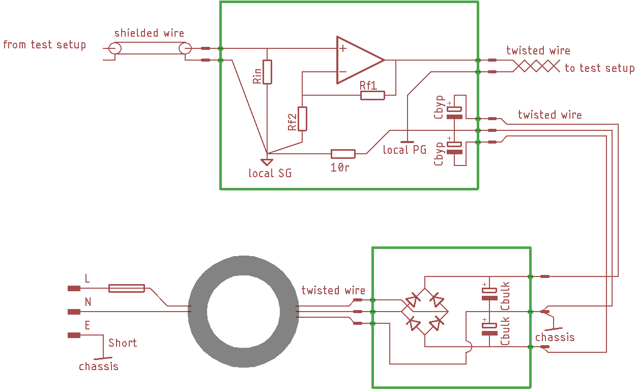

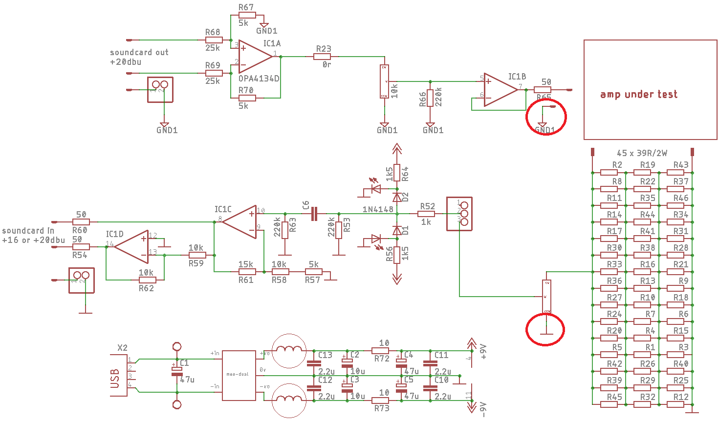

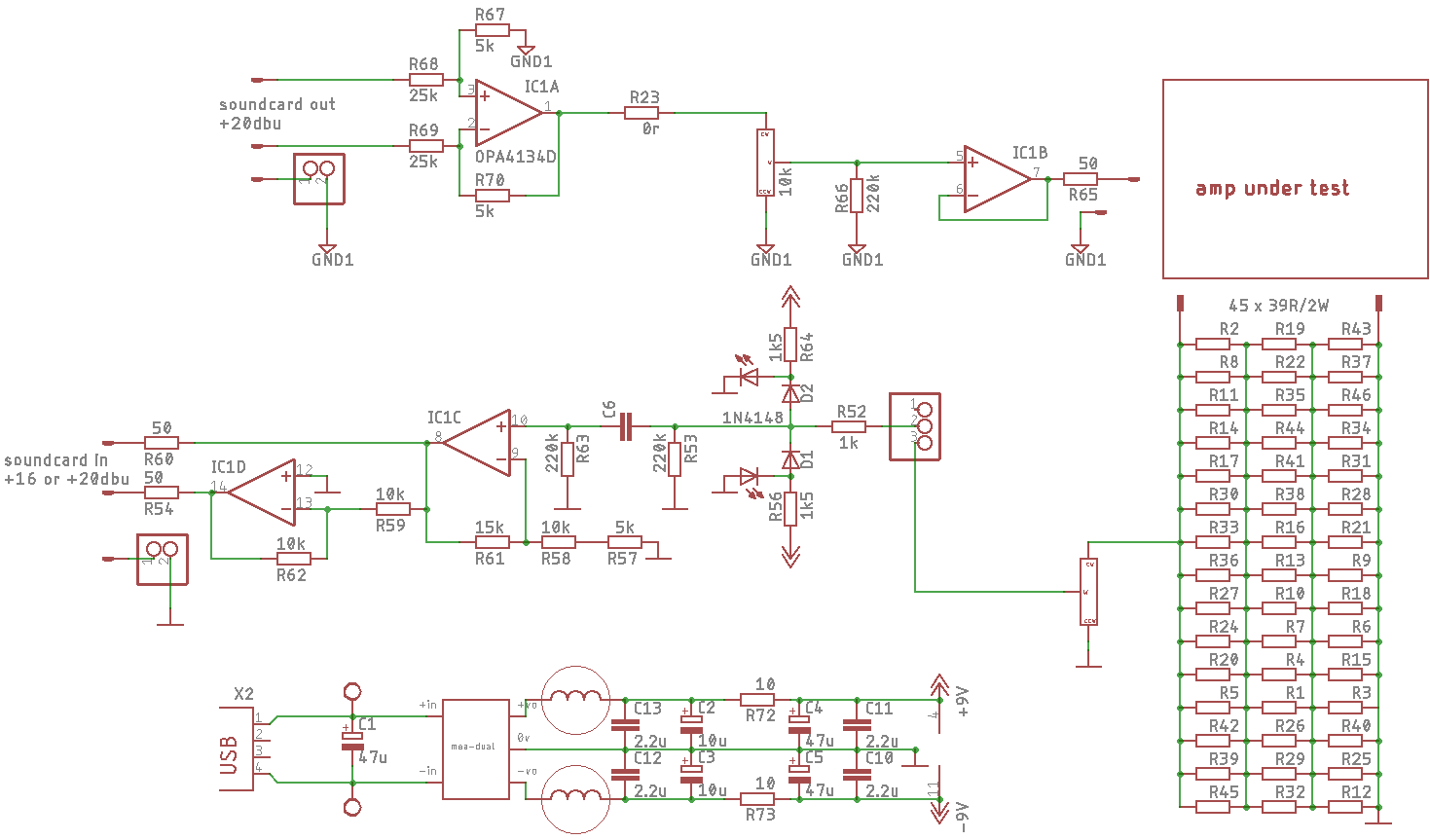

I attach the schematic of the test setup. The dc-dc converter is isolated btw. In loopback there isn't any problem. There are two jumpers to tie the shield from the balanced cables coming from/going to the soundcard. If it let them both open, 50hz pick up increase a bit but nothing changes for 100hz. Having either a 1k resistor or a 0R jumper at the jumper for the cable going to the soundcard input fixes the 50hz.
I also attach a diagram of the amp setup, with only one channel wired up. Shorting the HBR doesn't do anything nor does removing the link from the power ground to chassis, nor does moving the speaker return to the PS.

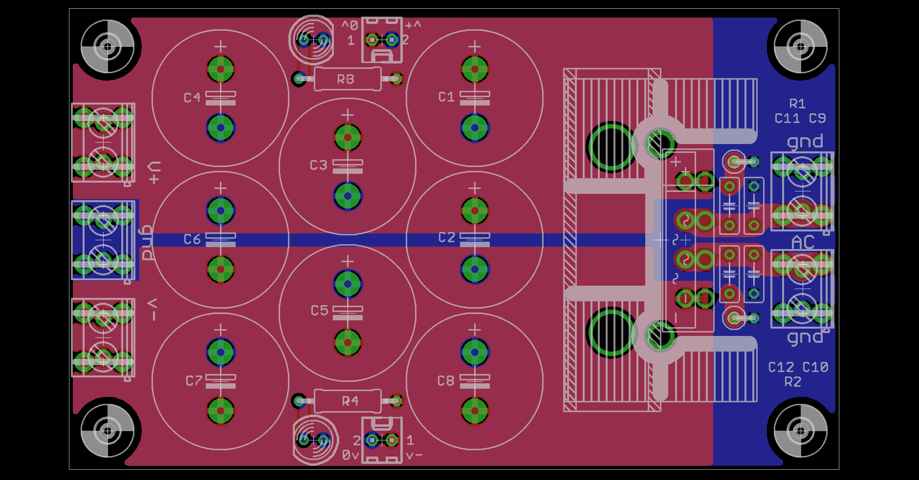

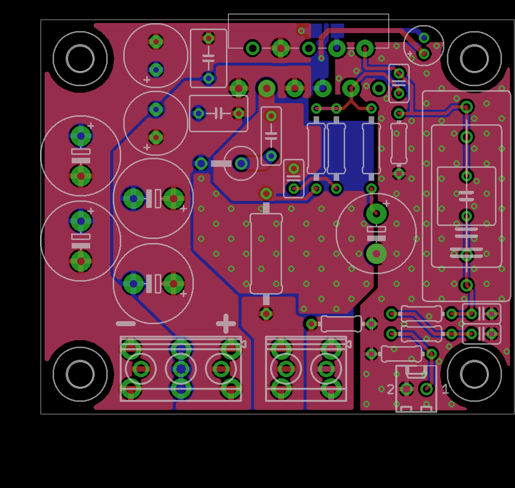

Finally, I attach the layout of the PS and amp.
Any suggestions on what to try ? I don't have a regulated bench supply at hand right now. 🙁
