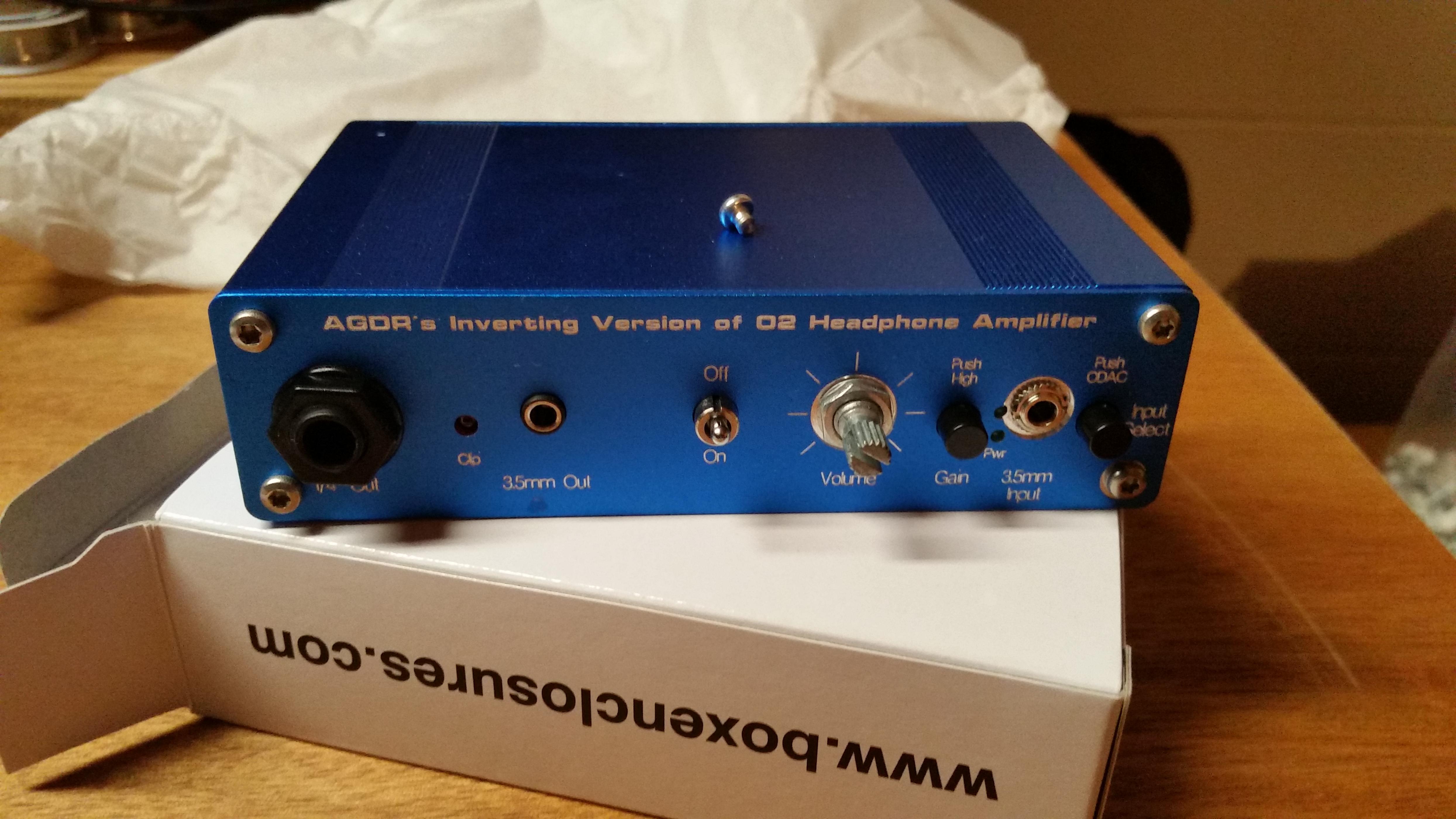

You can save some more if you leave out the infilling. Depending in the color choosen it may or may not look good to you? Mine is Blue and the engraving being raw aluminum looks really nice.
The back is easy to do.....I took some paint and put it on the power connector slid it into the case with the back panel screwed on and it leaves a nice mark where to drill, cut, nibble, file the square hole.

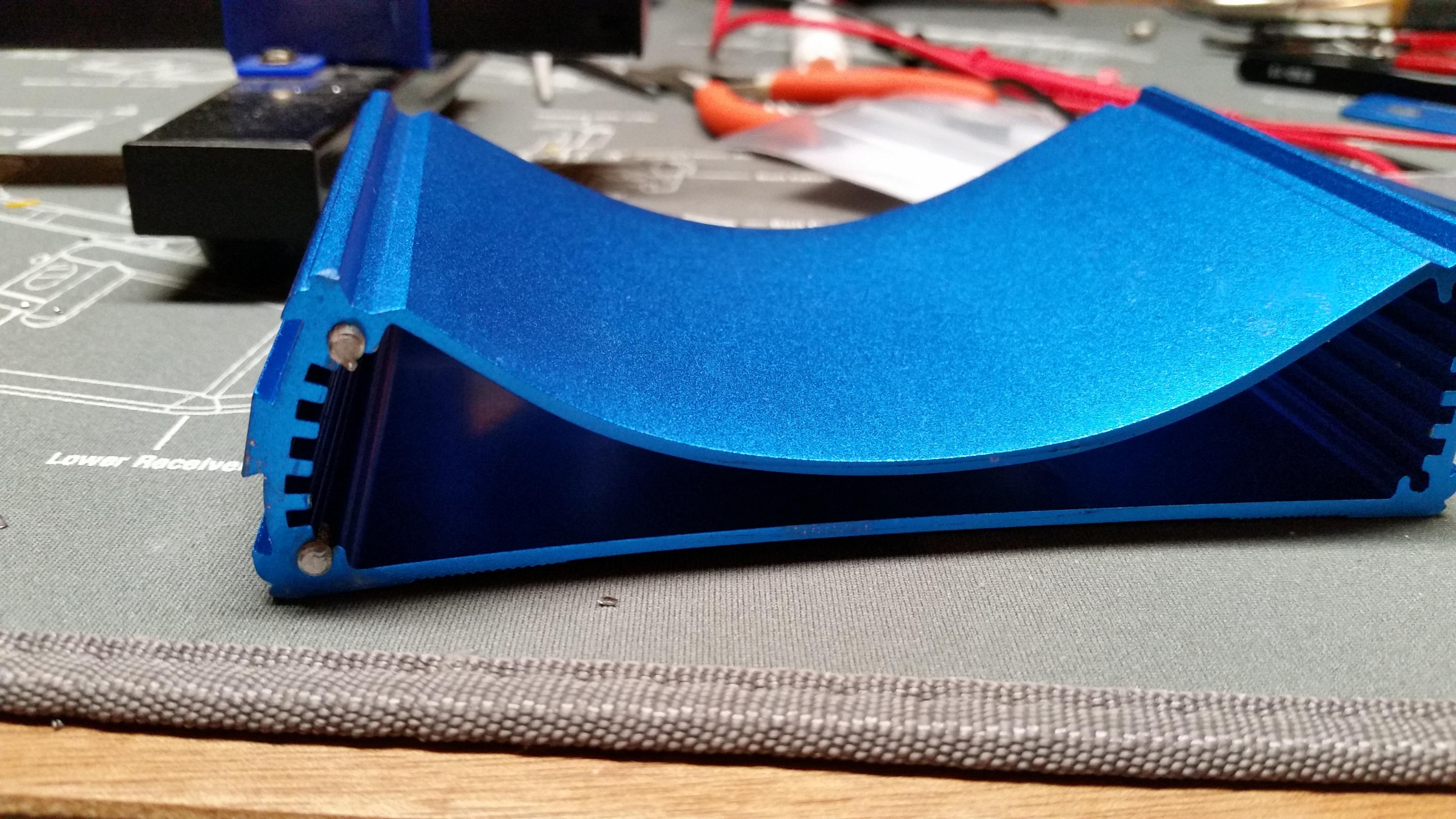

Well...I just killed my back panel.... going to have to buy another enclosure just to get another panel and send off to FPE. Instead of saving $30, I just cost myself an extra $20 😡
My square hole ended up not so square, and then i managed to put my 2 heat sink holes about 3mm to the right of where they should be... I just give up...should have never even started the heat sink holes after my power connection hole was so horrible.
One of my favorite quotes: "Man's got to know his limitations" and I certainly didn't.

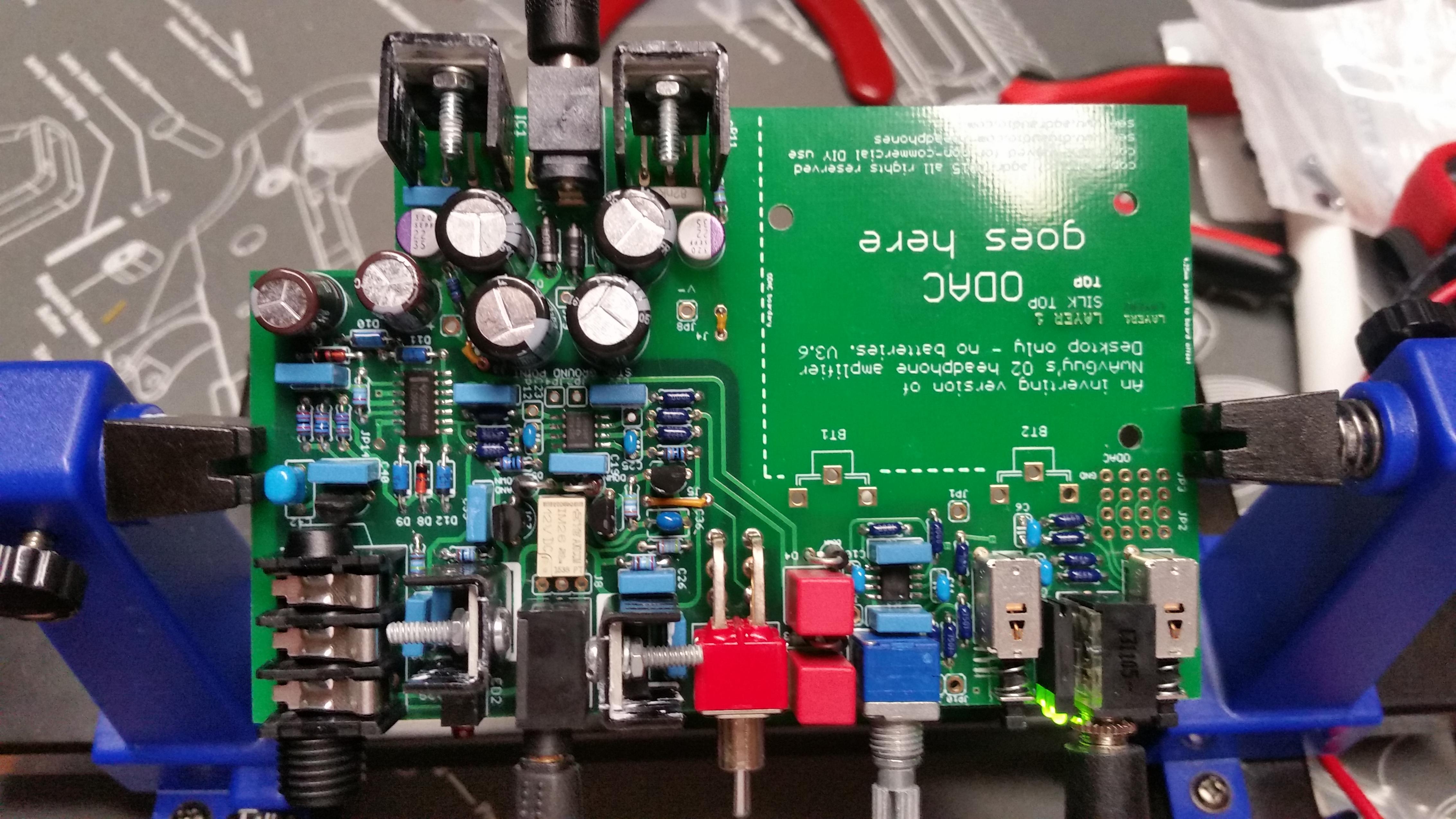

Enough bad news on my progress, now some good: it works and sounds good on my crappy test headphones.
My DMM can only read as low as 0.1 mV and both channels have 0.0 mV of DC output 😀 so that's pretty awesome! I had to adjust trimmer resistors to get that on my ODA. Also voltages held steady with the jumpers in-place, +15.34 and -15.30 VDC. The only "unusual" behavior I notice is that the clipping indicator flashes really quickly during both turn on and turn off. Not a problem exactly, but is this normal?

Oh, and here's a photo of the amp with all the parts soldered on and running.

Received my panels from FPE yesterday and they look great!
But now I have to buy my 3rd case for this amp 😡

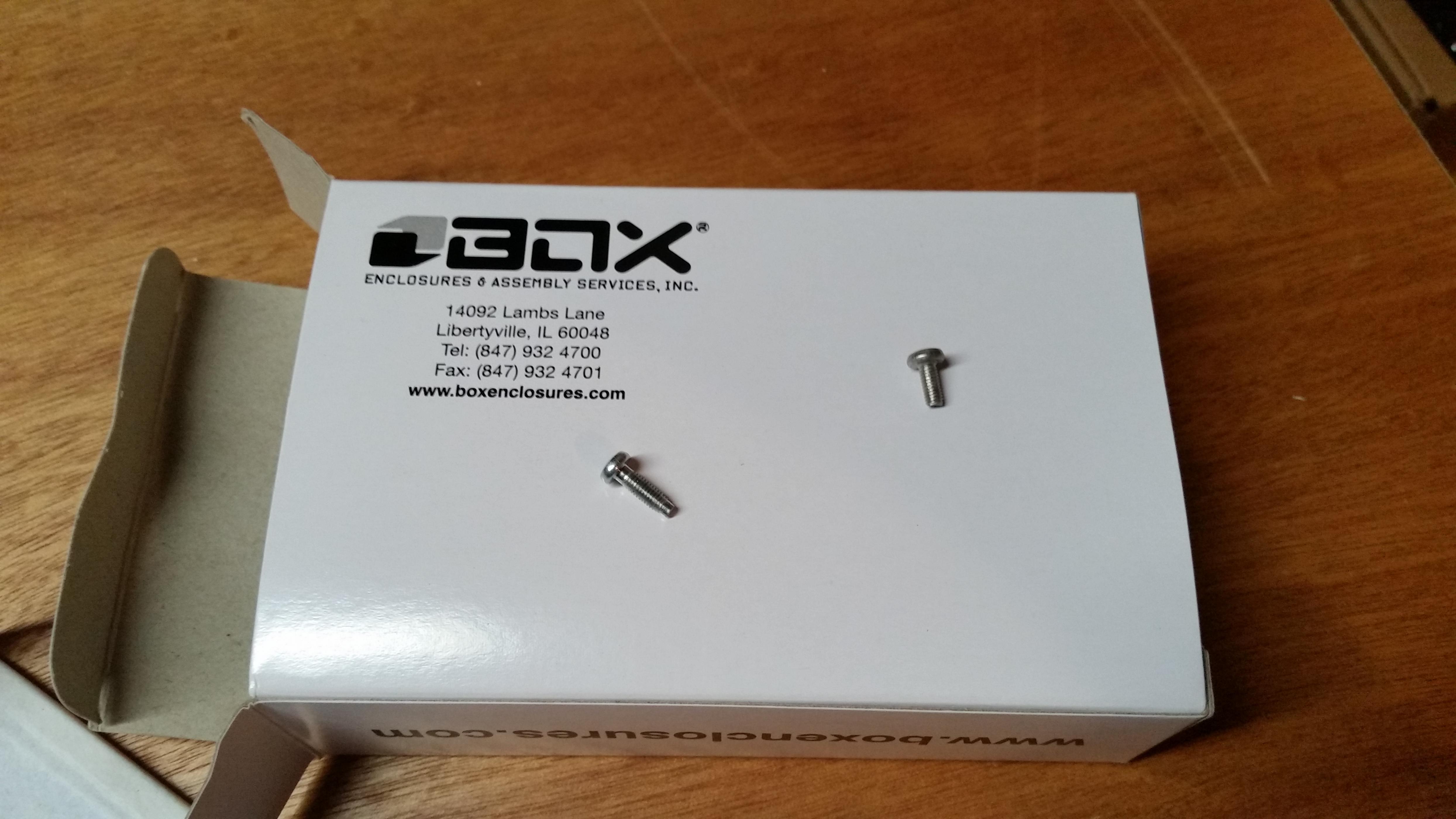

Anyways, I got my inverting O2 amp assembled with new screws that don't break when making the threads in the enclosure. After contacting box enclosures (the company the makes the enclosure for this build), they admitted to having several complaints about the screws that come with the unit. They shipped me 2 new enclosures since this was the 2nd time that I had screws break off in the enclosure before tightening on the front and back plates.
The company says that they have fixed the problem and now include screws that are not only shorter, but smaller in shaft diameter. (I took a pic of the new vs old). And since I had a backup enclosure because they sent 2, I tried the ones that came with the enclosure before using the super tough ones that agdr sent me. If the new version screws failed, I would have used the agdr set which I have 0 doubt that they would fail. But since the included screws worked with no issues, I think it is safe to say that anyone buying an enclosure in the future will not have this problem.
