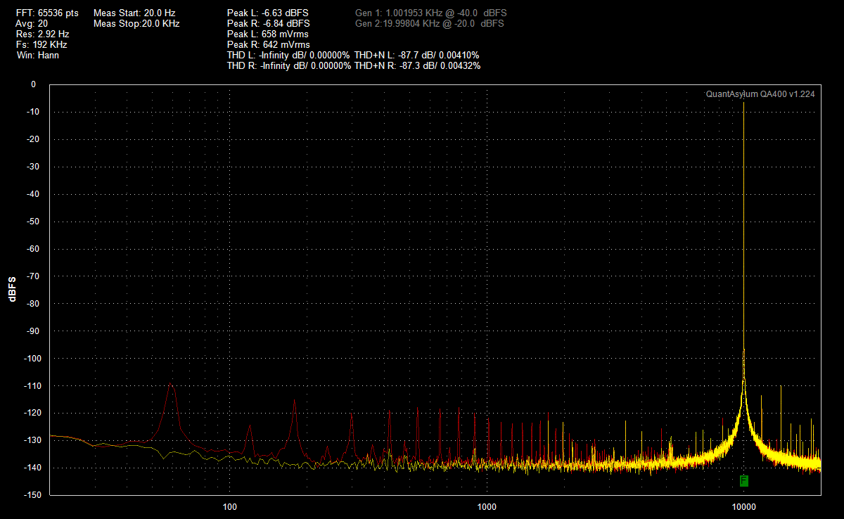

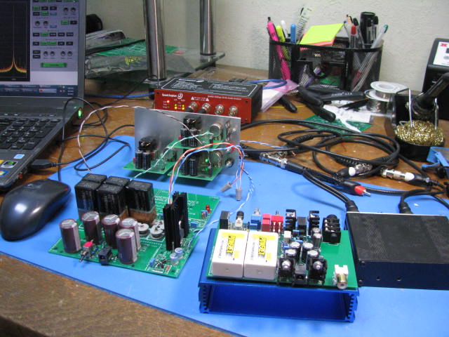

* The first plot below shows a 10KHz test signal into the inverting version of the O2. The even harmonics at 240Hz (4th), 360Hz (6th), and 480Hz (8th) are gone but the noise floor is about 10dB higher than the stock O2 below.

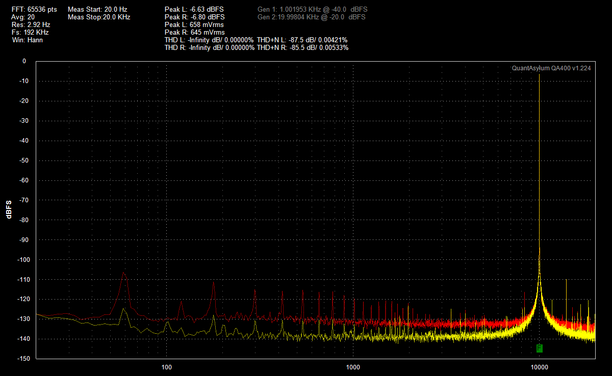

* The second plot shows a 10KHz test signal into a standard O2 headamp. This one is built up exactly from NwAvGuy's BOM, no modifications or part substitutions of any kind. It is running on batteries for this test with no AC adaptor plugged in.

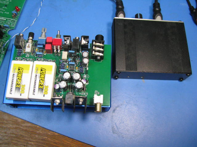

* The first photo shows the test setup. Signal generator output (one of Victor's low THD oscillators) BNC T'ed into a QA400 tester and then into one channel the DUT's input, either an O2 or the inverting O2 here.
* The second photos shows the two O2s. The inverting version is about an inch wider than the standard O2. Fits into the blue B5-080 case. The black one is the standard O2 in a B2-080 case.

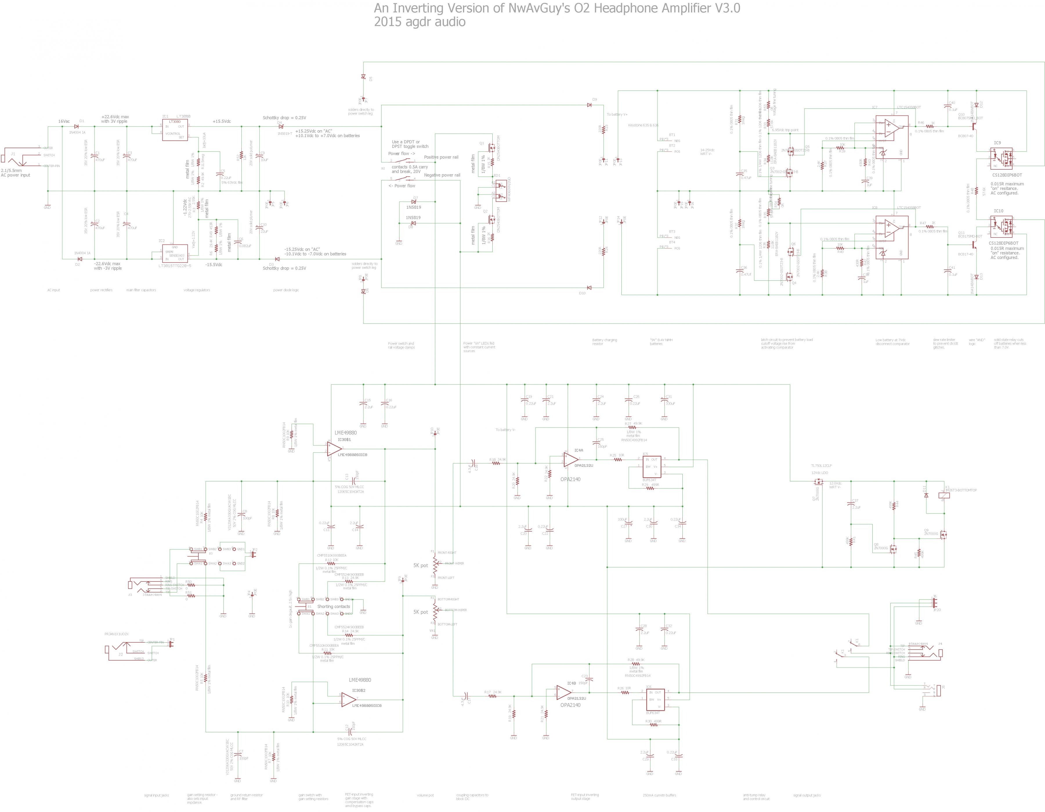

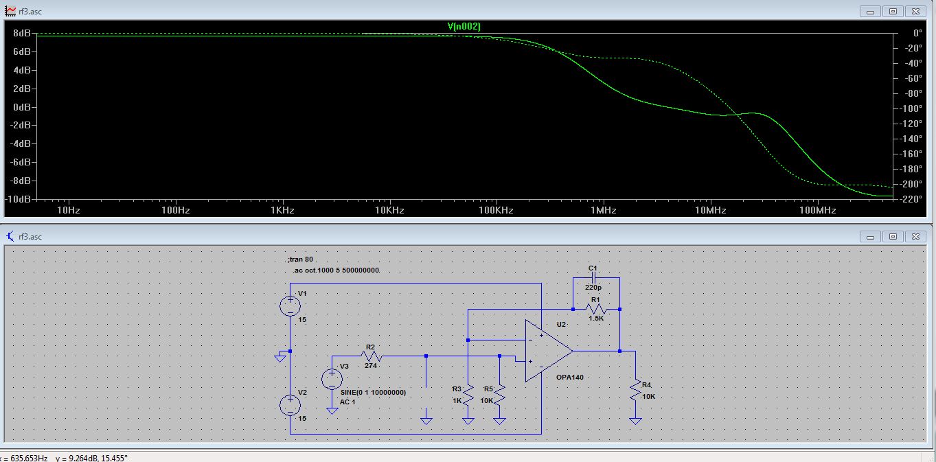

Hmmm - after thinking about what I just wrote above about the 10K resistors from the inverting inputs to ground, that isn't correct. The op-amp (inverting) input bias current will still flow through the feedback resistor if there is no input. In fact, with no input, the inverting stage turns into a unity gain buffer with the input grounded.
So those 10K resistors to ground I have on the various inverting inputs are doing absolutely nothing and can be eliminated. Good, that is 4 less parts. :)
Oops - RF filter

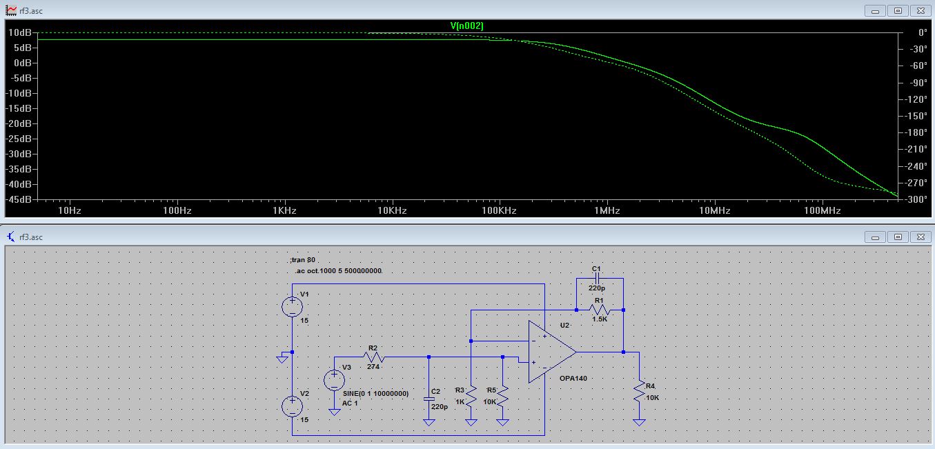

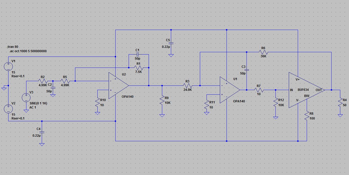

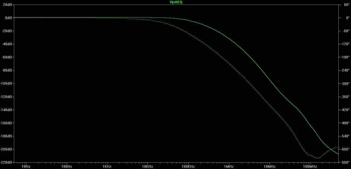

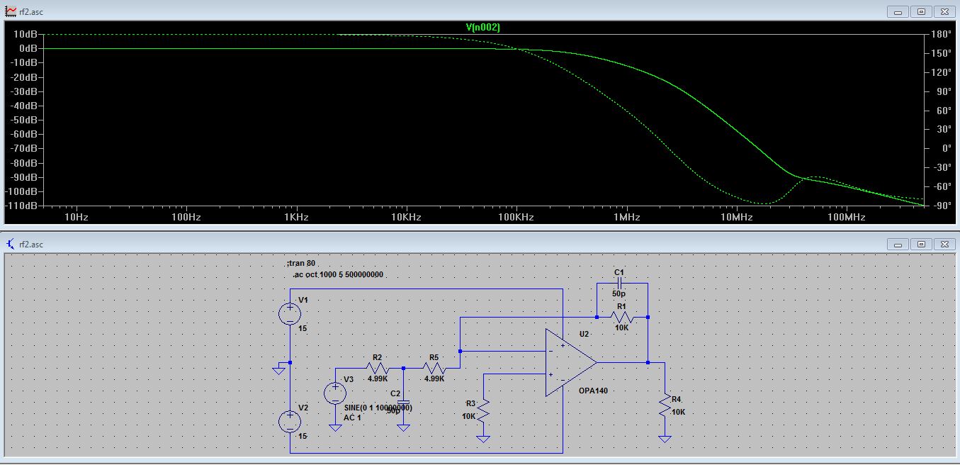

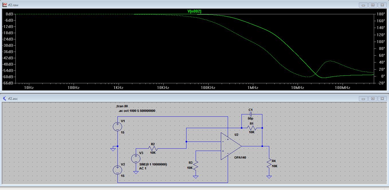

I've just realized that the input RF filters in this amp will suffer the same fate as the 10K resistors to ground on the inverting input in the post above. Things are a bit different with inverting amps. :)
The simple fix is to split the input 10K resistor into two 4.99K resistors with the RF filter capacitor between them, rather than at the inverting op amp input. The corner frequency winds up around 640KHz, vs. the 2.6MHz corner with the O2's RF filter.

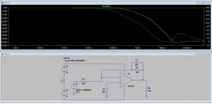

I've used the OPA140 in the sims below since I've yet to find a LME49880 Spice model.
* The first plot is the result of an inverting -1 unity gain stage just with the low pass filter formed by the cap across the feedback resistor. Does a reasonable job through the 11MHz bandwidth of the op-amp, but the maximum rejection is around 60dB.
* The second plot is with the RF filter. The RF rejection now continues past the op-amp's bandwidth and is deeper.
* The last two plots are of the O2 headamp's non-inverting stage and RF filter. Note that unlike the inverting amp, without the RF filter cap the amount of RF rejection in the non-inverting amp is miniscule.
Maybe not! I know that resistor is usually added to reduce output offset caused by the input bias current going through the input resistances. But in this case that issue doesn't matter due to the cap coupling after the first stage, plus the op-amps are FET input with nearly zero bias current.
I added the resistor thinking it may help with common mode rejection, having the impedances looking out the two op amp inputs similar. But you are quite right, the noise penalty in adding those resistors probably outwieghs any benefit. I will probably eliminate them.
Thanks for the suggestion! That eliminates four more parts from the board. :)

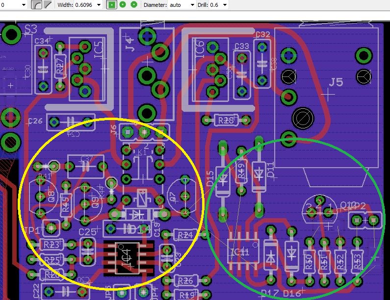

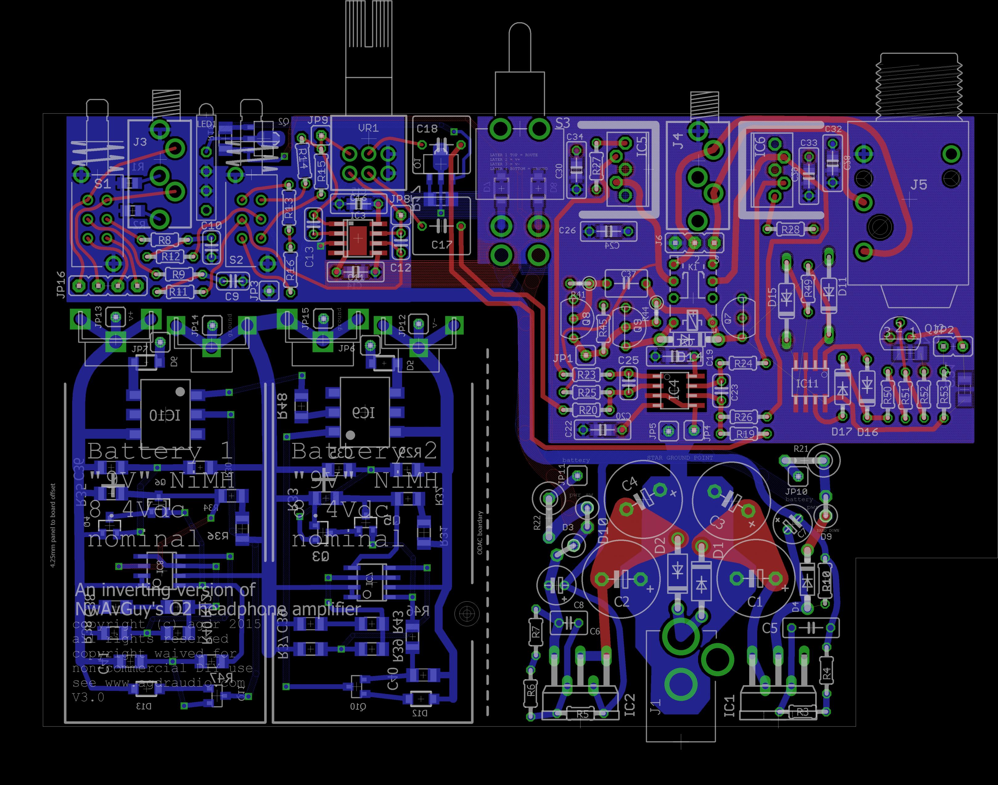

Here are bunch of modifications and additions on this project. :)

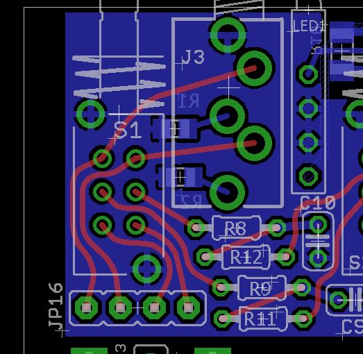

I had an idea on the new input select switch, the second image below. I've added PCB holes on both throws of the switch (JP16), including the one that is hardwired to the front panel 3.5mm jack. This allows for a whole bunch of fun optional combinations of parts:
* switch in: ODAC input (PCB hole pair 1); switch out: rear panel RCA input (PCB hole pair 2). Anything plugged into the 3.5mm would be in parallel with the rear RCA, so use one or the other.
* switch in: ODAC input (PCB hole pair 1); switch out: front panel 3.5mm via the hard wiring (nothing in PCB hole pair 2). Then ODAC out also run to the rear panel RCAs for ODAC line out in parallel with the amp input.
* No ODAC, batteries. switch in: rear panel RCA input (PCB hole pair 1); switch out: front panel 3.5mm jack via hardwiring.
etc....

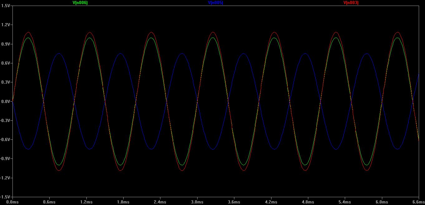

Then regarding sgrossklass' good suggestion in post #14 to have some gain in the output stage, I've implementing it but in a special way. :) I want to keep the overall amp voltage gain in the low gain switch position unity (1x). So although I'm bumping the output stage votlage gain up to 1.33x, I'm actually decreasing the input stage gain to 0.75x = attenuation! This makes use of a poorly understood (at least it was by me a year ago) feature of inverting amps: unlike non-inverting stages they are stable below unity gain, all the way down to zero voltage gain in fact (full attenuation). Here is a great discussion about it on TI's engineering discussion forum:
https://e2e.ti.com/blogs_/archives/...verting-attenuator-g-0-1-uh-oh-is-it-unstable
The net result then is 0.75x voltage gain in stage 1 (a 7.5K feedback resistor with the 10K composite input resistor), times 1.33x gain in stage 2 (a 33K feedback resistor with the 24.9K input resistor) = 0.99x overall voltage gain (current buffer-only mode, same as with NwAvGuy's O2 in the low gain position).
Then in the "high" gain switch position the new feedback resistor is 18.7K in the input stage for a first stage voltage gain of 1.87x. Multiplied by the new second stage gain of 1.33 gives (still) 2.5x overall voltage gain, same as before and same as the most used high gain position in NwAvGuy's O2 headamp.
Then regarding sgrossklass' interesting suggestion to elminate the resistors to ground on the non-inverting inputs in post #18, I'm chickening out on this one and leaving the pads for the resistors. :) LTspice is having trouble converging with those inputs tied to ground directly that it doesn't with some resistance there. Probably just a simulation artifact, but there is also something rattling around in my head from way back when about trouble in tying some FET input op-amp inputs directly to ground. I can't remember why now, but I think it may have been voltage-to-substrate issues, in older FET inpu op amps. At any rate a jumper can simply be used in place of the resistor if anyone wants to tie those non-inverting inputs directly to ground. I am going to decrease resistors to 1K from 10K in the input stage and 5K from 24.9K in the output stage, which should at least help there with noise reduction.

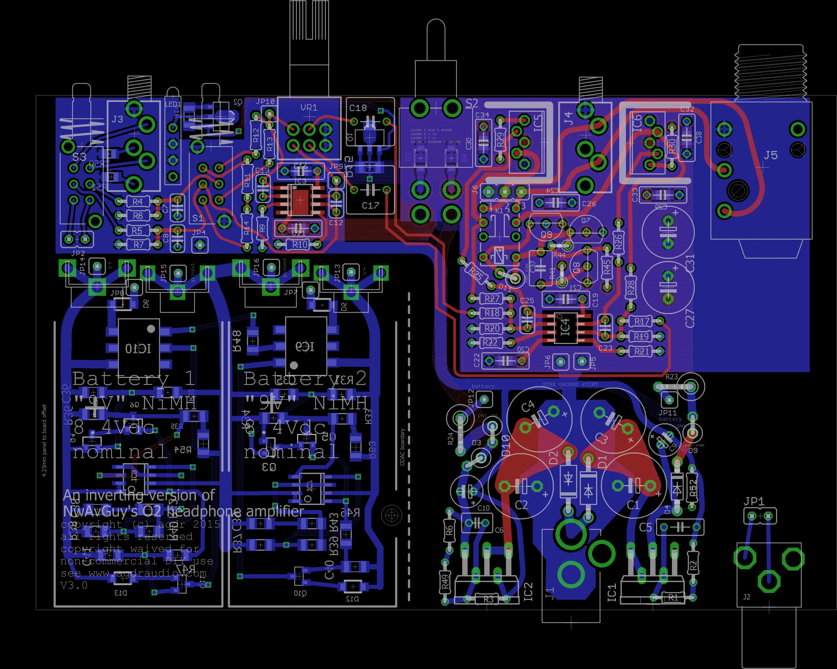

I've completely ripped up and re-done the layout around the headphone relay. In the old V3.0 layout in the first post in this thread a lot of the traces had to snake way to the left to get to the relay. Now the relay is centered, which shortens all those traces. The relay control circuitry is now on the left of the relay.
Plus I had a bit of a brainstorm on the relay circuit. :) In the ODA I have the relay coil looped through one pole of the on/off switch to peform the "no thump at turn off" function. It works wonderfully. There is no greater "advanced notice" of an amp power-down than the power switch, of course. Well here both poles of the switch are in use by the main circuit, preventing me from looping the relay coil through. Sure enough, although the turn-on thump is gone, there has been a small turn off thump. 3 pole right-angle PC-mount toggle switches exist, at least in the catalog, but not in stock at Mouser or Digikey. The 3 pole switch is also conisderably wider and wouldn't fit.
Well it hit me that one pole on the unused "thow" on the power switch in NwAvGuy's switch-in-the-middle design here can be used to shut down the relay control mosfet and nuke the output thump, similar to what I did with the ODA! :D The source on that relay control mosfet is already tied to the negative rail, which goes to one pole on the power switch. That switch is non-shorting, so tying the gate of that mosfet to the other "throw" on that pole causes the gate to be shorted to the source when the power switch is turned off. Mosfet goes off and so does the relay. :)
Then finally I've implemented another one of sgrossklass' suggestions in post #14, the clipping indicator (the stuff in the green circle, still a work in progress, but at this point at least I'm sure it will fit). I've used the clipping detect circuit from the ODA, which in turn came from various internet posts out there. I've made a compromise for space though. The ODA clipping circuit is "stereo", sensing both channels. Here I''m just going to make it "mono" on one channel, under the theory that if someone's source input is high enough to cause clipping it will probably be happening in both channels. Sensing the clipping on just one channel requires just a smaller a SOIC 8 chip instead of SOIC 14, plus saves two diodes.
Plus now the clipping circuit is going to be on the output stage, vs being on the input stage in the ODA. That works because of the first point above, the output stage now having gain, so it will be the first to clip as sgrossklass noted. Good stuff! :)
I've notched out the right rear corner of the PC board since the RCA jacks will have to be rear-panel mounted vertically to fit. No way to make them fit with either one PC board mounted. These are the REAN/Neutrik panel mount units with the 15.5mm insulating washers.

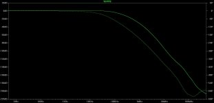

In the LTSpice plots green is the input source, blue is the output of the first stage, and red is the output of the second stage. In the transient plot I've used a 36K feedback resistor instead of 33K to bump the gain up slightly so the red trace would be visible vs. the input green trace. With 33K they would be on top of each other, of course. The peak of the input trace is 1.0V, the first stage output is 0.75V, and the output would be 1.0V again with 33K feedback. Note the output of the first (inverting) stage (blue trace) is 180 degrees out of phase vs. the (green) input, just like it is supposed to be, while the resultant (red) output trace is back in phase with the input after the second inversion.
In the AC plot the initial gain on the left axis is 0dB, while th initial phase on the right axis is zero degrees.
