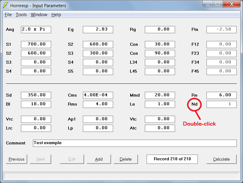

It takes about two seconds to "offset" the woofer. First, click on the "Tools" menu and select "Driver Arrangement."
It takes even less time by simply double-clicking on the Nd label.

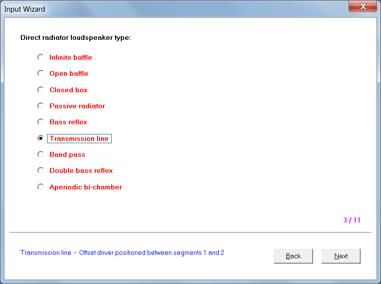

The fastest way to optimise a transmission line loudspeaker in Hornresp is to use the Input Wizard to specify a generic template, and then adjust the parameters to suit using the Loudspeaker Wizard, adding absorbent filling material as necessary to obtain the best overall response.

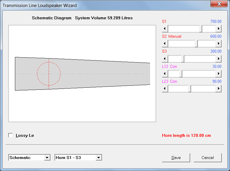

Ok, but now, how do I move the driver up and down the line?
Sorry, couldn't find that...
In the menu, I have OD and OD1, but I don't see a way to move the driver, let's say 25% from the top, or 33cm from the top... how do I do that?
You change the length of the first (and second) segment. The OD driver is placed at the junction between the first two segments. A bit more fiddly than just adjusting a single value, but it works.

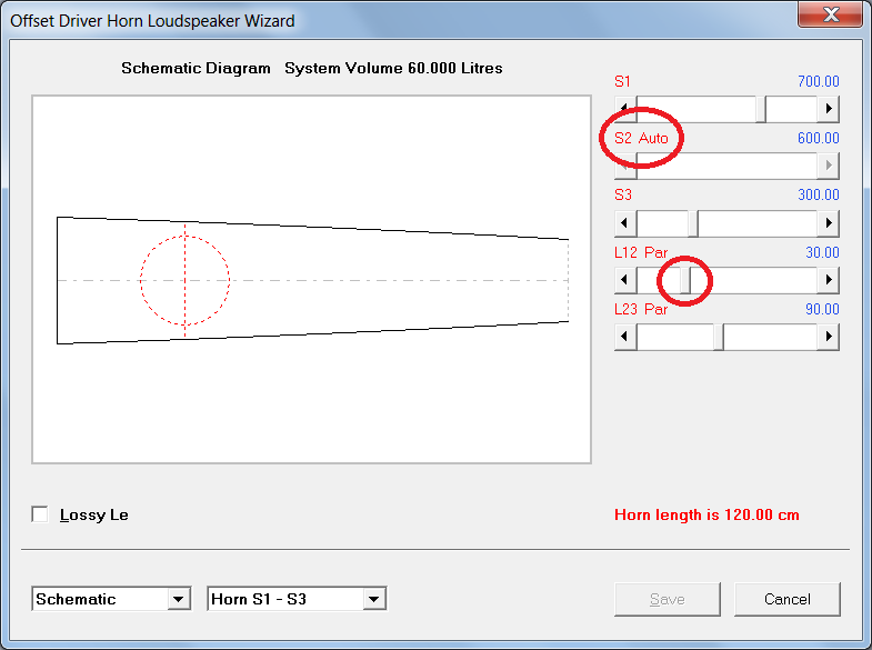

Very easily indeed, if you use the Loudspeaker Wizard with a two-segment design.
Set the S2 slider to Auto by double-clicking on the 'S2 Manual' label, and then adjust the L12 slider while watching in real time how the response changes. The overall taper rate and length will remain unchanged as the driver is moved.
