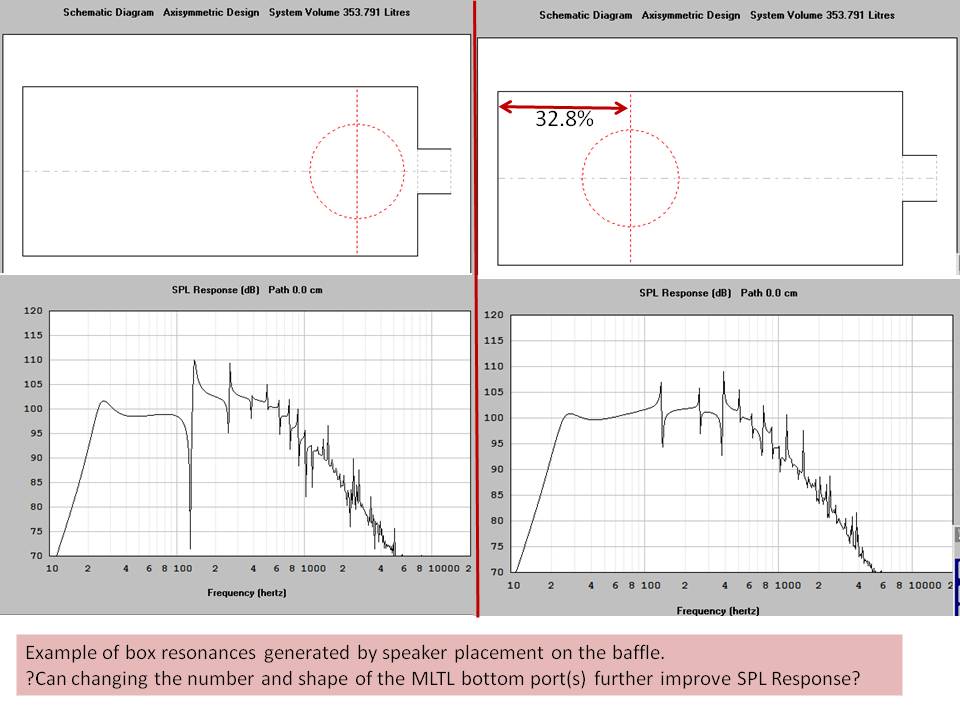

Attached HornResp data comparing SPL response when the speaker is located near bottom of box, and ~32.8% down from top of a quater wave long box. The selection of stuffing material can also shape SPL response and final sonics. Naturally, not all designs permit flexible speaker location options.
What is the best simulator to add port shape modeling?
?Exporting the HornResp model into AkAbak and then extending that AkAbak model to include detailed port models?
Has anyone successfully modeled multiple ports with X,Y,Z dimensions that control resonance and air flow restriction?

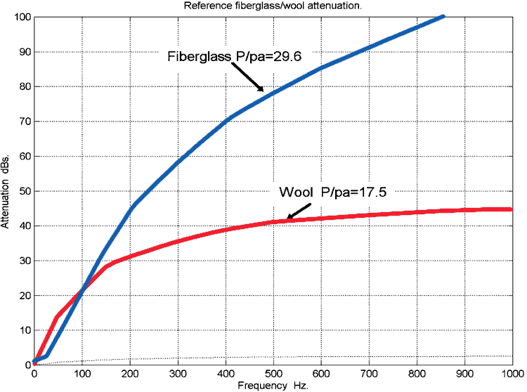

I have successfully modeled port shapes by approximating a 2 dim port as a series rectangular ports of prescribed dimensions. This is how I modeled the Karlson aperture. See post in the Karlson thread here: http://www.diyaudio.com/forums/full-range/213594-karlson-10.html#post3528706 I have also modeled arbitrary ports located at different points along the TL to detune the Q of certain cavity resonance modes. See my thread here: http://www.diyaudio.com/forums/full-range/237384-flute-pipe-tl.html.
Akabak is very flexible and allows arbitrary xyz (and alpha, theta, phi angular orientation) placement of ports/vents/radiators.

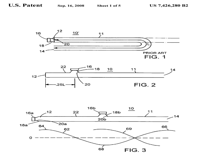

I hope not. It's all one line (or it should be) -the driver just happens to be offset / tapped into it a x distance from the throat. 99.9% of the time, it should be offset for the most balanced response (there are exceptions). None of this is new, it's been done for years. Augspurger, King et al all go into detail & there's a wealth of information & quality designs out there for all kinds of QW lines, be they straight or tapered TLs, MLTLs, or whatever & the vast majority have the driver offset. TBH, I'm startled the OP hadn't noticed since it's rare nowadays to find a properly designed QW / TL where the driver is not offset.
we see the dip is occurring at a frequency that's equal to the length of the transmission line.
Or more precisely: at a frequency whose wavelength is equal to the TL line.
I would also imagine most folks have seen TL driver offset, but I wonder how many know why it is used. I think most would say that it effects harmonic modes. But, I think that less folks know that it also effects destructive interference. And, that is what the OP was referring to.
Fig.2 refers to what the OP was talking about. Fig.3 is what I referred to in post #25
