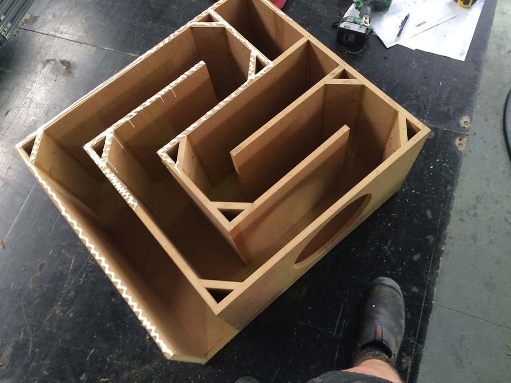

I put the microphone inside the transmission line at various resonance frequency, and move along the length of TL-line to measure what happen inside it. I can found that the "Peak" and "Dip" SPL are found along the TL-line wave-length 1/4, 1/2, 3/4....).
So, is it possible to use this method to determine the exact Driver-offset location (i.e. 1/4 or 1/3 )?😕
Not 'exact' due to the impact of damping and taper on a TL's effective acoustical path-length, though at odd harmonics of its physical path-length is plenty close enough IME as well as many others.
Even tapering up to a 10x change doesn't affect it much according to MJK's math/actual measurements, from ~1/3 to 2/5ths [scroll down to pg. 12, TABLE 4]: http://www.quarter-wave.com/TLs/Alignment_Tables.pdf

This is my first time posting, but I've been lurking here for some time now sponging up new information. I had to come back here to post this... I was experimenting with transmission lines for a while but found there was not much frequency range before that first big harmonic dip in the response. I tried moving the driver 1/3 down the path and it worked perfectly. I used this method for my car subwoofer and modelled it in hornresp
I was so happy with this it worked on the first attempt. I have no measuring equipment yet, but from what I could hear it was so much tighter (like a sealed box) except a flat response down to 24hz. I had this crossed over to my car speakers at 100hz and compared to the previous vented box I had with the same woofer I had nice mid-bass back. This is like having the best of a sealed and ported box at the expense of its size

Nice work! I agree that TL's can make some incredible tight bass. I did some thing similar with a much smaller woofer and got as you say, the tight response of a sealed but extension of a bass reflex. It requires damping/stuffing along the line to make the two impedance peaks merge and become one squashed bump. That is the point it becomes a periodic and is best trade off for low group delay and bass extension. The model and build agreed pretty well.
