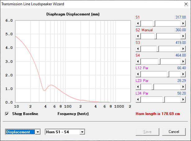

Thanks - yes, I am happy with these results. I need to see if I can tweak it a bit to be a little easier to build, and learn how to using the Filling number in the Hornresp Loudspeaker Wizard, to get an idea of how much stuffing and where in the line it needs to be. I'd like to tame the spikes, obviously. I am amazed at how broad this type of TL covers.

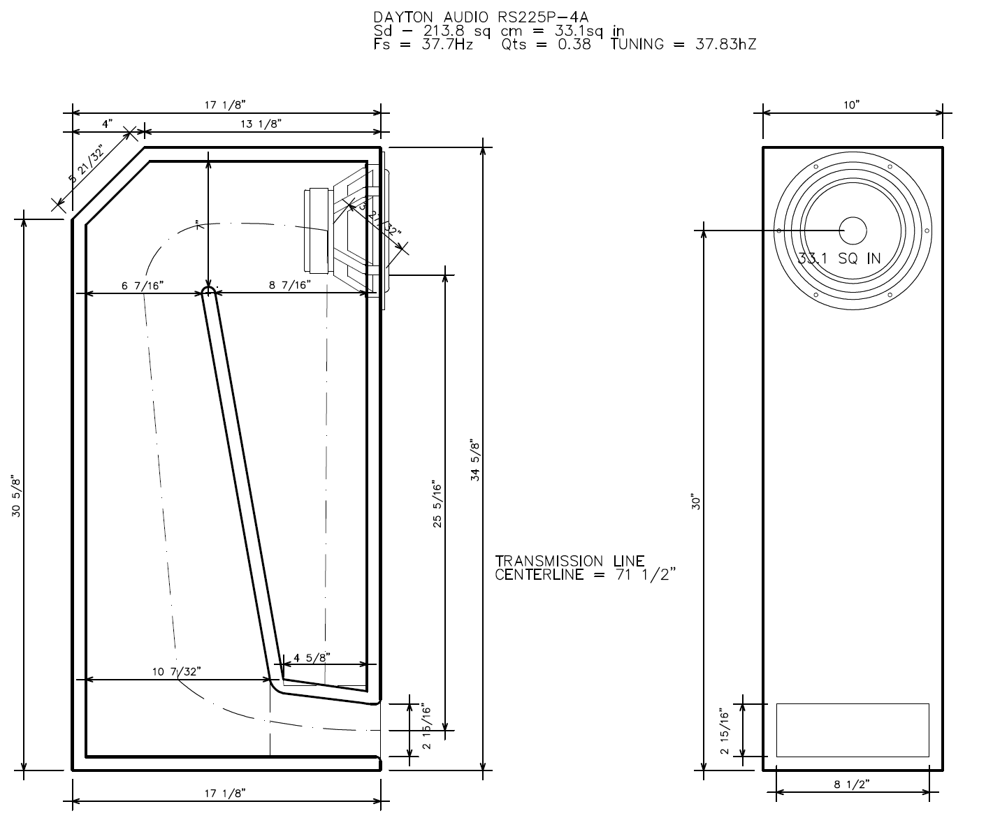

Neil,

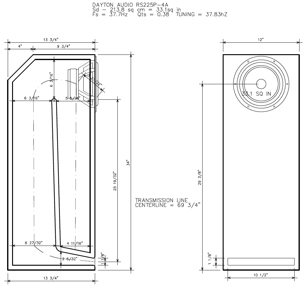

My first thought actually was that you could probably get virtually the same performance with a less complicated build. Have you tried modeling a similar geometry but with only 90 deg angles? If you have a CNC it doesn't matter so much, but if not, a simpler design would be nice.
And what's the purpose of the 7-31/32" piece? Is that related to the "void" you mentioned? It seems to me that with a little tweaking of the design you wouldn't need that extra piece. Of course I may be missing something...

I have continued to work on this, and have made some important progress, using the fill in the Loudspeaker Wizard.
And I have made further adjustments, like narrowing the cabinet. I will post what I settle on, but this is pretty close already.

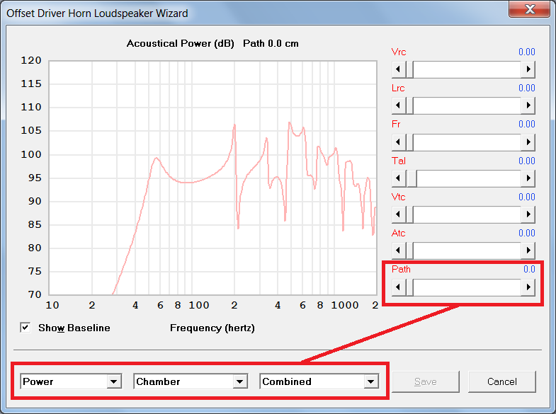

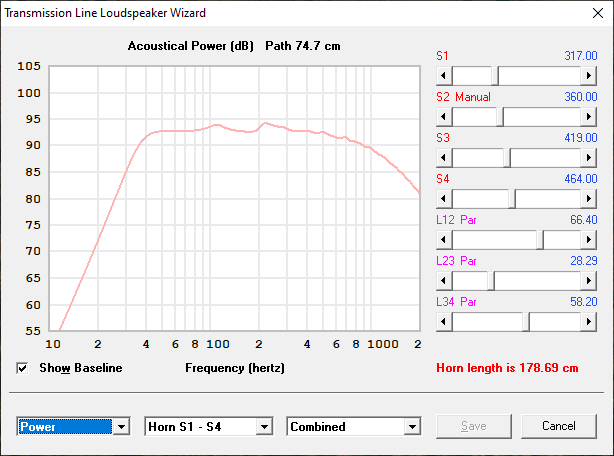

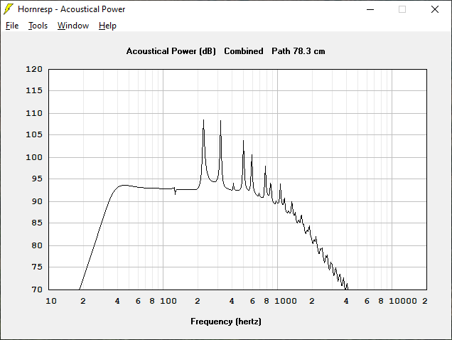

For my own education, I tried reproducing Neil's model in Hornresp. But when I did it, the "path length" was shown as 0 cm, compared to 74.7 cm in Neil's. How do you set path length?

GM,
Okay, I see it now. But I can't set it. Unlike the rest of the slider bars, it seems to be inactive. There's no button on the Path slider bar, and the arrows at the ends of the slider bar are greyed out. I think I've tried all three versions of Transmission Line in the Input Wizard. Do I need to be in a different speaker type?
Eric
Eric
Well, it does have to be in the 'power' window for it to work..........if it still doesn't work, Export the file for us to have a look-see.
GM
GM

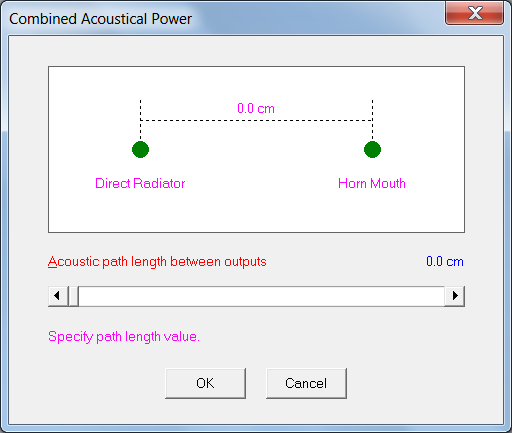

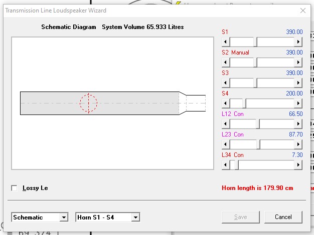

In the Loudspeaker Wizard, select the Power, Chamber and Combined or Combined 1 options.
Alternatively from the main Acoustical Power chart window, select the Tools > Output > Combined menu option.

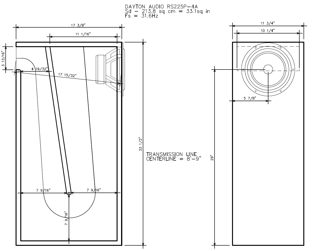

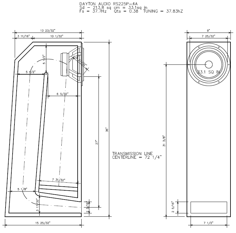

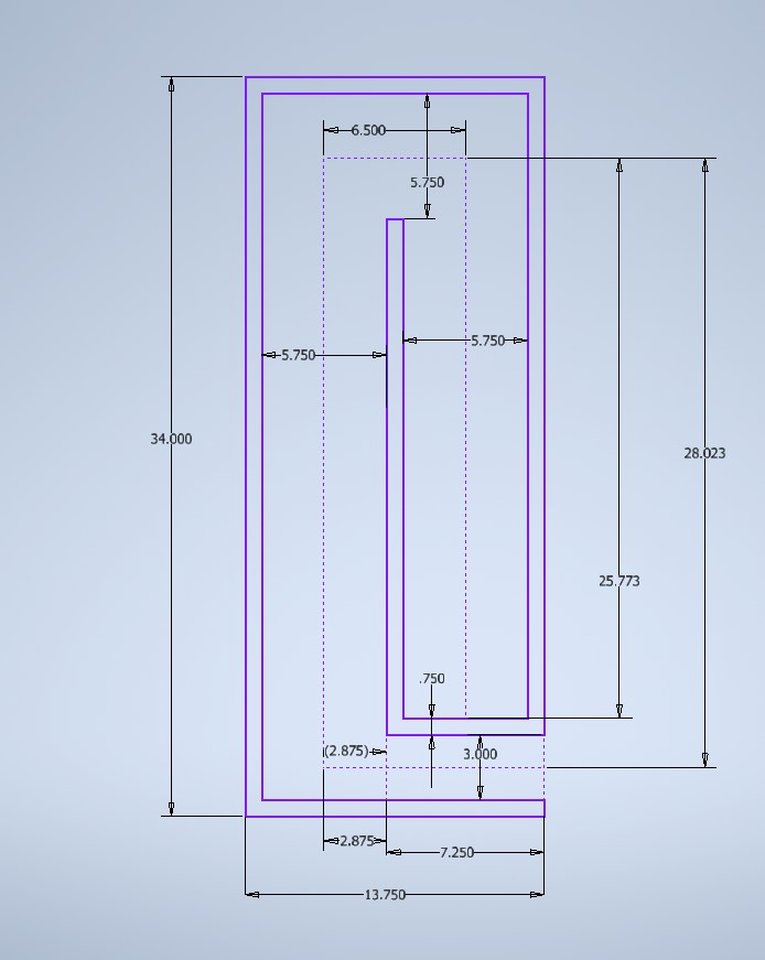

Okay, now that I have the path length figured out, I tried designing my own variation of Neil's TL design. The idea I was wondering about was if there would be any compromise with a design of the same overall dimensions but with only right angles. The attached shows the design I ended up with. My next post will show the HR results. Note, I didn't bother to draw in the driver location, however, it's in the same place that Neil put it (top of right side face).
Eric
Eric

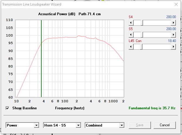

And here below are the HR results (assuming I didn't mess up).
Filling settings are not shown, but I used 100 in the full length of the first 2 segments.
I was a bit surprised that the size of the port was so much larger than Neil's but still resulted in similar, maybe lower, fundamental frequency. (It makes me wonder if I messed something up).
Does this version of the design compromise anything that Neil achieved with his version? If not, it seems it would be easier to build.
Please note, this is not intended in any way to be a criticism of Neil's design. I undertook this as an educational exercise for myself. And maybe it even helps Neil if he likes it.
Does it look like I modeled the box correctly? And if so, what are the pros and cons of this design vs. Neil's?
Thanks,
Eric

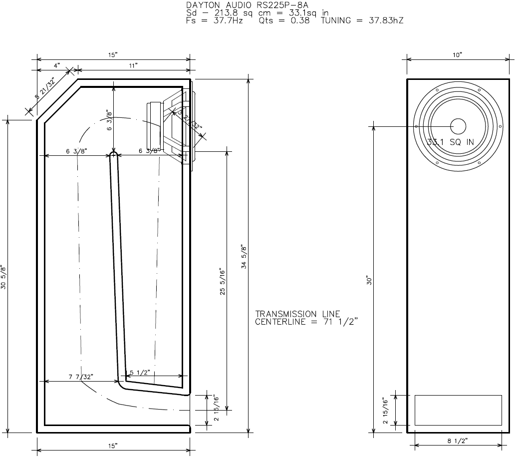

These three designs are where I am ending up. The first is using the 8 ohm version of the Dayton Audio RS225P woofer, and is intended to be used with a Radio Shack built 1.5" high Linaeum tweeter.
The next two are different possible cabinets for the 4 ohm woofer for use with the 6" high Linaeum TLS tweeter / midrange. It is higher efficiency, to be a closer match with this tweeter. The two are showing very similar results in Hornresp, and I would like to hear folks advice / comments on all three?

Eric - it has a smooth response! What driver did you use?And here below are the HR results (assuming I didn't mess up).

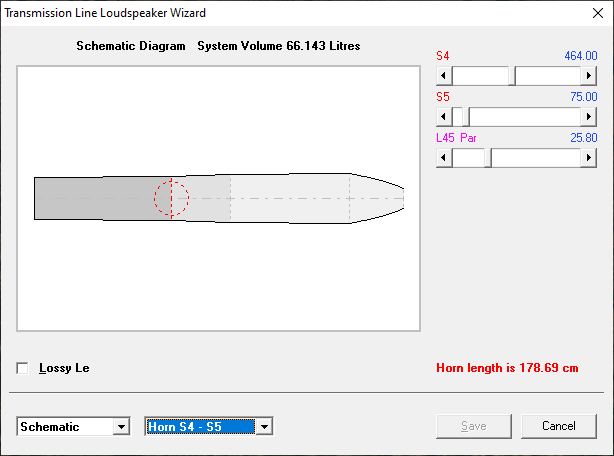

Awesome - I will try your settings and then draw it. It looks like you got it done better than I managed. And in a smaller package to boot. How are you getting the fundamental frequency to show? When I am on that dialog, I see the Horn length 179.90 cm rather than the frequency.
