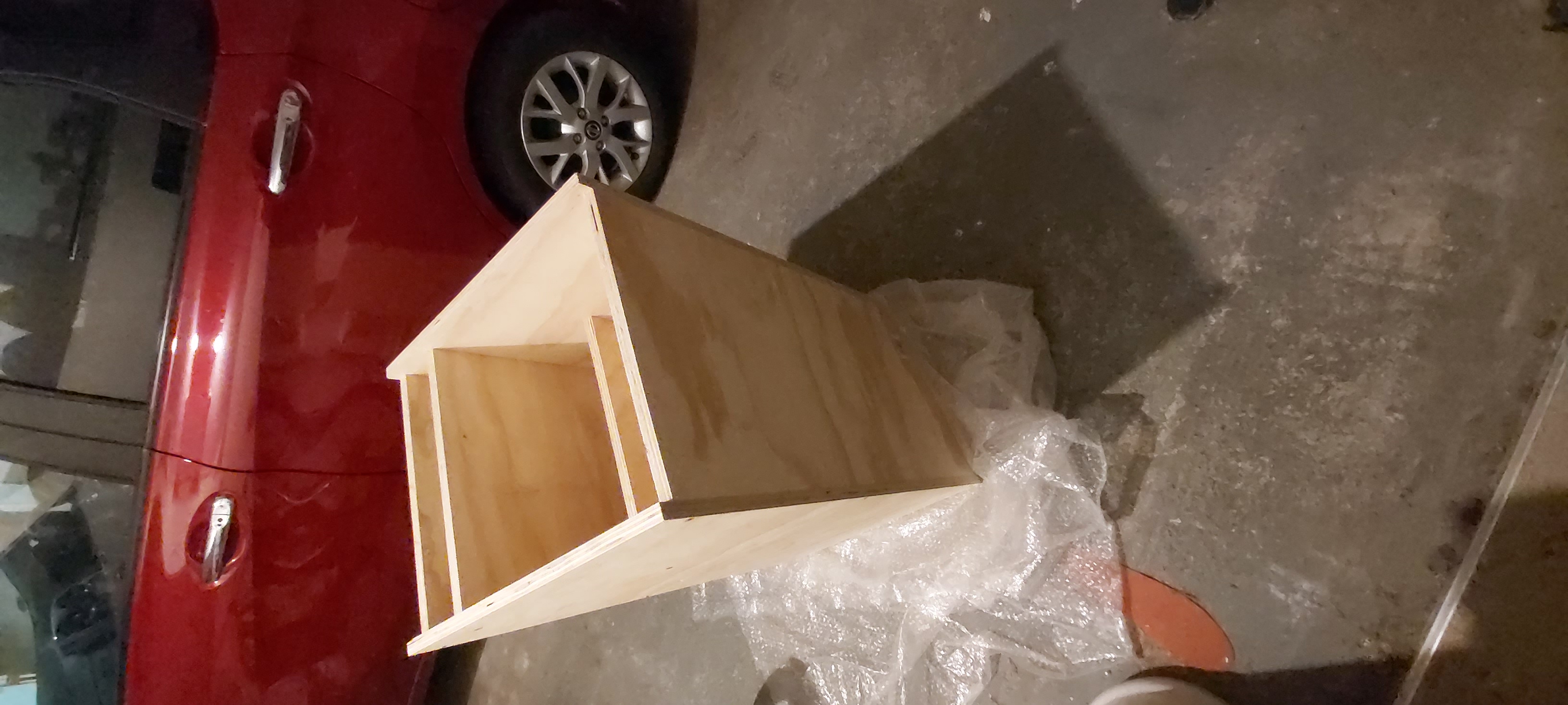

A few pages back, around post 144, I said I wanted to build a simple MLTL sub to replace the Pipeline TL contraption the Mrs said had to go. Over the past few weeks I have been doing the groundwork for the new one, which she won't much like either, but at least I've softened her up regarding size. It is pretty big but hey no pipes!
Gave up on the table saw for cutting straight edges and have been using that as a workbench instead. The new cordless skill-saw does a much better job, and I'm using the fence off the old table saw as a guide so with a bit of messing around I'm now able to cut out pieces that have tolerances inside of 1mm (most of the time).
So over the weekend I threw together the cutout pieces and it all came together pretty well. Currently I've just screwed it, in case the whole thing is a disaster. Will glue it once I sort out whether it's a runner or not (the alternatives are a smaller TH or BP sub). I couldn't see any any air leaks or obvious gaps during the screwing procedure.
So all that's left to do now is the end cap with the driver cutout, and wiring. Should be up and running by next weekend, hopefully.

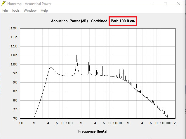

So below is my (unstuffed) MLTL example. Here the striking thing is the difference in the "spikiness" between the two models, and in particular the big drop in output predicted by LATL for the region between the 1st and 2nd overtones (i.e. between about 180 and 280 Hz). Hornresp predicts overtones in the same locations, but virtually no dip below "baseline" power.
Is this difference also just due to the fact that LATL result is pressure, and Hornresp is power, or is there more to it than that?
Eric
Hi Eric,
Power and pressure response results are normally reasonably close at the lower frequencies, where "beaming" due to directivity is not a significant factor. The difference you are seeing below about 300 Hz is probably due to the Hornresp simulation having a specified acoustic path length of 100 cm. (It is difficult to know for sure without seeing the inputs you are using, but I suspect that LATL assumes a zero path length). Do the results look more similar perhaps, if the Hornresp path length is set to 0 cm?

David,
Thanks for your reply. Does path length simply mean the distance between the driver and the port? The inputs I used and the schematics for both models are shown below. Unfortunately not every input for the LATL model appears in the image, but in both cases I modeled a 120 cm line with the drive and port each 10 cm from opposite ends.
If I'm understanding he meaning of "path length" correctly, setting the path length to zero would mean placing the port and driver at the same location in the line, is that correct? Doing that in Hornresp did not make the results more similar. Is that what you meant or am I misunderstanding?
I don't think LATL assumes a zero path length, because moving the driver and/or port to different locations definitely changes the results, and in particular the locations of the peaks and valleys in the SPL plot.

Hmm, looks like one of my HR sims done by setting the path length 1/2 the distance between the driver/port to emulate ~what we hear at a seated distance, so setting to zero should put the peaks/dips ~at the same frequencies, though from very dim memory the LA's TH sims were inverted, so at this point trust HR over LA is what I'd do.

Maybe I don't know what "path length" is. LA never refers to it. HR calculates it automatically, or defaults to something. I don't know how to change it. In HR, path length appears to be the distance between the driver and the port. Or maybe that's just a default?
What are "TH" sims? Transmission Horns??
Eric
Historically, software assumes the driver/vent are concentric, ditto HR, so where there's a defined location for each, the program calculates the delay between them.
HR does allow us the option to offset the delay, which is what I/whoever did in the sim. I used LA some, but don't recall having the option, so concentric TTBOMK.
TH = tapped horn, i.e. a bass pipe [TL] horn that folds back onto itself to sum the loads of both sides of the driver; technically a 6th order band-pass [BP6] alignment.
