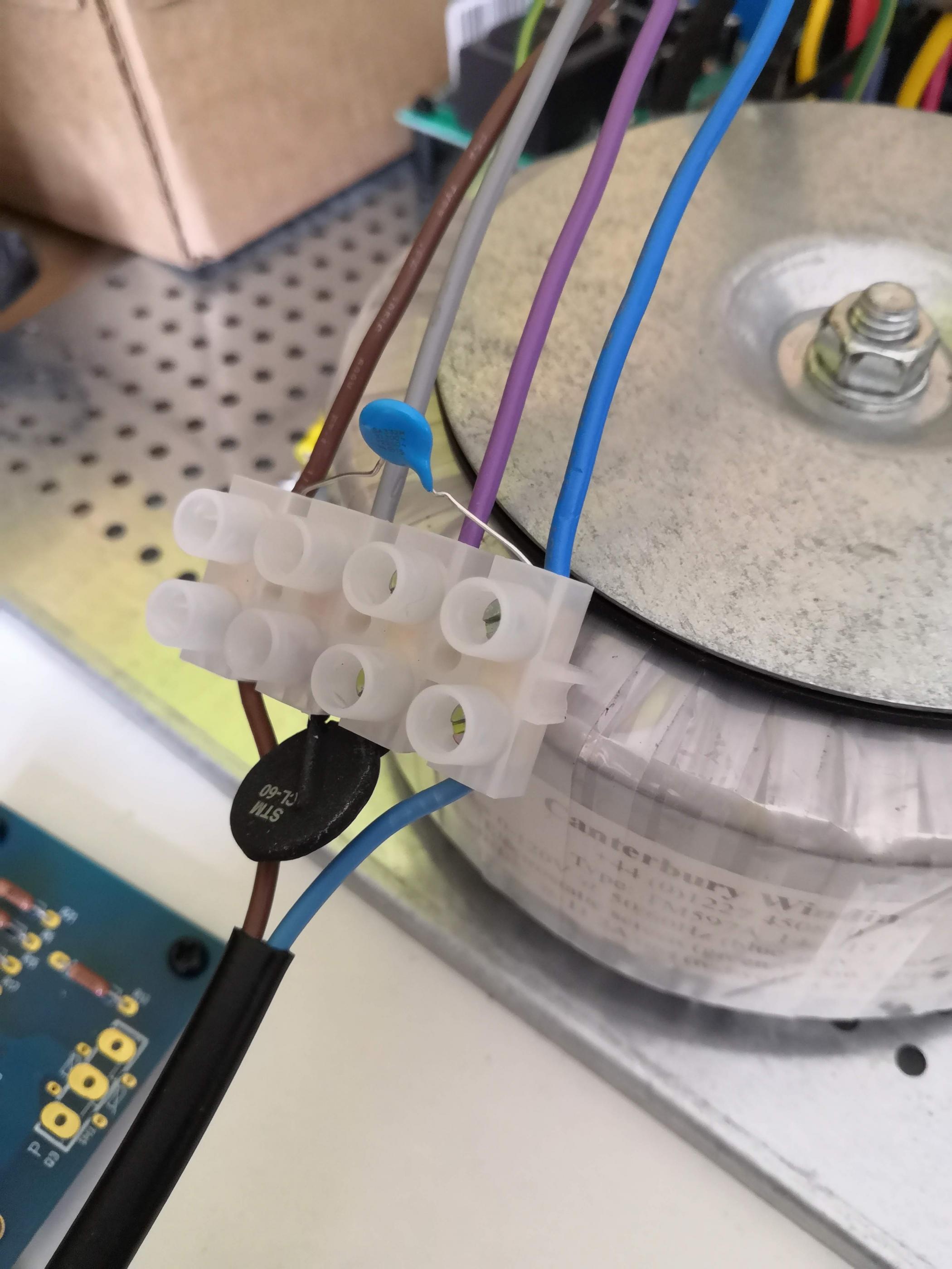

it looks good (at least reading colors on xformer printing) , confirm proper polarity simply by powering it and checking voltages at secondary
though, be sure that shown arrangement with plastic connection block is temporary
NTCs gets hot in operation, and that's not bode well with these plasticky ones, nor tiny NTC legs goes well with screw connection
Thanks - yes, this is just mock up for power supply test (with bulb tester), I have proper connector block for later assembly.

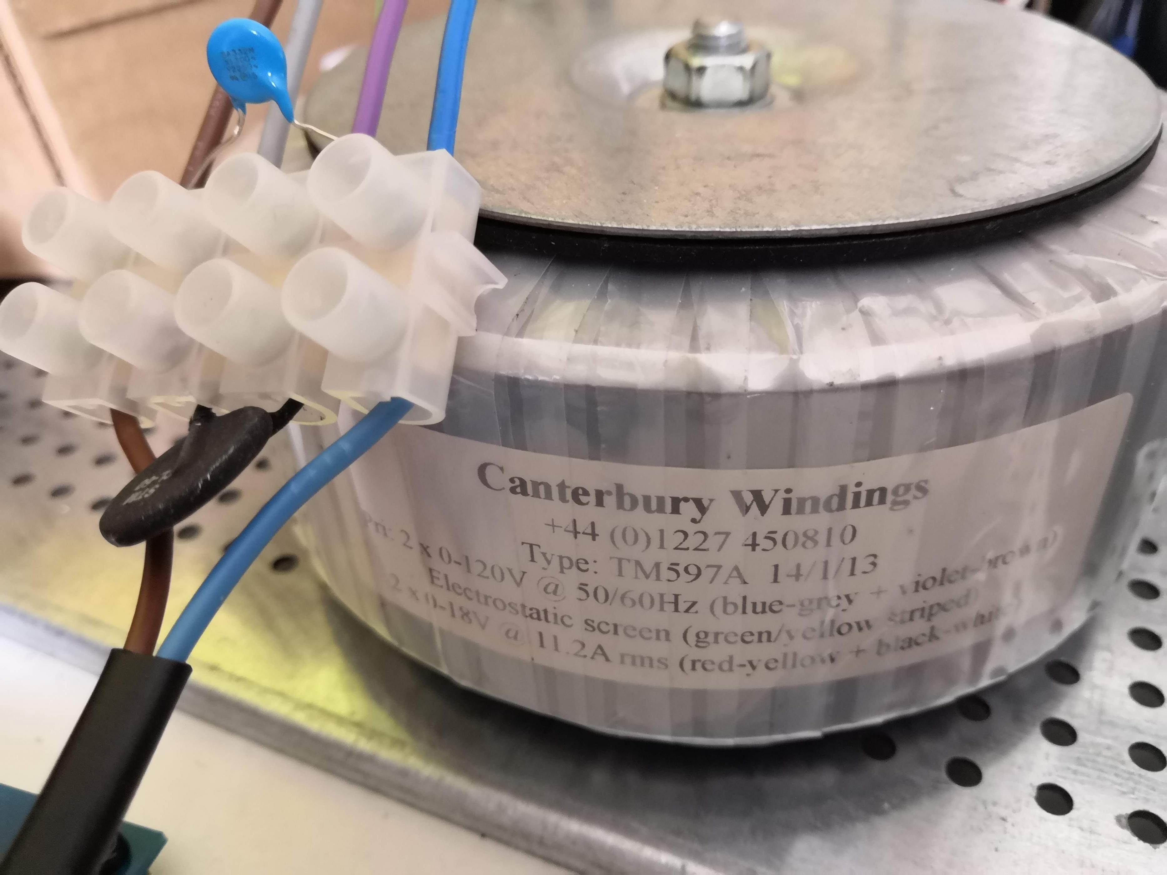

Can someone just sanity check my connections with CL60 / X1 cap placing please, I have been reading the threads for a while and just want to make sure this is OK for UK voltage? In case it's not visible on the image, the Toroid has 2 x 0-120V Primary (blue-grey + violet-brown).
Take a look at this simple, easy to follow drawing @6L6 did at the front of this thread:
An illustrated guide to building an F5
This looks correct for 240V. Put a dim bulb on it and power up.
