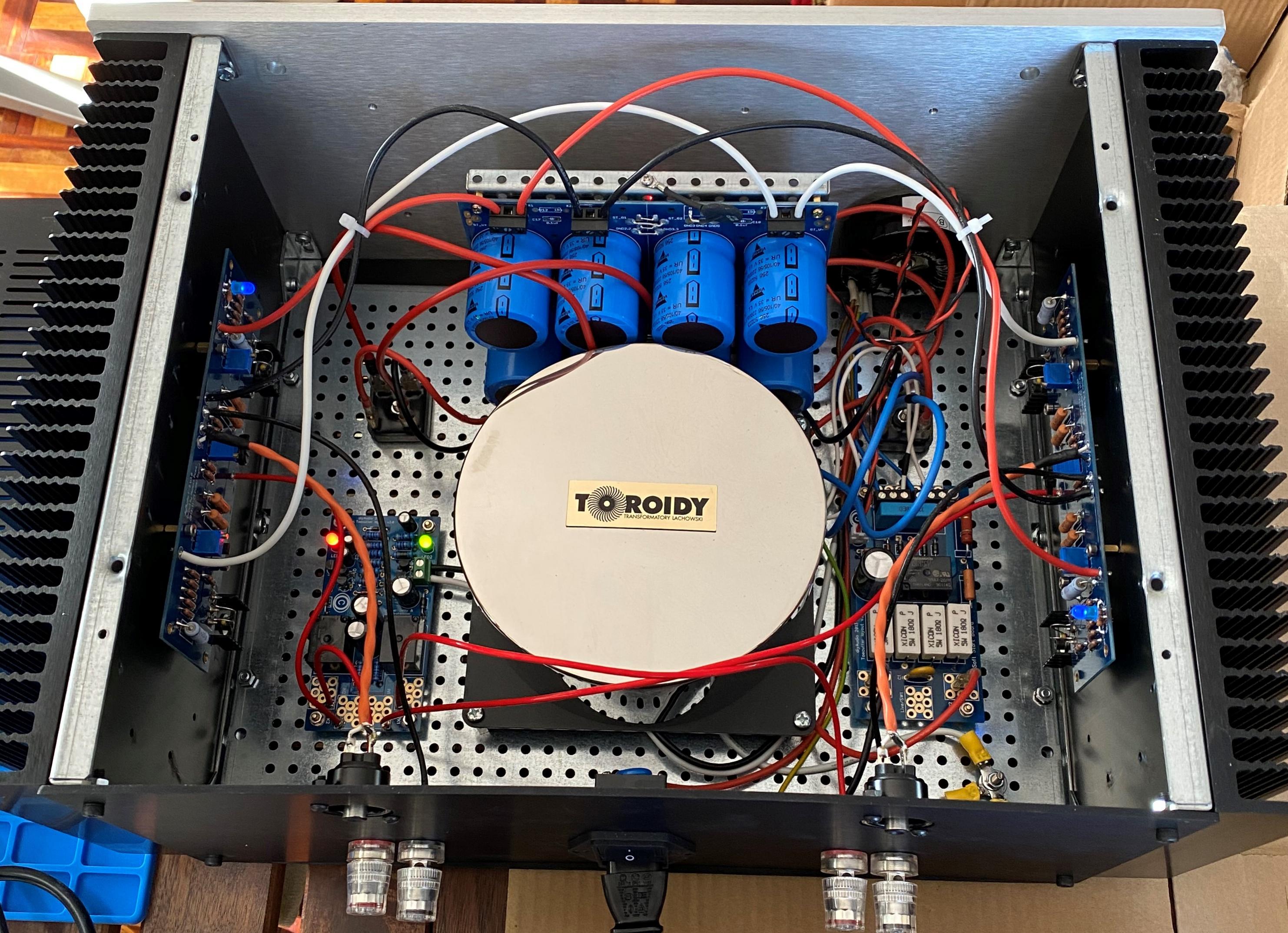

After breaking my F5 down into a pair of monoblocks, I managed to fry the outputs in the one amp. Not sure how I did it exactly. I was aiming for about 1.55 amp bias. Was this a totally stupid idea? The things were barely getting hot. I've got more parts on the way, but I'd really like to avoid repeating this stupid mistake.
32V @ 1.55A is 50W. That's a lot, but not immediate-destruction levels....
That was my thinking too. They're on huge heatsinks and weren't getting anywhere near warm enough not to touch for any length of time. They were clearly making good contact with the heatsinks. I'm thinking I'm going to aim for 1.45 amp and go with that for a while and see how the old pair in the other amp hold up. They're idling just fine at about 1.55 amp even after letting it cool and powering it on a few times. Thinking I might have had a weak part that just gave up and took the other one out with it.
