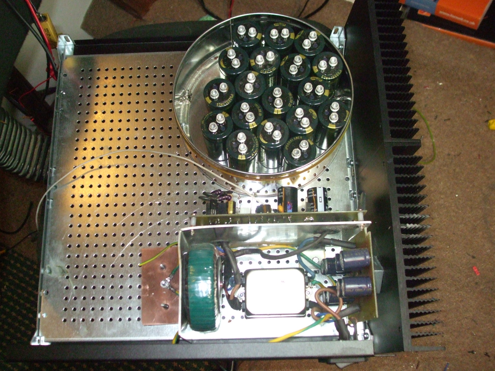

Still got the giggles and as sunny today 3 bottles of Sol with lime to many sizling in the garden so no much work.
definetly back to 18 C and dull tomorw

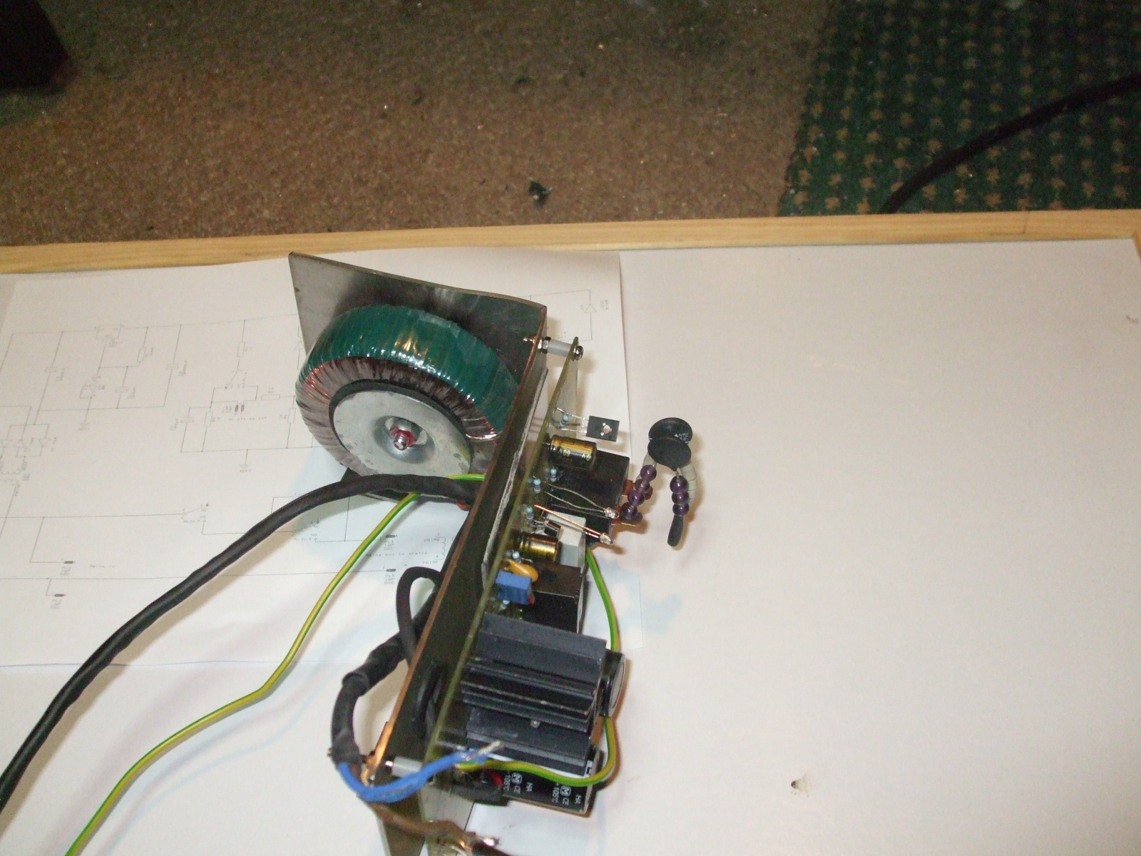

So have a pre view.
New 2 transistors on off and soft start
Mounted on aux supply
In new PSU case with DC filter and shafner EMF duda
Big box today she saying what the Fluff is in that?

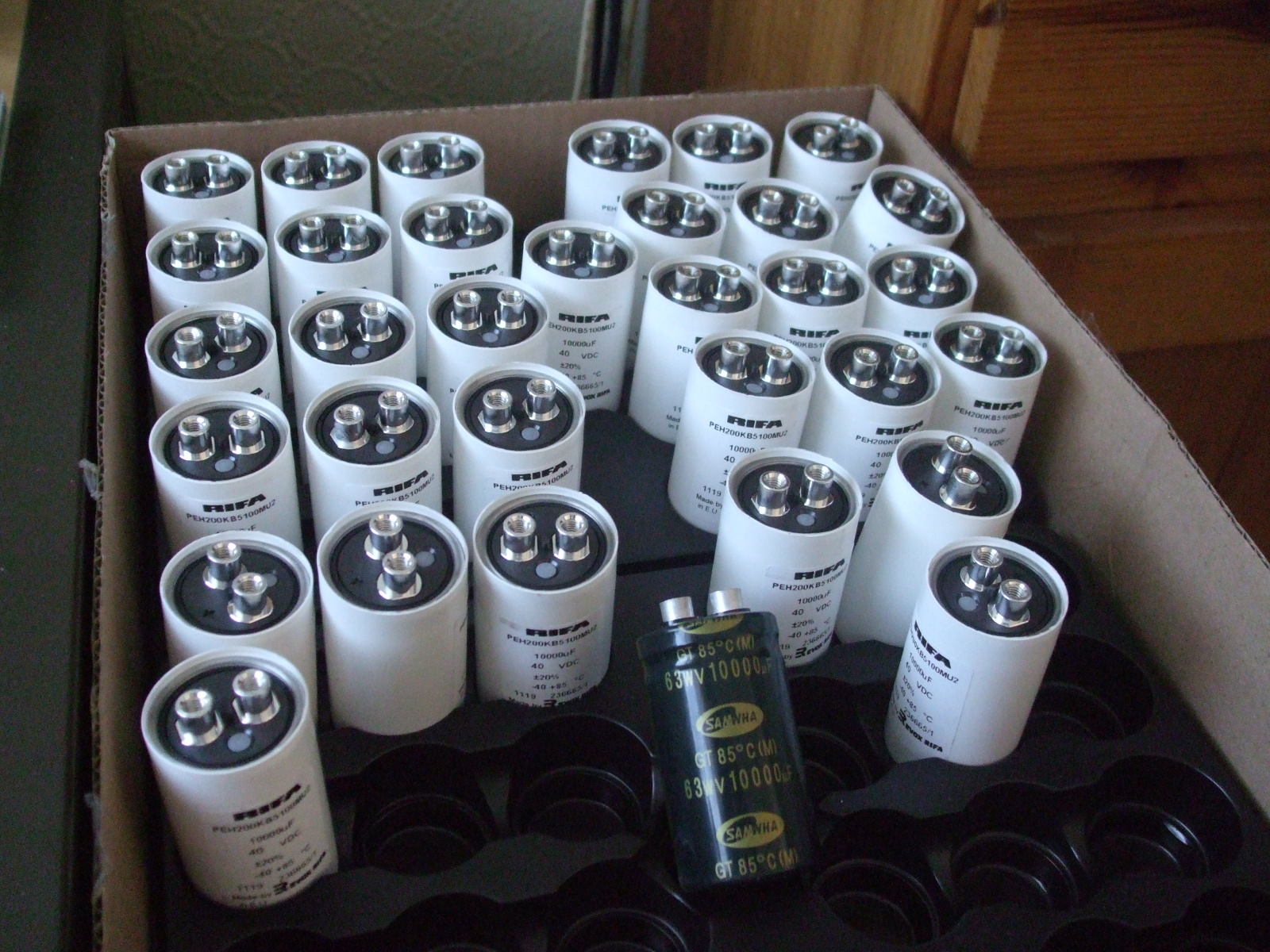

Usual answer>they blipping got not a clue about global warming such a big box and is full of packing paper. And a few new Caps.
