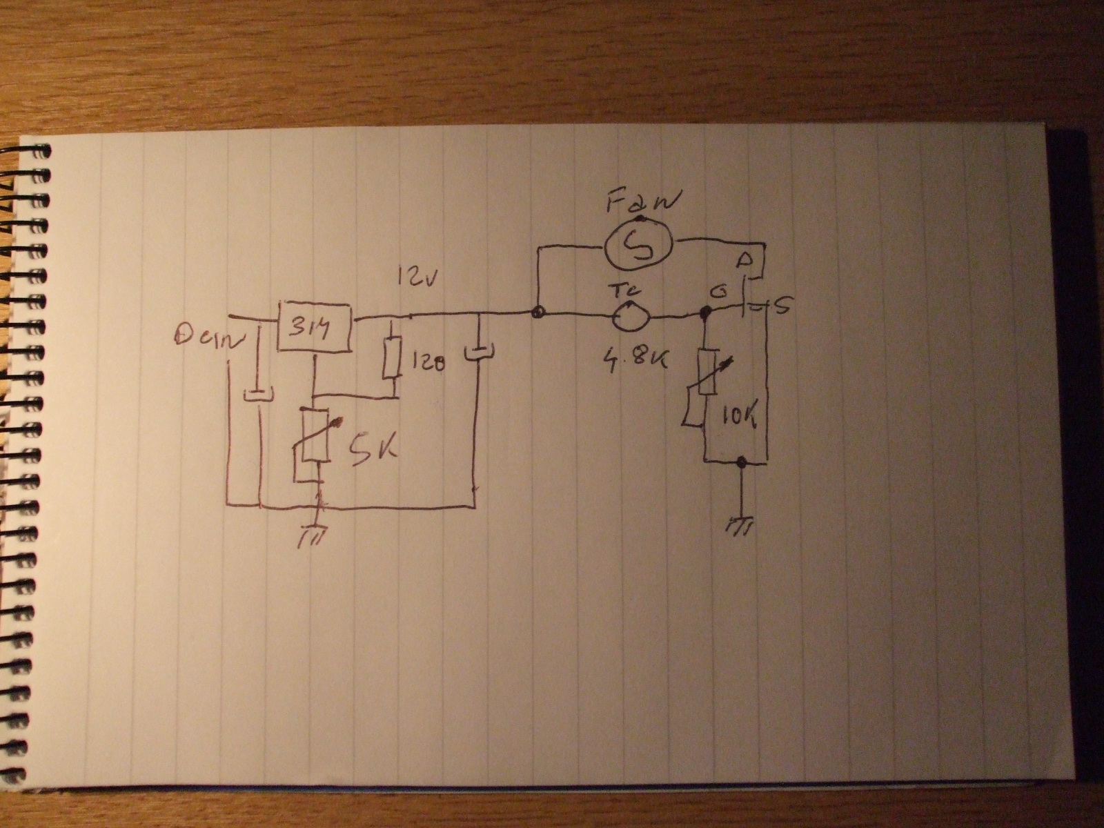

As on PM sink at 53 with ambient at 29 is fine and it will be perfect in the winter.
Main worry is the actual mosfets temperature.
Could you measure the mosfets case temperature?
There is a graph on the mosfets data sheet that shows the relation between the case and Junction temperature.
As you I have 4 Homs speakers but with poor 87 dB so half as loud as yours so I went for the best possible cooling I could in order to increase the current.
If you worry about the mosfets temperature there is quite a bit that can be done
Maybe a start would be to use Kerafol red. Loads about this on this tread....
Another thing you could do is to use a small computer fan for when summer proper came and ambient temperature gets up to hi 30.
I have a symple fan controler that works quite well and is made up with the same parts you use on the F5 you can skip the LM317 part if you use 2 12 V fan in series.
Just stick the thermistor to the heat sink and get the fans to start turning slowly at 50 C the hotter the sink get the faster the fans turn.
I will send you same 100 homs for you to try next time i get to Post office (next week).

A yess main thing leave thermistor leads long and be prepared to resolder in 6 months time.
