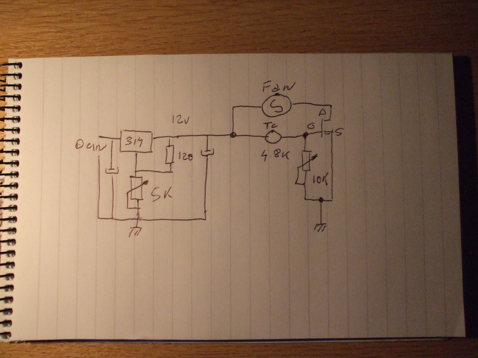

As I am planning on dubling the boards on a single heath sink I got a simple controll made up with parts you may have already if building the F5 that may came handy.
I have tried CPU fans and even the noisy ones are silent at 1/2 off V nominal
Just set pot for fan to start tiking over at wanted C the hotter the faster.
and it only start up when you want to so no long time waiting for temperature/ offset to stabilise.
I am Not shure about the next bit could some one cek the math please?
On the other hand you may decide that your normal listening level is quite low
say for example 6 V
6V / 8 (?) homs speaker impedence = 0.75 A The amplifier will stay in class A up to 4.5 W.
I have 4 homs speakers and 32V rails at the moment I have dubled the number of mosfets and current bias is set at 3A
I have decided on a listening level of 12 V and therefore 12/4 = 3
3X12 = 36 W class A
It will pump out much more than this as it leave class A.
One thing I have noticed sound is better at hier voltage.
Don't get me vrong F5 is already realy good but at 32 V rails is a bit more open a bit faster attack.
So fans are worth looking in to and you could use 2 in series and skip on the LM317 bit of the drawing

now we are talking cpu fan X3 in series tiking away at 70 %
This based on 12 V class A requirment on 4 Homs Puke speakers so 3 A bias.
