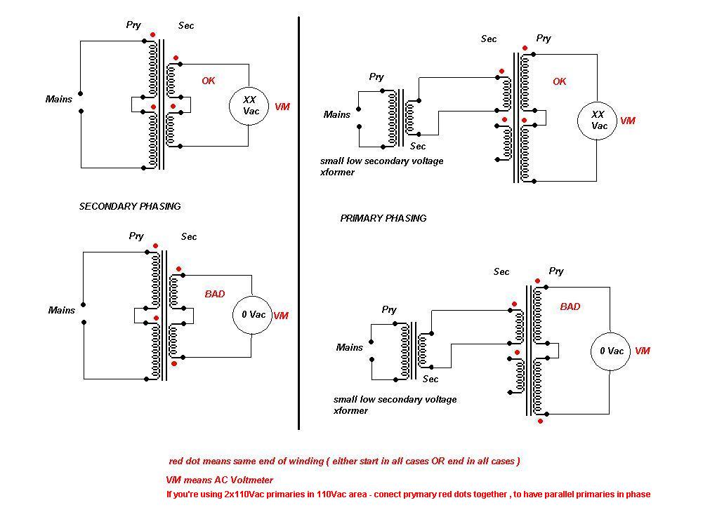

I connected one pair of primaries at a time to find out which pair of secondary windings to use.
I could double check, what method should I use to pair them up?
I don't know why they just don't use different color wiring to save a few headaches.
It most certainly does matter how you pair the windings, whoever you talked to didn't understand your question.
The transformer has 2 primaries and 2 secondaries. Each of those is a winding of a single wire around the core. Therefore you only have 4 wires around the core, with a total of 8 ends.
It's an Antek, so we know that the primaries are Red/Black, and the Secondaries are Blue/Green.
Also, we know that the primary leads are one black and one red. Also the secondary leads are one green and one blue.
Get your multimeter, and set it to continuity. (the setting where it beeps if you touch the probes.) put the probe on one of the black primary leads. Now touch the reds, one at a time. One will beep, that red is the mate to the black you are testing. Twist them together. Now double check that the other red and the other black also beep, and twist them. Those are now your 'A' and 'B' primaries.
Same thing with the secondaries - grab a blue, and test continuity to the greens, only one will beep. Those are mates, twist them together. Double check the other ones, and twist.
Get your multimeter, and set it to continuity. (the setting where it beeps if you touch the probes.) put the probe on one of the black primary leads. Now touch the reds, one at a time. One will beep, that red in the mate to the black you are testing. Twist them together. Now double check that the other red and the other black also beep, and twist them. Those are now your 'A' and 'B' primaries.
Mybe I'm not understanding, but I was going to twist both red primaries together and both black primaries together, to the power input. I am obviously getting confused and perhaps this isnt the connection being dicussed. My first F-5 is dual mono with 2 tranformers and that is the way I did them, black to black, red to red. OK, tell me where I misunderstood so my headach will go away! (I am finding the single transformer version to be more confusing than the dual one I built) Thanks for the help and the nice pictorial, helping in another way as well, this time I am using a single Daniels power supply board like yours and your pics answer many questions.
I think you are talking about the connections to the CL-60s maybe? which I havent yet installed. I can see this is where a few builds may have gone bad....
Well looking at the first watt schemo I see what you are saying about the primaries now...not properly pairing them up could result in a lot of havoc, especially where they cross over to the CL-60s.
