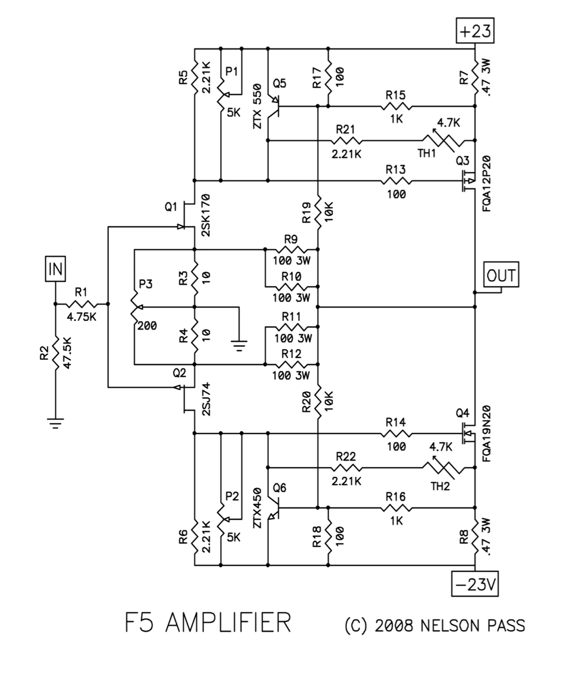

I'm having hard time finding in stock 200ohm 3W resistor to parallel up and get the ~5W rating for R9 thru R12 on 32V rail F5.
Would it be ok to place a 10K 3W resistors in parallel with the existing 100ohm resistors (R9~R12) to up the power rating, this results in 99.009ohm ????

No, that will not work as the 10k resistance is so high relative to the 100 Ohm that essentially all of the current will still go through the 100 Ohm resistor.
Allan, have you considered increasing the gain a la F5 turbo (using higher values for R9 - R12)?
For 200R 3W, I see some available in Mouser. For example: https://www.mouser.ca/ProductDetail...GAEpiMZZMsPqMdJzcrNwmqCbm4q8Q%2BCdWgGhACmRls=
They're pretty cheap and you can always get a batch and select them if the 5% tolerance worries you.
While you're at it, you might consider increaseing the wattage of R3 and R4. If my understanding is correct, even with standard rail voltage, at high voltage swing (say +/-20V, about 25W into 8 ohms), you are looking at over 1W peak dissipation. And with higher rails, that dissipation potentially can be even higher.

Hi Dennis,
no haven't thought of increasing the gain, let me read up on that and revert.. I'm sure I'll have questions.

Dennis,
Thanks for pointing out the gain, I will up to 220 ohm and increase R3 & 4 rating while at it 👍

First, I always start with the latest schematic. You can find that on the store page. I've also attached it.
Without understanding some of it, it's hard to know where to get "matched" parts, and which parts may need to be matched. IMO, the diyaudiostore.com has extremely fair prices on the parts that are harder to get and/or just harder to choose.
