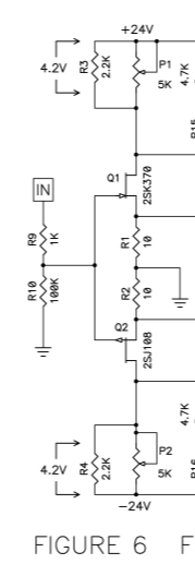

I breadboard this portion of the circuit. I could adjust the voltage across R3 but not R4.
Next I took both jfets out and replaced them with other jfets that measured about 12mA , and I could adjust both R3 and R4 to above 5 Volt.
Therefore I think low Idss maybe the problem

With the 7.8mA jfets, when I disconnect the V+ supply I was able to adjust the voltage of R4, that is the pot of P channel jfet.
This is really puzzling me.
Two jfets in circuit, only R3 can be adjusted.
Really need to understand why before I proceed to solder in the 12mA(not so closely matched) jfets.
Hope members can explain

I can get the amp to work with 12mA Jfets but not with 7.8mA Idss.
That is why breadboard that portion to find out the mystery.
Yes done already.Maybe try testing the jfets individually and see how they behave?
Disconnected V+ to test P jfet
and and disconnected V- to test N jfet

go back with P1 and P2; confirm that measuring across R3 and R4, you want minimum ohms there
replace R3 and R4 with 4K7
that will cover whatever Idss range of JFets you're using and - if everything else is proper, you'll be able to set everything
Are your jfets working? Since removing the jfets from the PCB, have you tested them individually, say just for Idss, and not in that partial circuit?
As others have noted, a working pair of 7.8mA IDSS jfets should not have trouble in an F5.
Yes R3 R4 increased to 5K1measuring across R3 and R4, you want minimum ohms there
and P jfet j74 still not conducting.
Jfets Idss tested again and all about 7.8/9 mA. That means they are not damaged. Also tested with 1K resistor and led.
Maybe need to modify input part for both jfets to work
