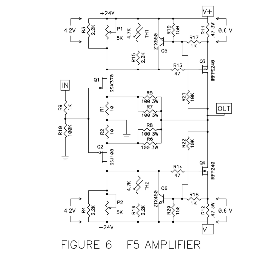

Hello,
Built F5 few years ago using this guide. Thanks to 6L6.
I used the board by designed by Cviller.
Recently while testing a preamp with F5, left channel was damaged.
So ordered jFet from Diyaudio store. I replaced the jFets, transistors and Mosfets
The problem now is that I can only bias R11 up to only 0.020V.
R12 can bias up to 0.6V easily.
Having spent many hours reading this thread, I also increased the resistors R3 and R4 to 4.7K
but still no changes, cannot bias R11 to 0.6V.
Voltages across R3 and R4 are about 3.6V.
Now at a lost of what to do next.
When constructing, everything works the first time I power up. Joy.
Please help. Thanks

Is there a load attached? If yes, then look for DC offset at the output, If no, then we have a mystery in that
the current through the outputs should be equal.
Work the bias pots until you get zero offset.
The bias pull against each other and need to be in balance… this balance is read as zero DC offset on the speaker output.
In order to achieve zero dc offset, R11 and R12 must be about 0.6V. But I am getting only 0.020V for R11. The Mosfets are not conducting, not warm.Work the bias pots until you get zero offset.

In order to get zero offset, the voltage across R11 and R12 must be even. If they were both at 0.1V, the offset would be near or at zero. If they were both at 0.2v, the offset would be near or at zero.
Does any amount of turns, in either direction, on P1 get anything other than your measured 0.02v across R11?
Turn P1 to max only able to get 0.02V. Turn the other direction I get 0V. P2 very responsive small turn can change voltage at R12 easily.
Look at voltage at R1, it's high,
should be about 0.07V
3.6V across R3 is too low, should be about 4.2V. This is the voltage to the output mosfet gate and too low voltage will not turn on the mosfet.
0.2V across R1 is too high, too much current.
Perhaps Q5 is faulty and passing too much current, diverting current from R3/trimmer.
Try replacing Q5, or at least remove Q5 and test it.
Removed Q5 still the same .Try replacing Q5, or at least remove Q5 and test it.
Could the problem is from the
Jfets? They measured 7.8mA.
The old ones were 10mA.
On my schematic I wrote down 8 to 12mA Idss. But I can't remember is this a requirement.
Not sure what you did.
If you removed Q5 and powered up, did you try adjusting the trimmer and measure the voltage drop across R3?
I missed it earlier but voltage across R4 is also 3.6V? But voltage across12 is correct at 0.6V. That is strange.
Not sure what you did. Did you remove Q5 and tested Q5? Or did you remove Q5 and powered up?Removed Q5 still the same .
