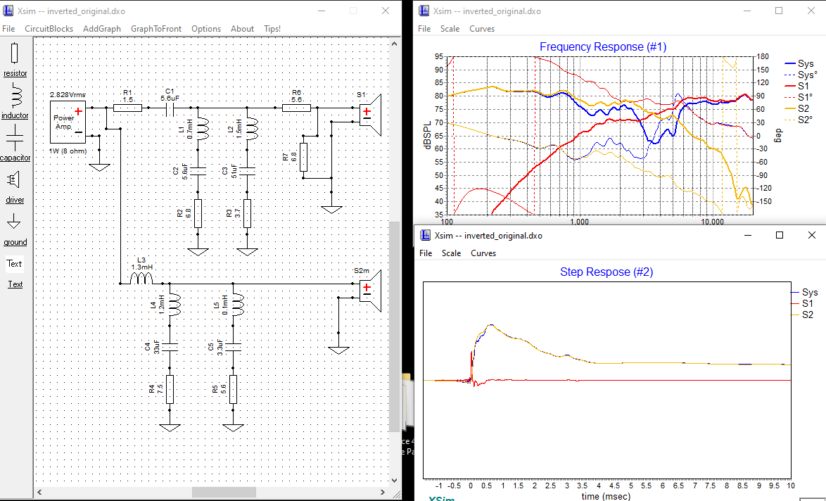

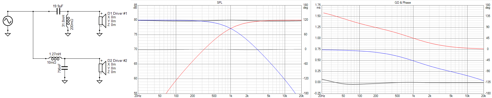

This is #1 case: First order / no time-coherent.
This is also the starting point. This speaker will then be converted to time-phase coherent later on.
As you can see from the attached pic below, it is basic a first order, with tweeter inverted, so it's not that too different from any other speaker.

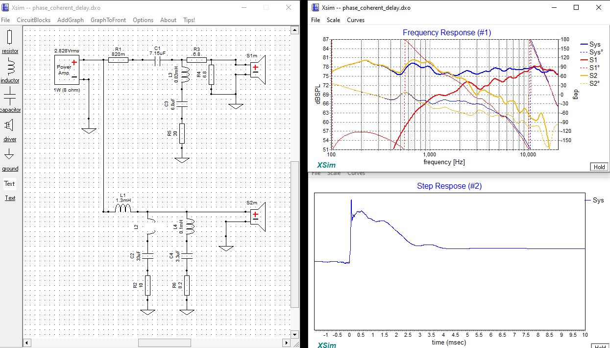

Case #2: This is case #2. Time-Phase coherent BUT no Time-Coincidence because it has excess phase toward 20KHz. It will produce a proper step-response.
First let's make the tweeter polarity positive. But now we have a dip at the xover point because of the phase mismatch. See the first pic.
One way to fix that is introduce a fix time-delay on the tweeter. For example, if the xover point is at 3KHz, calculate the phase mismatch, then dial in a fix delay on the tweeter so that the phase of the mid and tweeter would match at 3KHz. See the second attached pic. This can be done with DSP for example. But the problem is you end up having an excess phase at high frequency as you can see on the second pic. The consequence of this is the initial spike on the step response.
I think you may be able to see this on Troels latest speaker design. He uses DSP to adjust the delay on the tweeter. But his step response show a rather big spike on the step response.
Ekta-2D
I suppose this is OK, but we need a speaker that can meet #3 criteria! No excess phase.

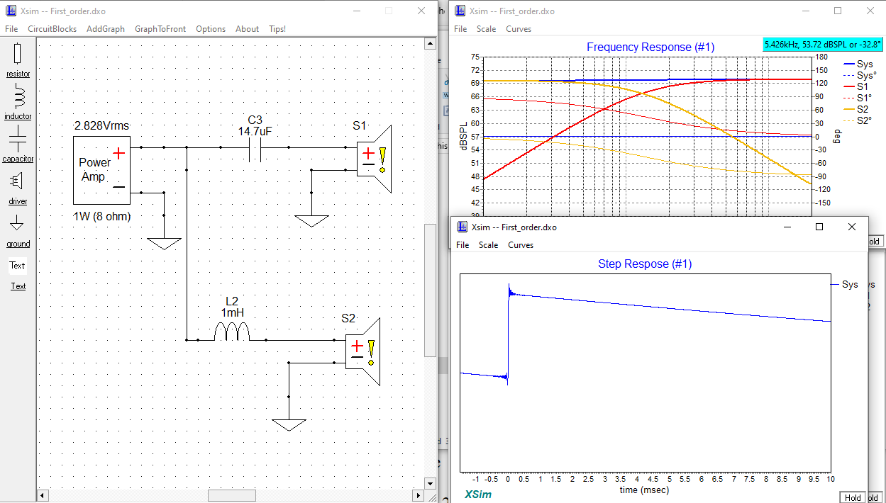

Let's look at an ideal first order time-phase coherent/time coincident - absolute zero phase from 1Hz to 20KHz.
The simulation attached shows an example. Notice 0 degree phase shift from 1Hz to 20KHz. Also notice how the tweeter phase and woofer phase track each other at 90 degree, but the overall phase of the system is 0 degree.

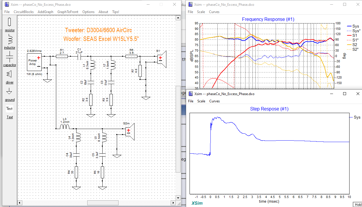

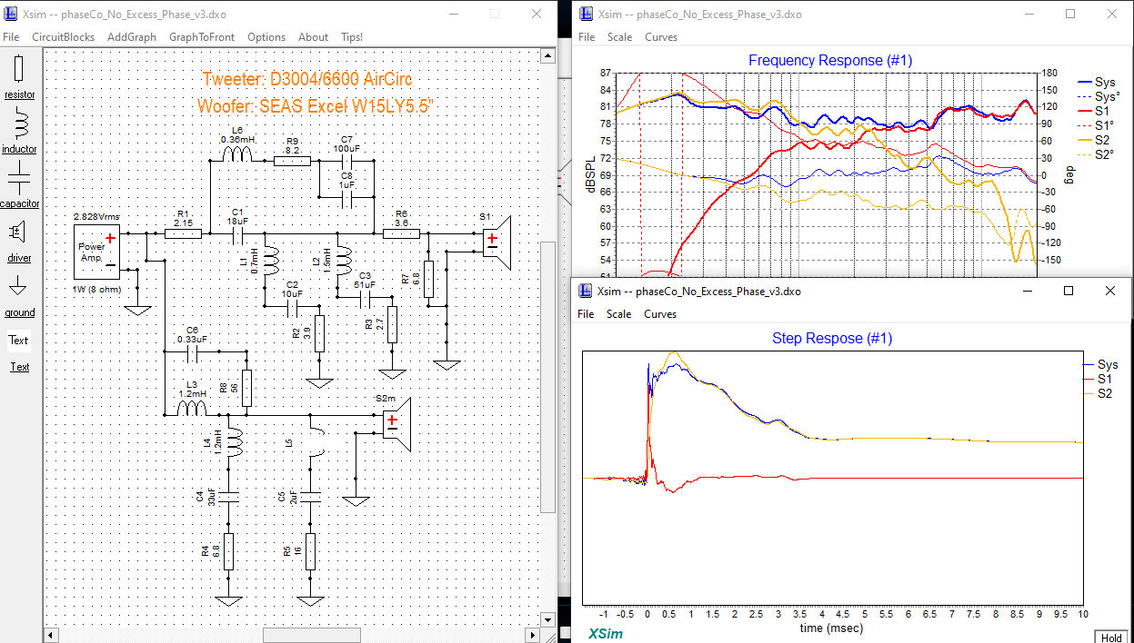

Case #3: Let's take a first shot at the original xover and convert it to time-phase coherent/time-coincident.
Notice the excess phase is very close to zero. Yes, ideally the excess phase should be zero, but in real world condition, it's very difficult. Maybe with modify baffle or some baffle tilting or tuning can help minimize the excess phase.
Compare to the non-coherent version #1, #1 has an excess phase of -180 degree.
But xover may be able to be fine-tuned to improve the phase matching at low frequency and high frequency.

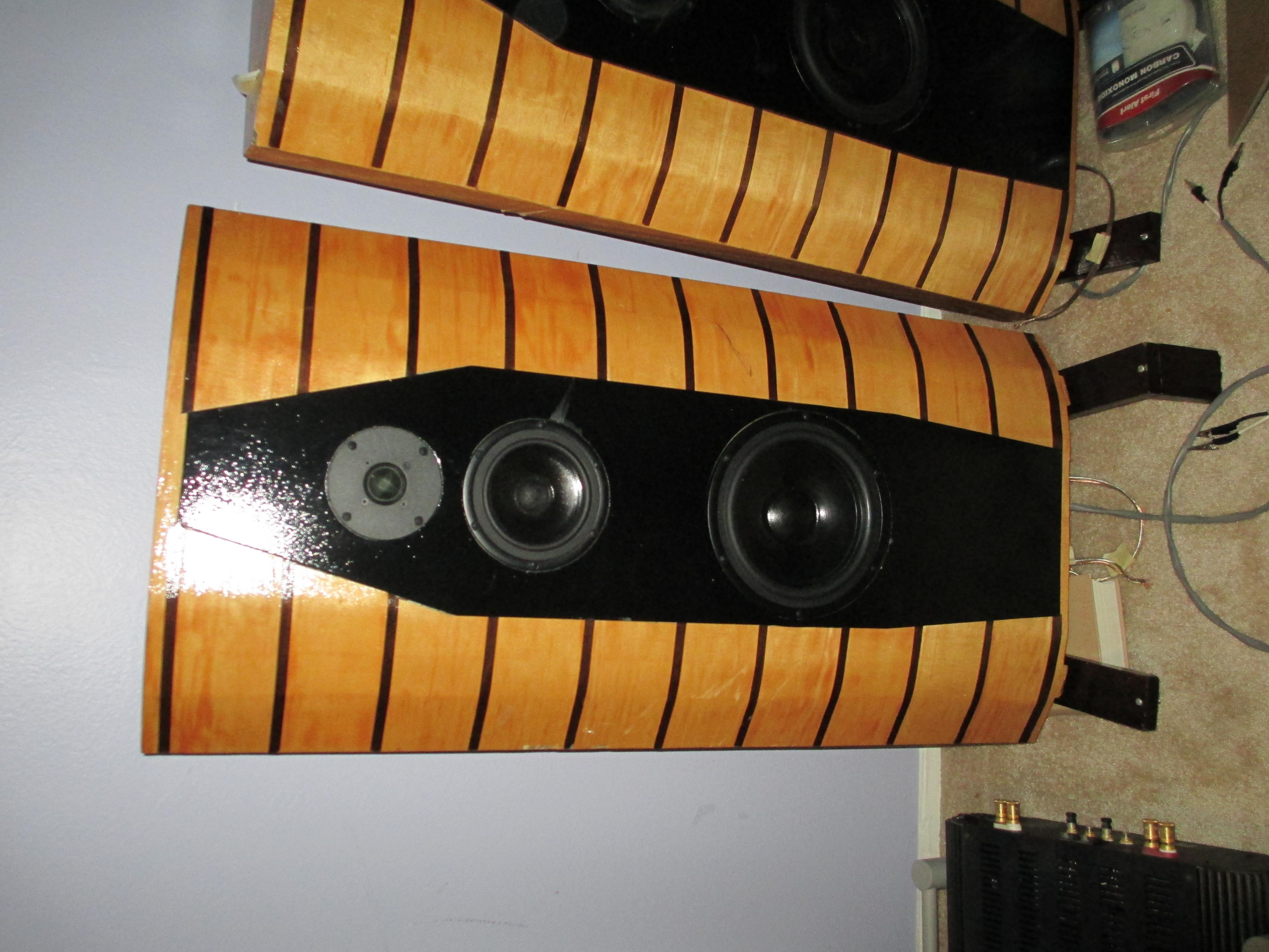

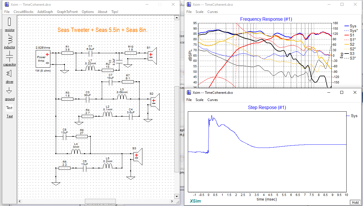

Case #3: Here's another example using a three way speaker. This is an old speaker I made awhile ago. It's not an ideal candidate to make a time-phase coherent/time coincidence but it serves to for an illustration. The cabinet has some odd diffraction so there quite a bit of ripples on the freq. response.
Drivers are Seas tweeter, 5.5in mid, 8in woofer.

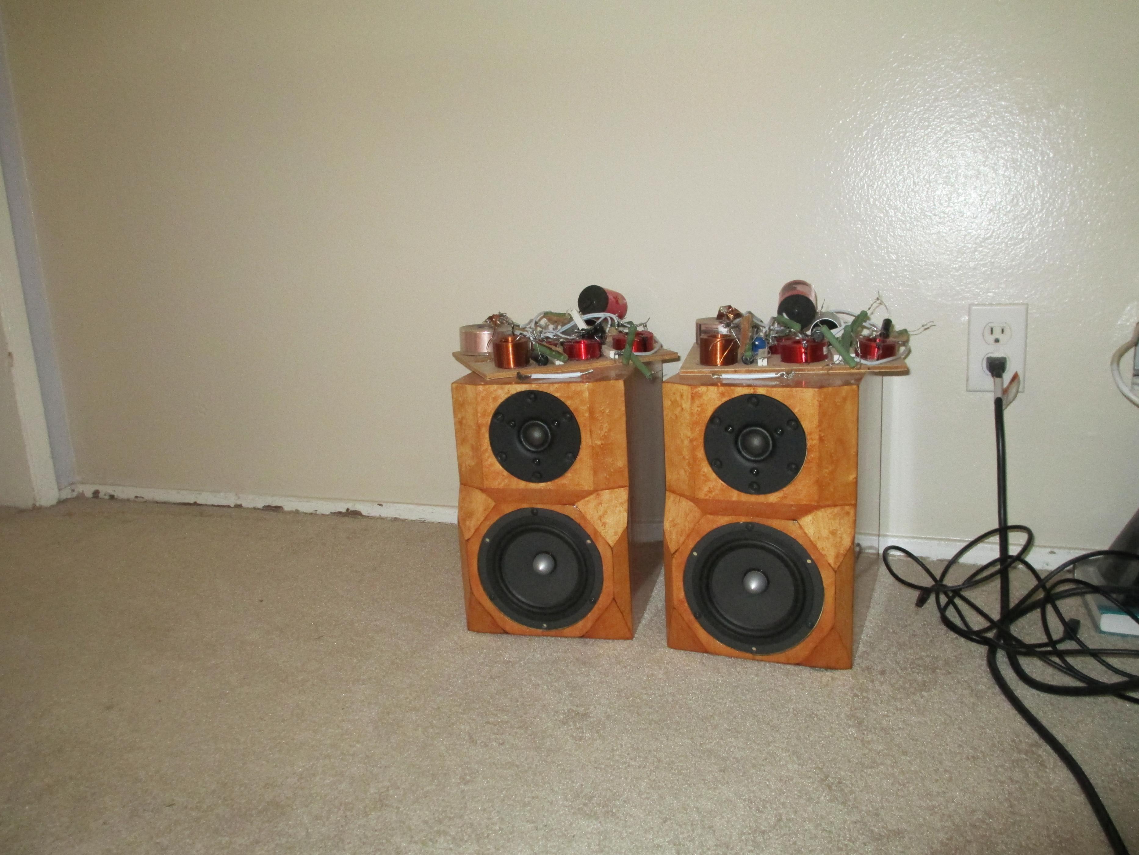

I will use one of my project to illustrate the misunderstanding. See pic of speakers here:
IMG_0693 | Andy VJ | Flickr

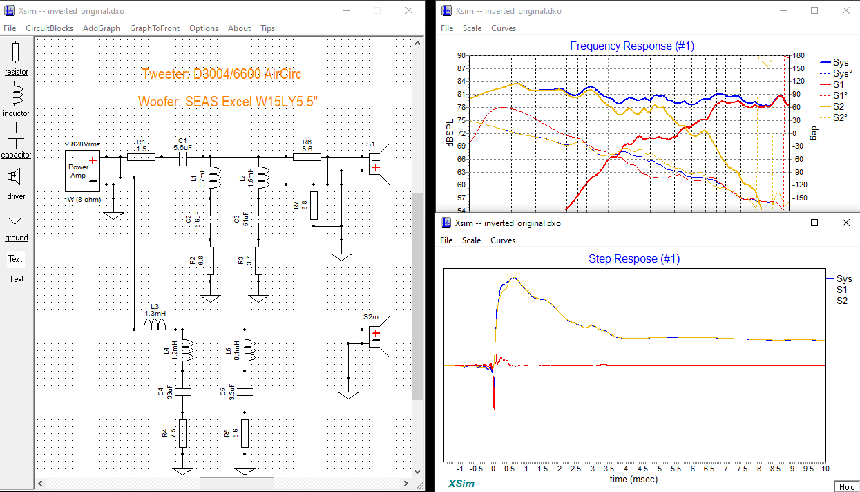

Below is the xover design. Notice the tweeter is inverted polarity and the woofer is positive. Also notice the step response on the lower right corner. Also notice the phase of the speaker response on the upper right corner of the plot. That is the phase starts at about 0 degree, and gradually go to -180 degree. Also notice each individual component freq. response and the cross over point.
Inverted_overall | Andy VJ | Flickr
At first glance, the tweeter seems to go completely opposite of the woofer (the initial dip of the step response). The time-coherent proponent will say – wait a minute, that’s all wrong since how can the treble be completely opposite of the woofer? But that is not quite right. The tweeter ONLY opposite of the woofer at very high frequencies, but at low frequencies, below the xover point, the tweeter and the woofer actually go up together.
I here have a zoom in pic of the step response. You can see the tweeter and woofer go up together after the initial high frequencies. It’s subtle but it’s there and it’s very important.
Green – system
Red – tweeter
Yellow - woofer
inverted_stepResponse_zoom | Andy VJ | Flickr
What does this mean? If you look at the frequency response below, you see that the phase of the system is only at -180 at 20KHz, not the entire plot. But below the xover point, the tweeter and woofer are more or less “in-phase”. For example, at 2KHz the phase is only at -60 degree, at 3KHz the phase at -80 degree. As I said before, since our perception is not very sensitive at high frequencies, most of us may not “hear the difference”. Most of the musical contents occurr below the xover point which is about 3KHz in this case and that’s where most of the phase shift has not occurred.
Also the phase change is not at a constant -180 degree everywhere but only at exactly at 20KHz. For example, the phase change at 20KHz is only a few degree vs. 19KHz and likewise 19KHz is only a few degree vs. 18KHz … and so on. It’s a gradual shift in phase so our hearing may be able to adjust to it.
But on the other hand, if this -180 degree occurs at 500Hz, trust me, you will definitely HEAR it! I think high order can get away with it because the phase shift occurs at high freq. where our hearing may not be so sensitive.
Overall_inverted_freqResponse | Andy VJ | Flickr
