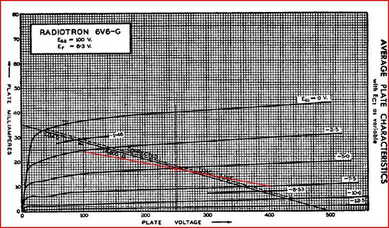

I'm playing with drivers myself today. I'm using a 6V6 at 150V on the plate and getting about 240V Pk-Pk swing at clipping. I only need about 120V pk-pk today, for a Schade-feedback G2+G1 drive amp using sweep tubes, but I want some headroom for later. I'm using a gyrator which has a high AC impedance to set the plate voltage and a 10K ohm test load to simulate the Schade feedback. I haven't measured the distortion yet and will probably plug in the sweep tubes now that I have the driver debugged.
Michael
PS the load line below is what I'm proposing for about 110VRMS swing. It would need another 30V B+ or so to cover the CCS Vds
I'm trying to get my 110VRMS drive off of a line level signal, which means I need a stage gain of around 70. This means really high Gm, and a 6V6 wouldn't do it.
This is where I am at the moment, but if I can't get the driver THD down under 1% @ 110vrms with a gain of 70 I'll resort to a lower gain driver and add a stage.
I have a few more tests to run before I've exhausted the options for a single-stage driver. It's a lot to ask of a driver, but if I can figure it out a 2-stage amp will be preferable to 3-stage. A neater, more elegant solution. Too often I see amps with anode loaded triodes just stacked 3 and 4 deep and wonder if the designer actually looked at the gain structure that was needed or just lined up their favorites.
**edit**
I just put my glasses on and had a look at the 6V6 loadline above. Maybe that would work. Gotta sling that together tonight & see how it measures.
6V6 as driver
Itried out the 6V6 as a driver today.
B+: 600V
Rl: 20K
Rk: 220, unbypassed
Eg2: 110V
Ep: ~245V
Ik: ~0.020
Gain: 44 (exactly where I need to be)
The THD at 110vrms was 2%, exactly what I got from the 6J9 and 6J52 tubes. The 6V6 did get all the way to 170vrms before it clipped (5% THD) so that's better. The smaller tubes clipped at around 130Vrms.
2% THD isn't really bad, but since the output stage is only contributing 0.9% at that level I'd like to find a way to do a little better.
I suppose I could try raising Eg2 and Rk and rely on the extra degeneration from the bigger Rk to linearize things, but then I'd be giving up gain.
Maybe a 6BQ5, but I kinda see a pattern here...

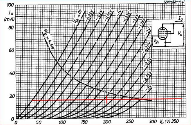

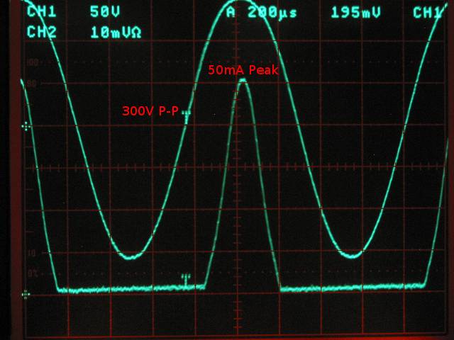

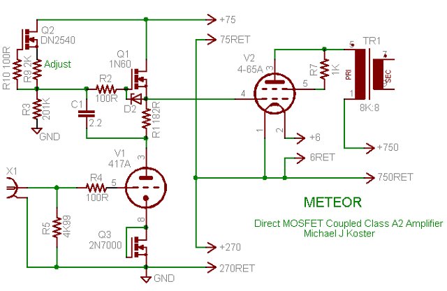

I did a similar thing with a 5842 that would swing 300V P-P at close to 1% distortion to drive a transmitter tube in triode mode whilst sourcing 50mA of grid current; the D3a would give you a little more voltage headroom and with cap coupling a CCS would be a simple way to get huge linear swing.
Michael
PS I just thought of another way but 2 stages of DHT with anode chokes is probably not what you had in mind...

I've done a little fooling with the CCS* loads and the Russian driver pentodes. I made up a little board for the CCS with screw terminals for in and out, a trimpot for current adjustment and a heat sink.
First test was a Russian pentode, the 6J52P. This is a $5 10W unit (Gm = 50,000 - 60,000 in Pentode).
I triode strapped it and ran it with the CCS off of a 400V supply. It seems to like 7.5 to 12 ma of current and 210 - 240V on the plate. Not really fussy. Anywhere in there gives you 110VRMS out with THD at 0.85% to 1%. That should be pretty easy to set up, as the CCS has about a =/- 5% tolerance on the current for a particular setting resistor. Shoot for the middle (say, 9.5ma) and use a trimpot in the tube cathode to set the Ep to around 220V and you're done. I shifted the driver current and plate voltage around by 20% and the THD never goes over 1.5%, which is still reasonable. This will not be tweaky for someone without a THD analyzer to set up.
The gain is an amazing 73 (1.5V in for 110V out). That may go down when it's swinging current into a following grid resistor, but that's OK. Gain of 44 or better is what I need. A 6SL7 certainly won't give you THD that low at 110V.
So there it is. A driver that consumes less than 4 watts total (15% of the output stage's power consumption), and has THD equal to the output stage (just under 1% for each stage). And the whole shebang, both stages, runs off of a 400V supply. No screen supplies or bias supplies.
