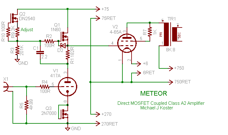

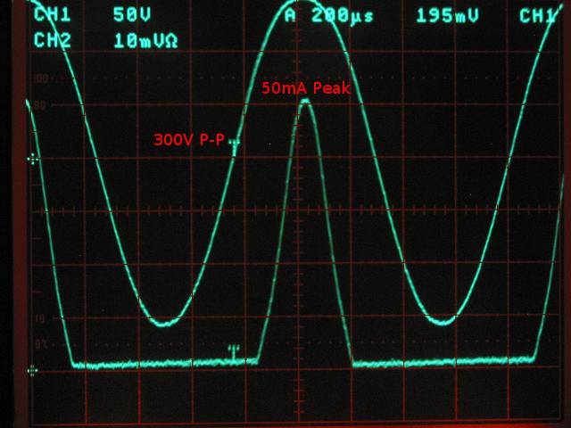

Whatever driver this output stage uses is going to have to be direct coupled to provide the grid current for the positive swing. There are several schemes for doing this in Class B PP tube amps. One of the simplest is the Altec 1570B driver. A center tapped choke is used as a load for 2 6W6 configured as cathode followers. The cathodes are direct coupled to the output grids and the choke center tap goes to the negative 'bias' supply. The CFs of course have no gain so they'll need a ton of drive voltage, the 350VPP that the output tubes require plus their G1-K signal, so probably nearly 400V p-p. For a center tapped choke you could experiment with the primary of a PP OPT, but 2 separate windings (for output stage bias balancing) would be better. That much voltage swing would be available from your 550V + rail. Something like a 12BY7 with resistive load should work as a voltage amp. Then a phase inverter/input stage like a LTP ahead of that. I have no idea if that's optimal but it looks OK on paper.
Yeah, what he said...
Elliano's scheme with a chipamp and high ratio step-up might work for squeezing 3db more out of a 300B but it won't cut it for a real power grid tube. The problem is going to be DCR of the transformer if nothing else.
Direct Coupling with a low impedance device like a voltage follower using a high gm tube or MOSFET is the only way to avoid the kink.
I would retrofit a MOSFET follower (see tubelab Power Drive) between the stepup and power grid and be done with it.
Michael
PS a follower arrangement (stacked mu-follower) for power grid drive, and the grid voltage at 300VP-P (top) and grid current at 50mA peak. No kink.

Michael, what's the deal with Q3, random (part selection dependent and temperature dependent) bias voltage generator ?
It's called surprise bias ;-)
No, seriously, the Vgs of these are amazingly stable and consistent, and have pretty low impedance. It makes a nice 2.8V diode. It's also a great conversation starter.
I suppose a boring old TL431 would work even better but I was out of them and this is what stuck to my hand coming out of the parts box.
Q2 is more of a drift problem and if I built this amp in a box I would come up with a more stable generator and a series 220K resistor...
Cheers!
Michael

You can use the existing transformer for voltage gain AND source followers to power the grids. just put the source followers between the transformer secondary and the output tube grids. You'll also need a negative voltage and pull-down resistors. Stopper resistors on the MOSFET gates and zener diodes to prevent going over +15V gate-source.
IMO this would be a quick and simple way to get the "kinks" out of your current circuit operation.
