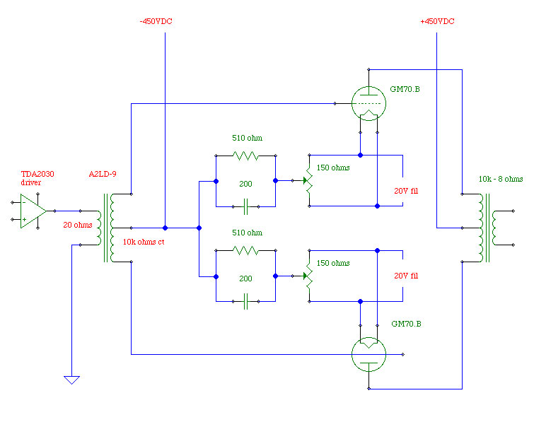

I wish to make a stereo tube amplifier for my copper speakers, used in my camp at Burning Man. I would like to share my first steps here as this is the first PP amp I have built. I would very much appreciate your comments. Please go to this thread on the copper speakers. They were outside at Burning Amp 2009.
This amplifier will need to be simple and robust. It will need to generate ~70-100W of audio power per channel. To easily obtain this, I have decided to go Push-Pull.
Output tubes: I can go two basic routes- parallel push-pull using quartets of more common tubes (807, 6550, etc), or transmitting tube pairs (211, 813, GM70, etc).
My camp has power. I can get up to ~6 amps provided to run the amplifier.

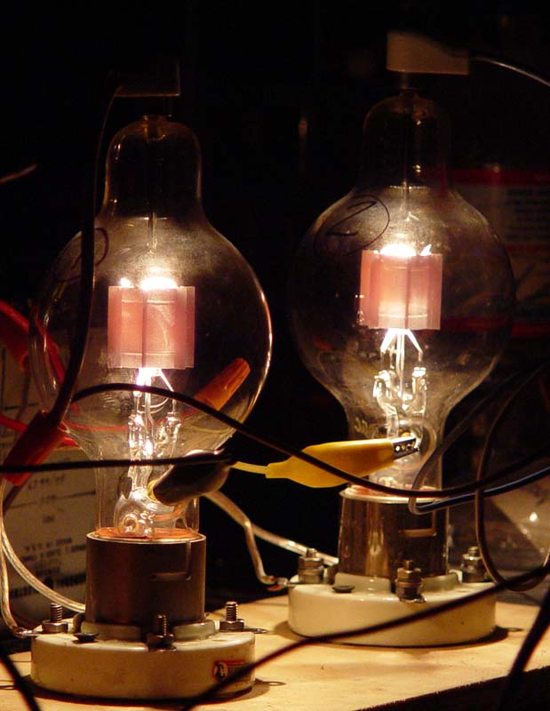

I am favoring the transmitting tube route. Thoriated filaments would fit the 'Burning Man' theme. They would look very cool!
Of the thoriated tubes, the GM70 and 813 are easy to obtain and relatively inexpensive. I had some GM70's on hand and built up mono breadboard. B+ set at 900v. I chose cathode bias. I biased the GM70's for -70vdc. Each tube is drawing ~70 mA at this bias point (140 mA total). Total power consumption for this breadboard is ~255 watts.
I am using Jack Illiano's idea of using the TDA2030 amp chip and purchased his driver/splitter transformers he designed for this chip. This driver might not be used in the end, but it was easy to build for experimentation. Attached are the amplifier and power supply schematics. I am using a borrowed Edcore 10K 100W output transformer. No neg feedback yet.
Here are the THD measurements at 1kHz, into an 8 ohm load.
5Vpp (~0.38w) 0.48%
10vPP (~1.6w) 0.54 %
20vPP (~6.0w) .72%
40vPP (~24.8w) 1.9%
55vPP (~47.3w) 2.5% -just before clipping.
It takes a ~2.5v peak to peak signal to take the amp to max output (55V peak to peak) before clipping.

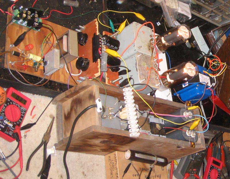

I hooked it up to one of the copper speakers and it sounds OK! I did a quick scope frequency response at mid-power (25w). Flat up to ~16kHz, then slowly tapers off.

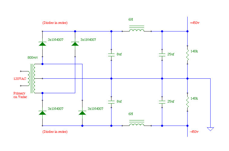

The power supply- I got a tip from a local builder (Thanks, John!) to use a bi-polar power supply. It works very well. It also makes for easier parts sourcing. I get ~2vPP ripple under load. I am also using AC on the filaments. Yet hum is negligible in the speaker, thanks to push-pull operation.
Other driver ideas would be to do the normal phase splitter route. I would like more efficiency and power, I might try 813's or 828's in UL mode. Experimentation continues.

I was able to crank up the bipolar supply to +550v, -550v and achieved 70w just before clipping. But the amp is sucking serious power to achieve this, approaching 300w, and this is for just one channel!

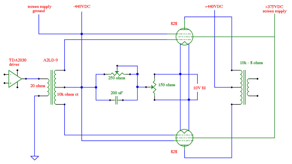

Been quite a while since I posted, haven't had much time lately.
I experimented with 828 tubes. First, ultra-linear; then in pentode mode. Circuit is the same as the GM70 PP, just replaced with 828's and hooked up the screens and suppressors as necessary.
The UL setup sounded grainy, and had limited power (~35w), though bass response subjectively sounded better than the GM70's. Seems the 750v screen limit restricts power too much. I did not take detailed measurements.
Pentode mode sounded better. Screens fed with 375V (the max my other supply will go), plate ~980v. Set up the bias to -34v. 1khz signal 2vPP input. Plate current for both tubes was ~180mA. Screen current for both tubes ~22mA. I got ~60vPP (~56w) into an 8 ohm load before clipping. At this point, my screen supply developed a problem and I could not take distortion measurements.
Subjective listening impressions-
Ultralinear sounded 'sharp' and 'tizzy'. More bass that the GM70's. In pentode mode, the bass control is even more pronounced, and the tizzy-ness has decreased somewhat. Still, the GM70's had a smoother sound to them.
Attached is a pic of the circuit and some scope shots. Though you can barely see it, there is some slight 'lumpiness' to the sinewave. The peaks become slightly 'triangulated'. This seemed to occur when the control grids started drawing current. Looks like the 828's don't like that; at least in this circuit. Also attached is a scope pic of the setup w/ a 10kHz signal; one can see this effect better.
At this point, I am considering wrenchone's advice and go with more modern oxide cathode tubes. I found out that my amp also will do sound duty for a nightly mini-cinema. As the amp will be under the movie screen in front, bright tubes don't work too well with projection!
Pete Milletts' sweep tube amp <http://www.diyaudio.com/forums/tubes-valves/151206-posted-new-p-p-power-amp-design.html> circuit looks like a possible route if I abandon TDA2030 drive. I still like the TDA drive for it's simplicity. If it dies, I can easily swap in a fresh driver board.
I picked up some 829B's recently. I will experiment with these next, tying the two sections together. Maybe play with a few sweep tubes as well.

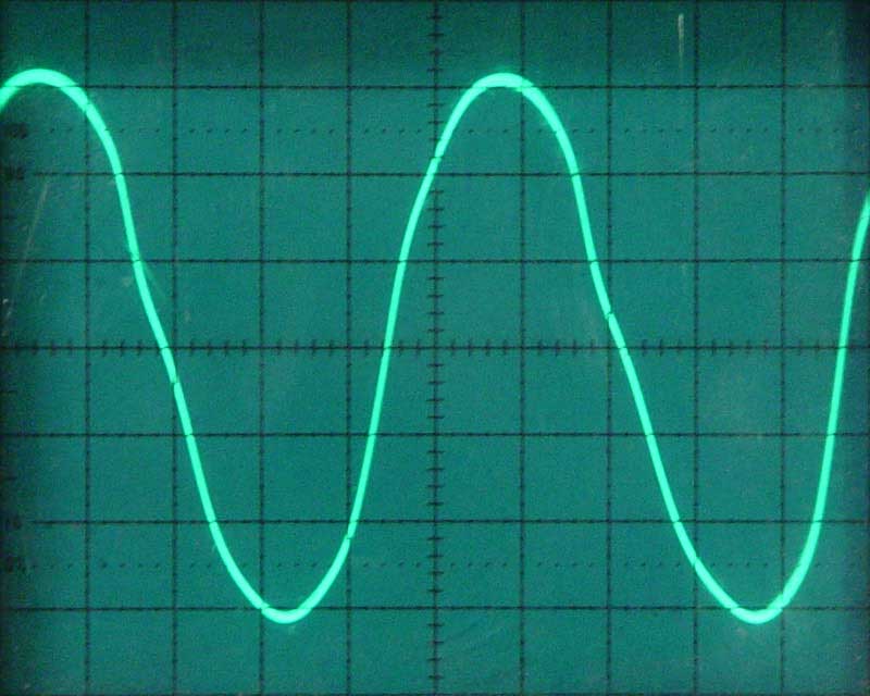

I had some time to play with the amp in early May. I was having some fun tube rolling; Eimac 100TL's, Svetlana SV811-10's, 829's; even tried some old 852's (couldn't, one turned out to be gassy).
I realize now that the limitation of power is the TDA2030; it doesn't put out enough voltage swing. After the interstage/splitter transformer, I get 240V PP per tube. For driving big triodes into A2, I need more. So a bigger chip amp? Well...

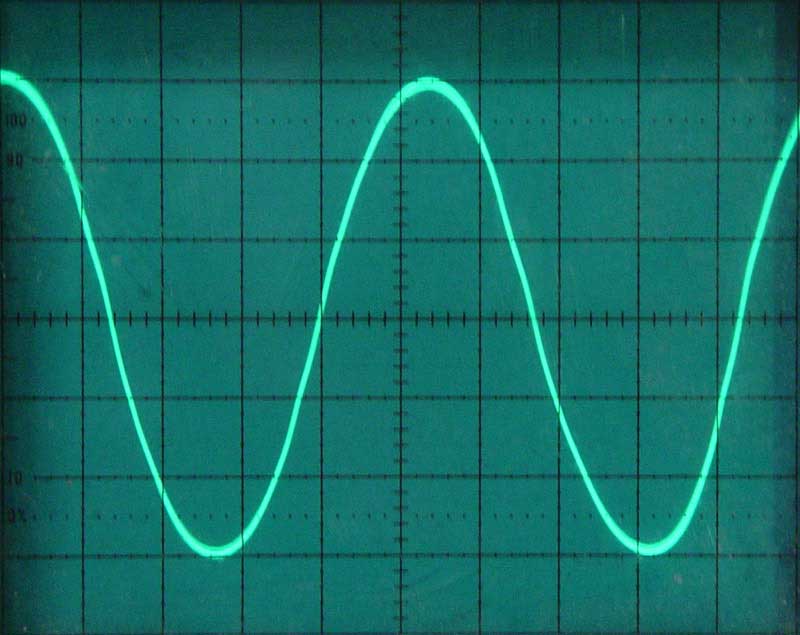

I think I discovered a problem using a chip amp as a driver: it doesn't like the abrupt impedence change the tubes present it going into A2.
I put a current sense resistor from the interstage tran primary low side to ground. Connected my scope ch2 probe on the high side of the resistor to see waveform when the output tubes went into A2. Ch1 connected to my output load resistor.
Please refer to the 'kinks' in the scope pics in the post above.
Looking at these two waveforms together on my scope, I noticed that the kinks in output waveform happen at the same time when the tube goes into A2.
To describe image in words: As the sine wave trace goes up, it changes angle abruptly, peaks, then changes abruptly again as the trace goes down. These kinks in the sine wave occur on the same y-axis as the current starts to flow to the grids. This repeats in the negative part of the output waveform; the effect is symmetrical.
Upon closer examination, the downward slope even has a little oscillation.
When turning down the input signal to where grid current stops, these 'kinks' disappear.
I am sorry my description is so amateurish, but I'm not an EE and I didn't take pics. The amp is apart now. I don't know why I didn't notice this effect before. I could have damaged the TDA 2030, but it worked fine as long as output tubes stay out of A2.
So it appears that there is a flaw in using chip amps to drive big tubes. I will explore other driver ideas. I might try tubelab's source-follower power drive.

This setup:
2.2% THD at 100VRMS out
5% THD at 130VRMS out (185V peak out of a 200V plate voltage)
I love triodes but you just can't run them to the rails like you can a pentode.
It's been all pentodes all day here. Here's some promising results on the Russian 6J9P (similar to 6688/E180F):
400V B+
200V plate
160V screen
1.6V bias (105 Ohm unbypassed Rk)
15ma plate
13200 Ohm plate load.
Pdiss = 3W
1VRMS input
71VRMS output
Gain = 71
THD = 1.1%
This is about where I need to be for a driver. It's pretty amazing to be swinging 100V peak output with 1.1% THD off of only 1VRMS input. I cold probably get the THD under 1% with a little more tweaking but this will do for now. You could drive just about ANYTHING with this.
