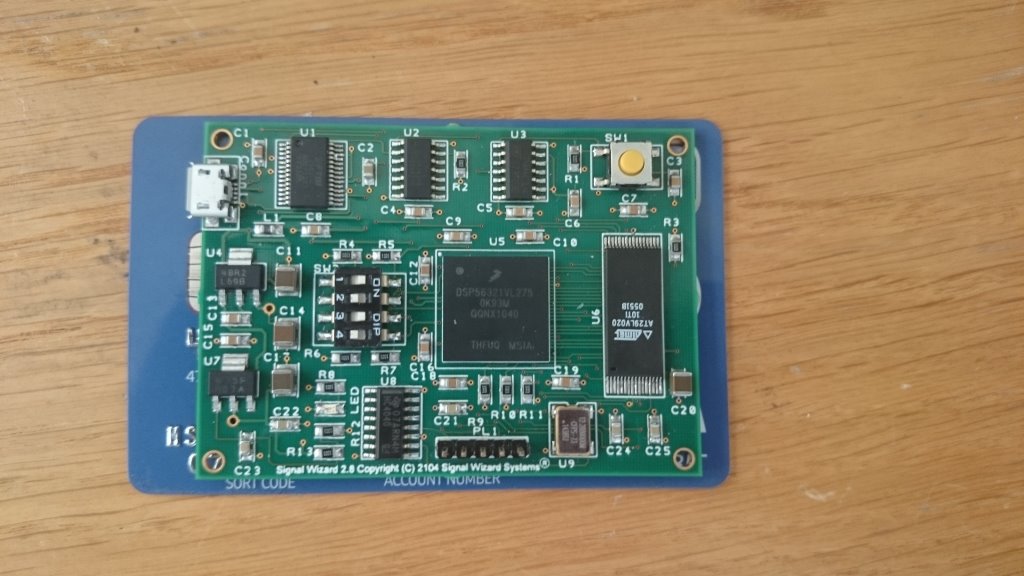

Hi Binely,
Thanks for the thumbs up!
We are putting our DSP board inside every active speaker (not in the passive ones) & when combined with WiSA opens up a new world of possibilities ....Smart loudspeakers that can "talk" to one another and alter parameters to suit location and audience....
Touring as well as fixed venue locations vary in acoustics, even cinemas acoustics change from almost empty to having 1,000 bodies in there....
I have attached a pic of the prototype board and we are now upgrading the DSP chip to this TMS320C6748 | C674x Low Power DSP | Fixed/Floating-point | Description & parametrics
and the software and functionality is an upgraded version of the Signal Wizard 3 system here Signal Wizard 3.0
Happy to brainstorm and listen to suggestions as we will be releasing a version of the DSP with an electronics pack to the custom install market and a version to the DIY community.
Cheers
Derek.
*Derek, just read your post above and it looks like a lot of what I just typed below was part of your prior art. Apologies - but will leave them below as a "Thumbs Up". Bravo.
Am I reading this right - the idea of discrete dsp's in the unit? I wonder if they could even be made to "talk" to each other if you were using wireless technology anyway - master clock and all.
Perhaps with the right implementation, a setup mode could be used to have them calculate the distance/time between them to setup some sort of check bit system in the clocking that is only intermittently confirmed through a signal in the "noise" spectrum.
In a non-ideal placement what of a reinforced "mono" mode instead of stereo. The two channels could be combined, with one monitor primary, the second one fill in.

Andrew - I think we all are excited for a lively discussion about a real implementation. What were your ideas?
Nobody is requiring a demonstration of understanding for a contribution at this point. A lot of brainstorming right now. Ideas can be vetted, proven unworkable as we go.
Best wishes! You are welcome here.

I haven't had a chance to look at your little board but that looks very interesting to me. I will read what you put up and ask questions afterwords.
DSP and DAC implementation is all new to me. I was reading a bunch of notes on the TI site last night but I don't think perhaps they have the most elegant solutions, I am trying to play catch-up here on this subject.
One area that is out of my wheelhouse is the software used in these applications to control all of this and implementation of FIR filtering, time alignment, eq, xo and all the other bits we need to make all this work. And then there is the control of level, do you just leave that up to the source component or do you have a remote controlled volume, balance and other things in the digital domain inside a powered speaker or leave well enough alone and make all that fixed in the speaker? USB streaming from a computer source is one thing, but what of a memory stick where you have to select songs and convert that information on the stick to an analog signal, this can get complex if we add everything in the tool kit into a powered speaker.
I assume if we are going wireless that we need to make one of the speakers a master and the other a slave so we have a stereo system or is there a way that they can both be masters and communicate to each other which is which, I am only thinking that because someone may wants to add extra speakers and create a 5.1 or even a 7.1 system?
By the way, off topic, what ever happened to the 9.1 systems I read about in the past for movie theaters, adding two more channels to give height information to the front channels. did that ever happen and is it only for projection screens with coding on the digital masters theaters would get? I know way off topic but I keep wondering about that?

Do you have an idea of cost on that small dsp board and the added cost of adding the Wisa wireless system? I'm curious. You can send that information to my as a PM if you like.
