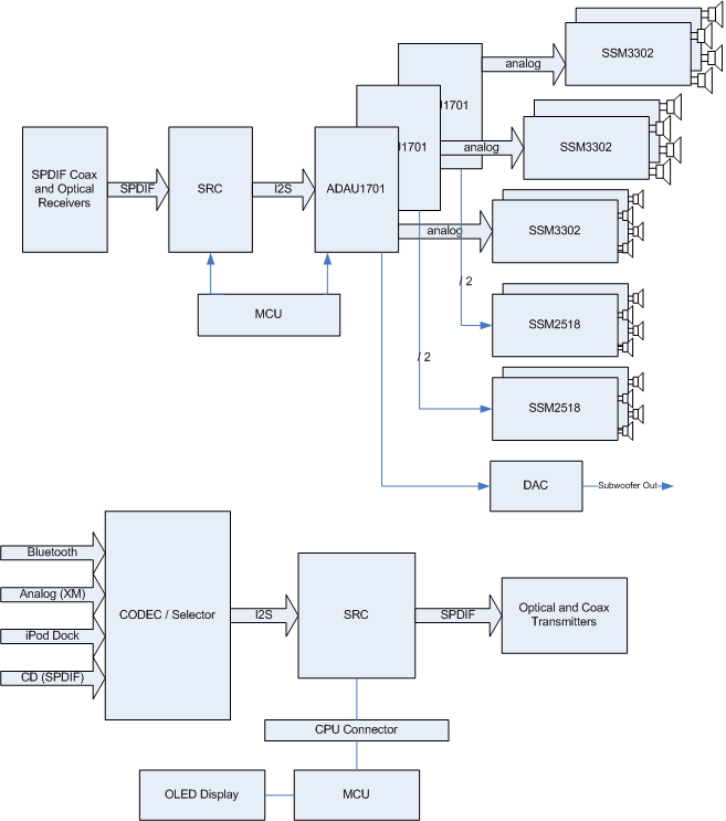

After all, it's a 20-channel Amp/DSP design for a line array with software-programmable curvature (delays on each channel). I think it would make more sense to talk about the line array aspects in a line array or HE forum, and to discuss the DSP/Amps/thermal/interface issues in an active speaker forum. The fact that it is a multi-way speaker seems a bit superficial compared to all of the other interesting issues to discuss.

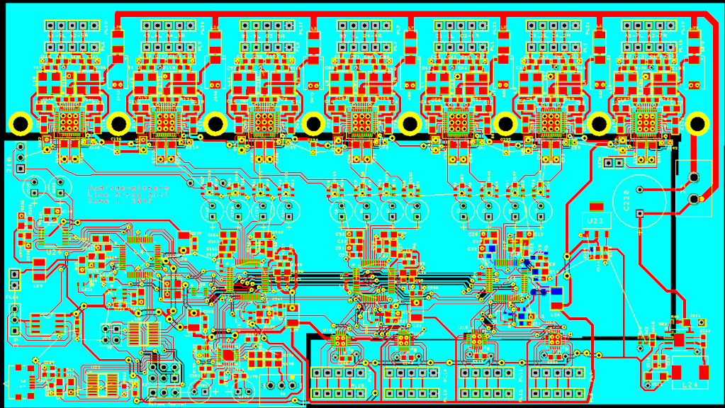

The last active speakers I made had Bluetooth audio. The picture shows a plate amp with two 20W ADAU1592 amps and a programmable analog crossover with BSC. The Bluetooth module is on the left.
Bluetooth audio is quickly replacing the iPod dock. Whether or not you approve of lossy streaming audio is irrelevant--it actually works very well and there are many people who find the quality quite acceptable. Bluetooth audio is expected to be a multi-billion dollar market and there are many experimenters who want to DIY this capability.
