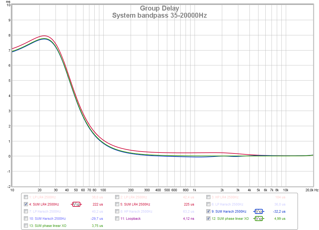

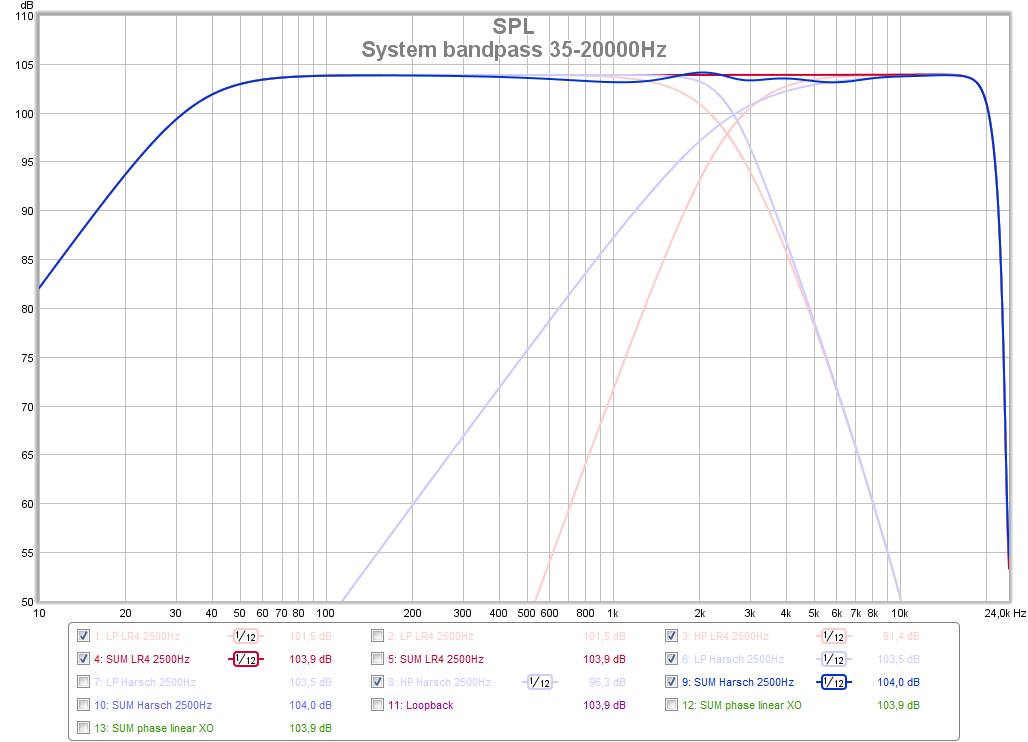

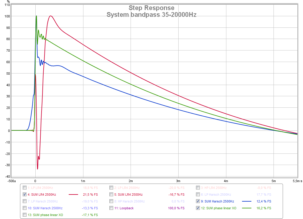

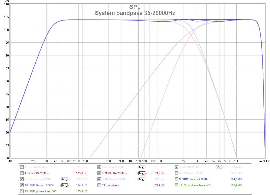

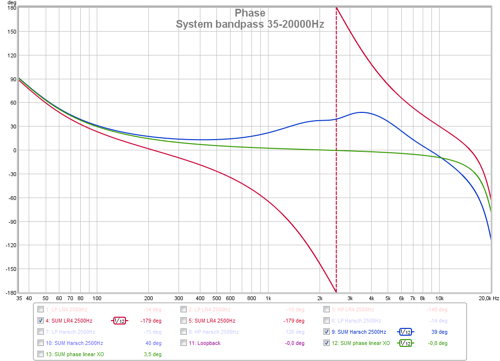

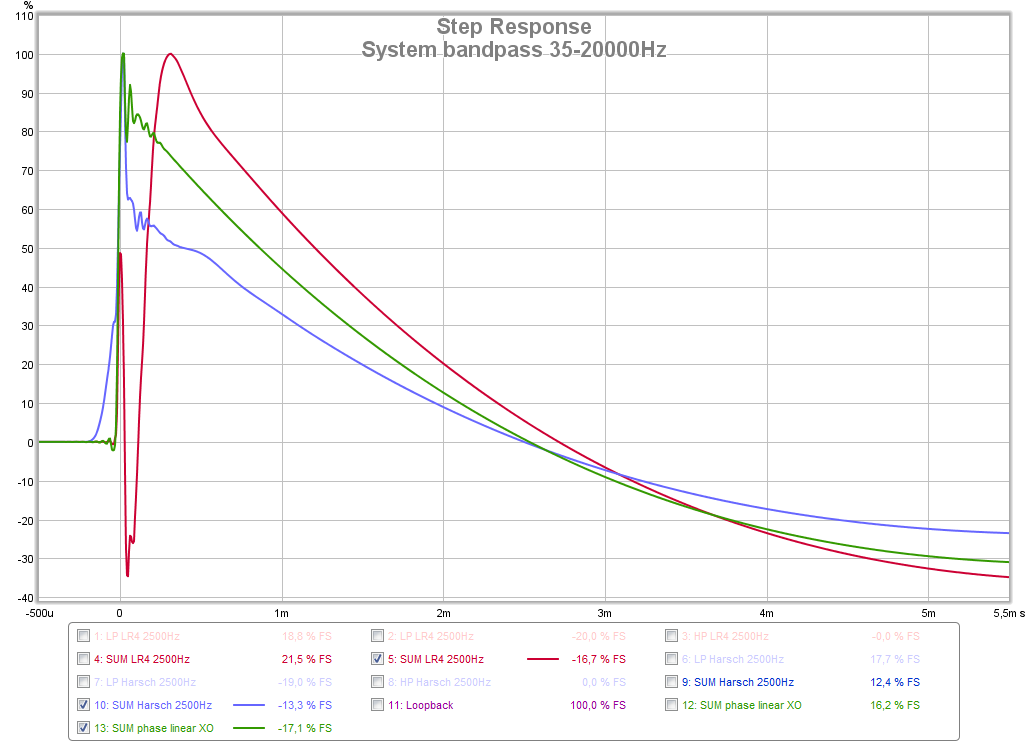

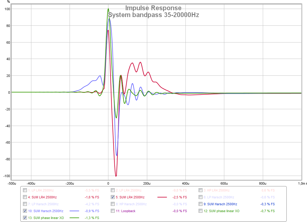

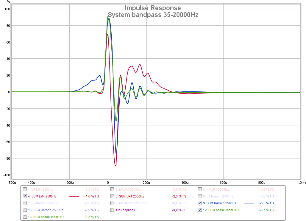

Visuals 🙂...
Pure electric filters to replica speaker system bandpass IRR 35-20kHz, plot 1-5 have system HP as BW2 plot 6-10 have BW4, XO point 2500Hz shown with FIR LR4, IRR LR4 and IRR compromise Harsch XO type.
Link: http://www.diyaudio.com/forums/multi-way/277691-s-harsch-xo.html#post4402917.
Filters set in JRiver DSP engine REW listening in soundcard loop.

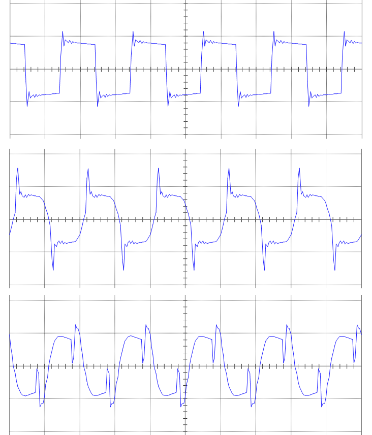

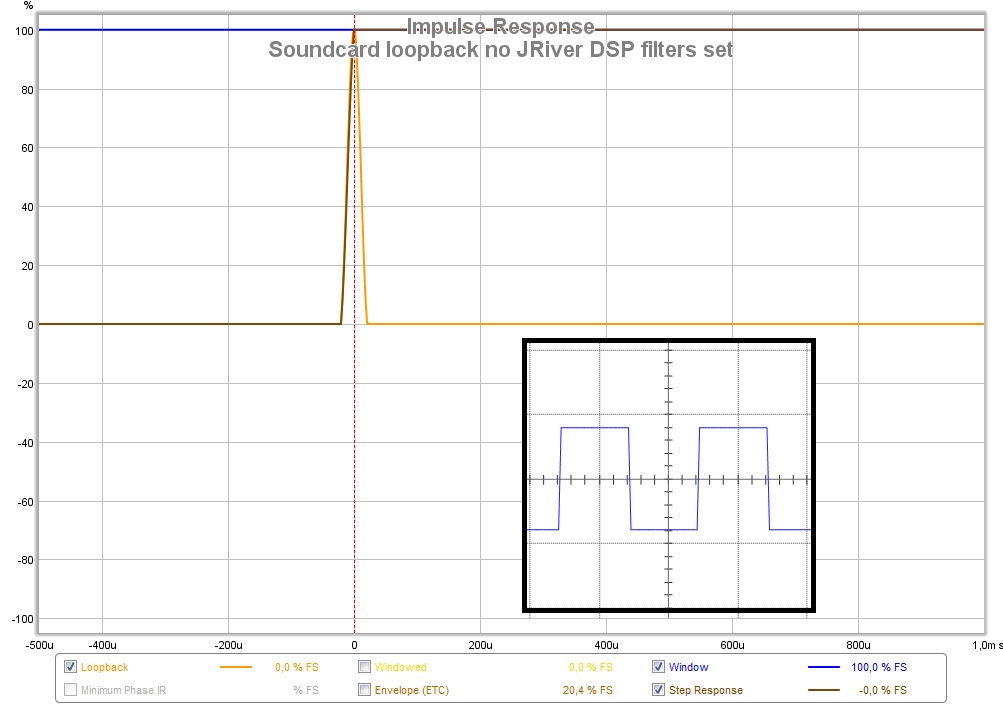

Square waves 1kHz inside IRR system bandpass 35-20kHz, LR4 FIR, IRR Harsch, IRR LR4, last plot soundcard loop no filters.
