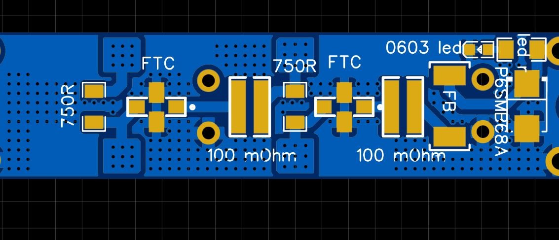

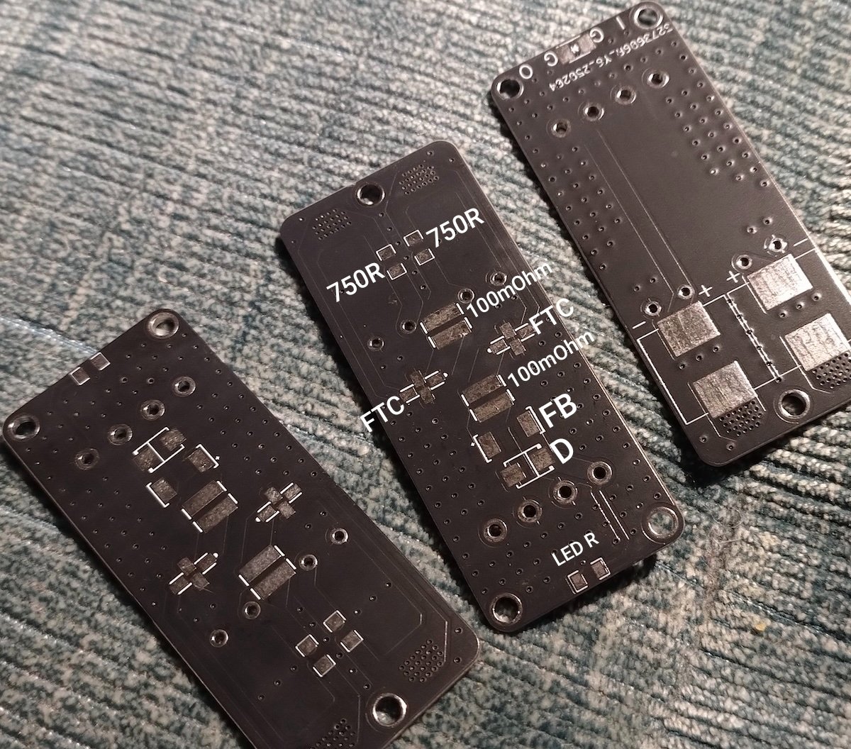

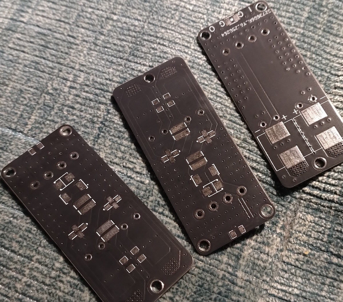

Had a very busy day, here it is. FB is ferrite bead, FTC is feedthrough cap, led r is calculated based on voltage (and current trough led depending on how bright you want it( so no value. Bit ugly but tired to do CRIF and bom designators 😴

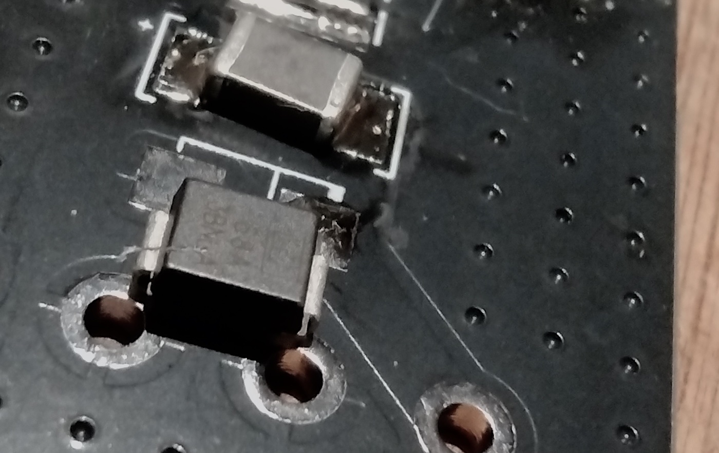

Per a BOM from the main thread I sit with this TVS diod. It says uni-directional - so one need to care of its direction?
https://www.digikey.se/en/products/...ESflQjT5Di1rPfk6sx7A28pzAM5JTZxOlLD094PyzhykR
Just like that yes 🙂

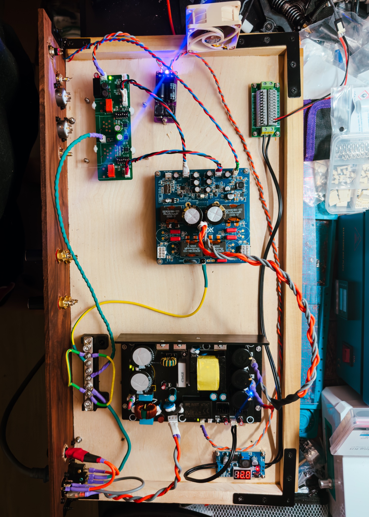

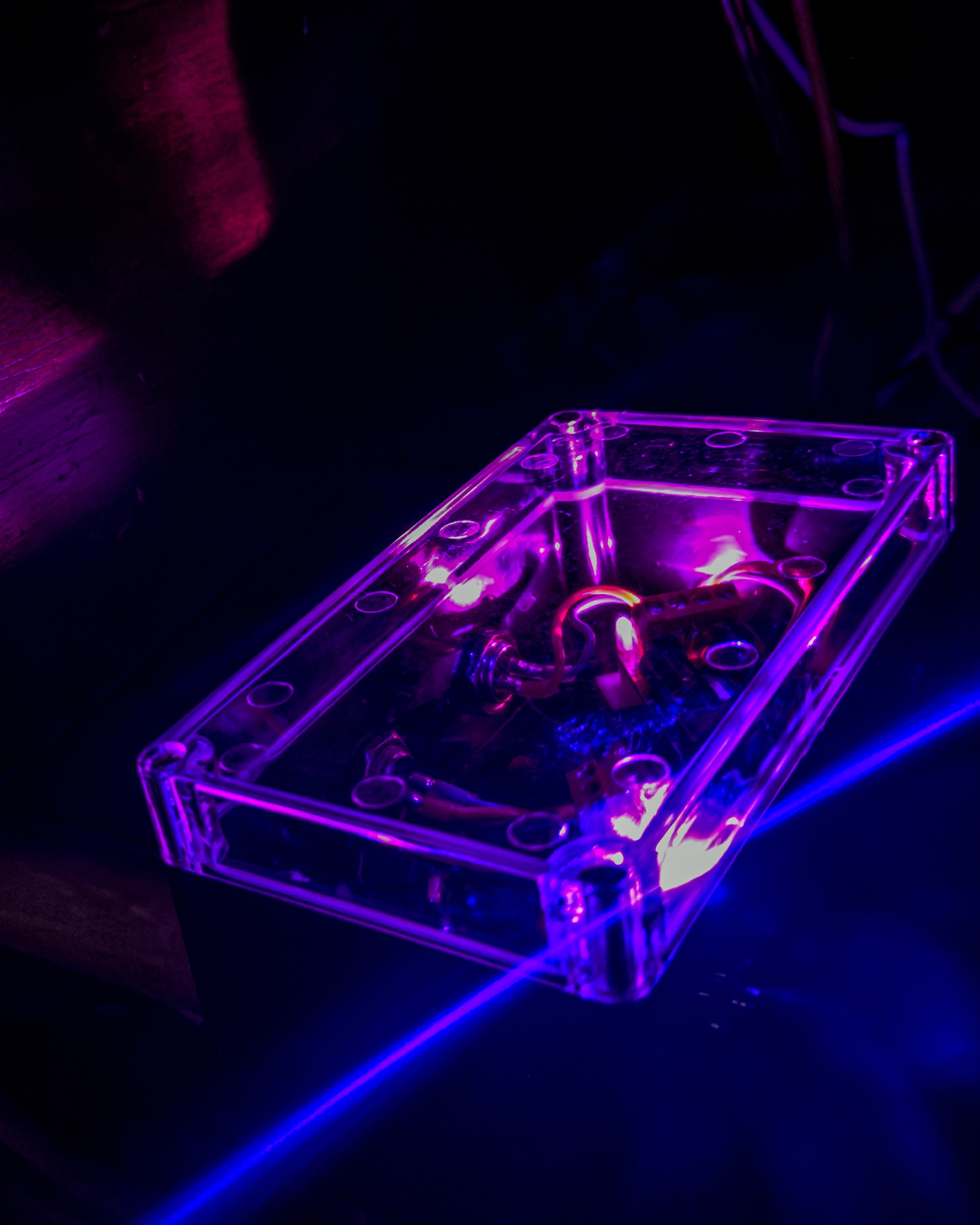

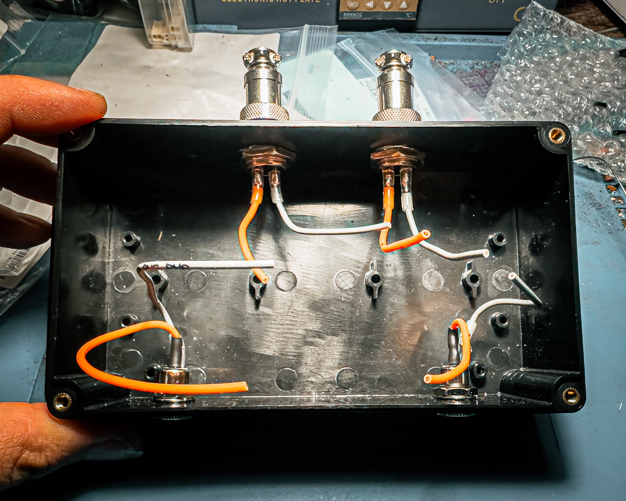

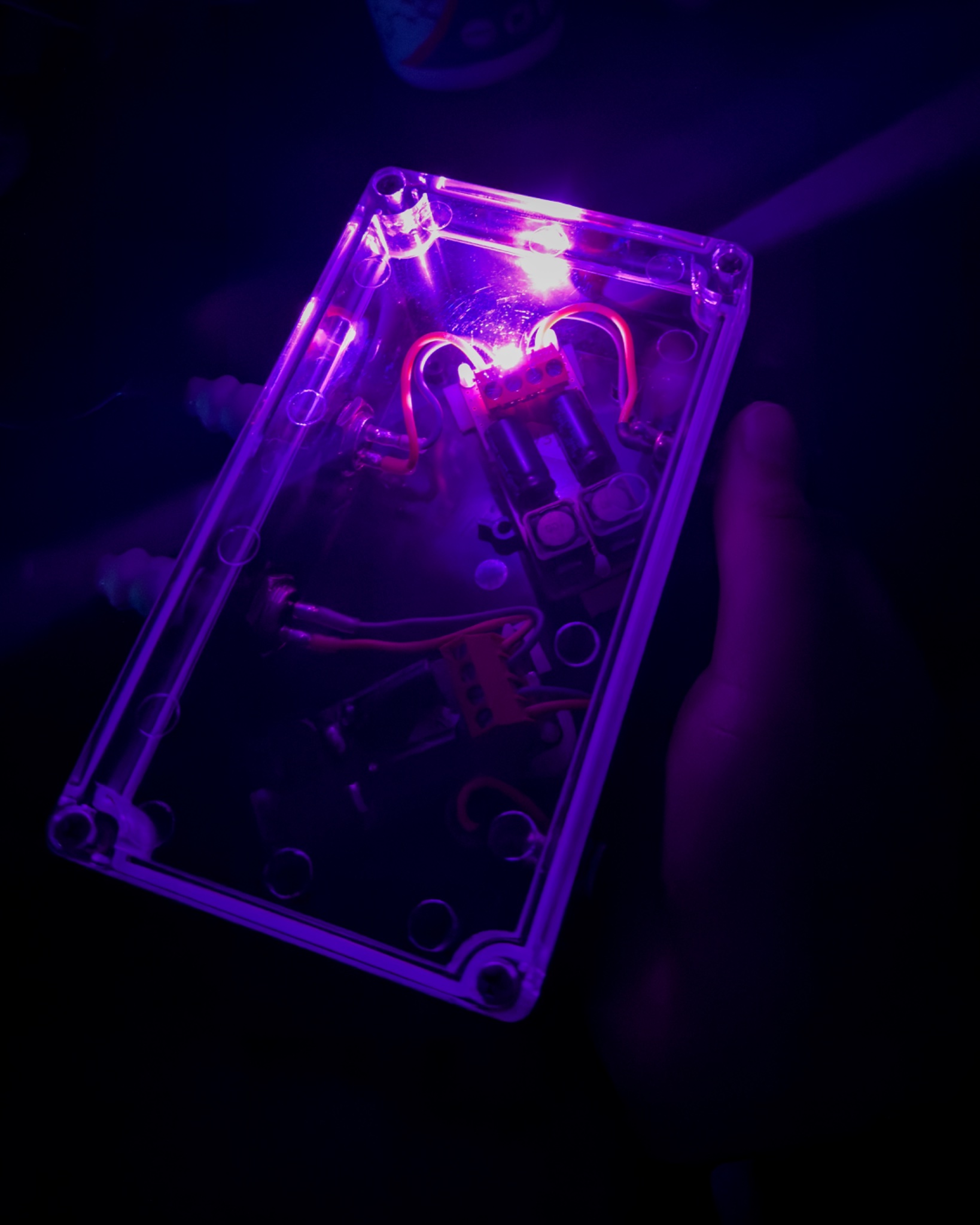

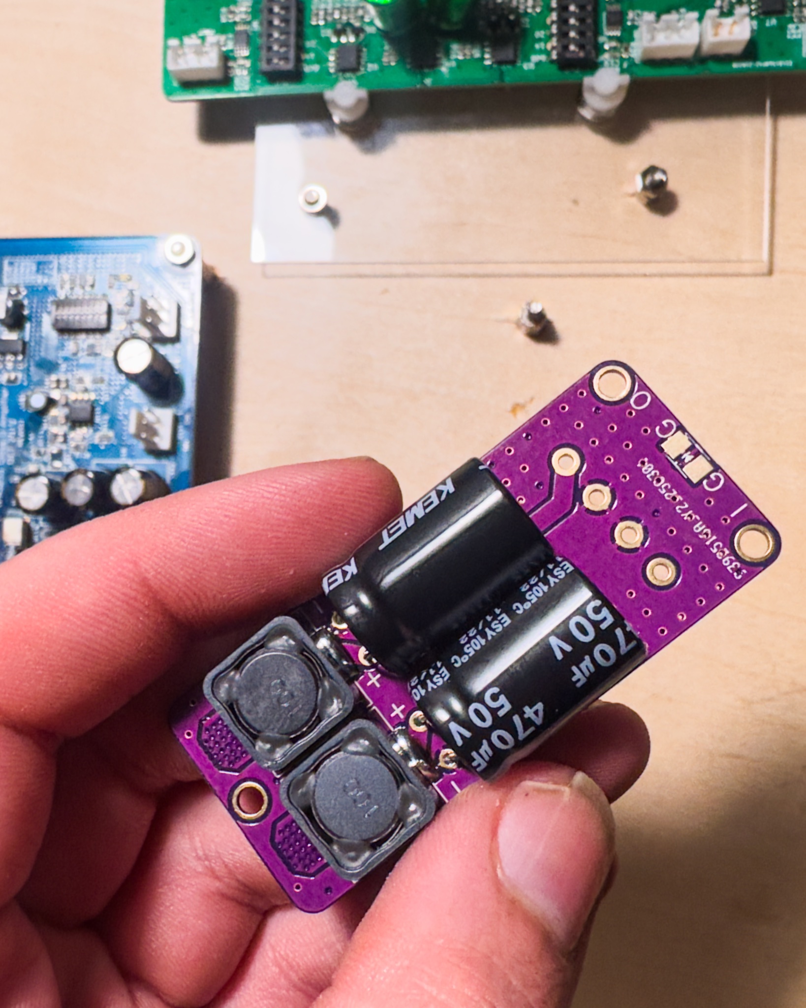

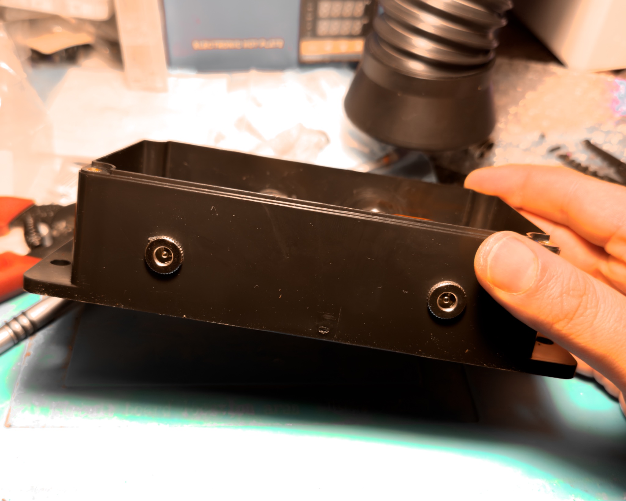

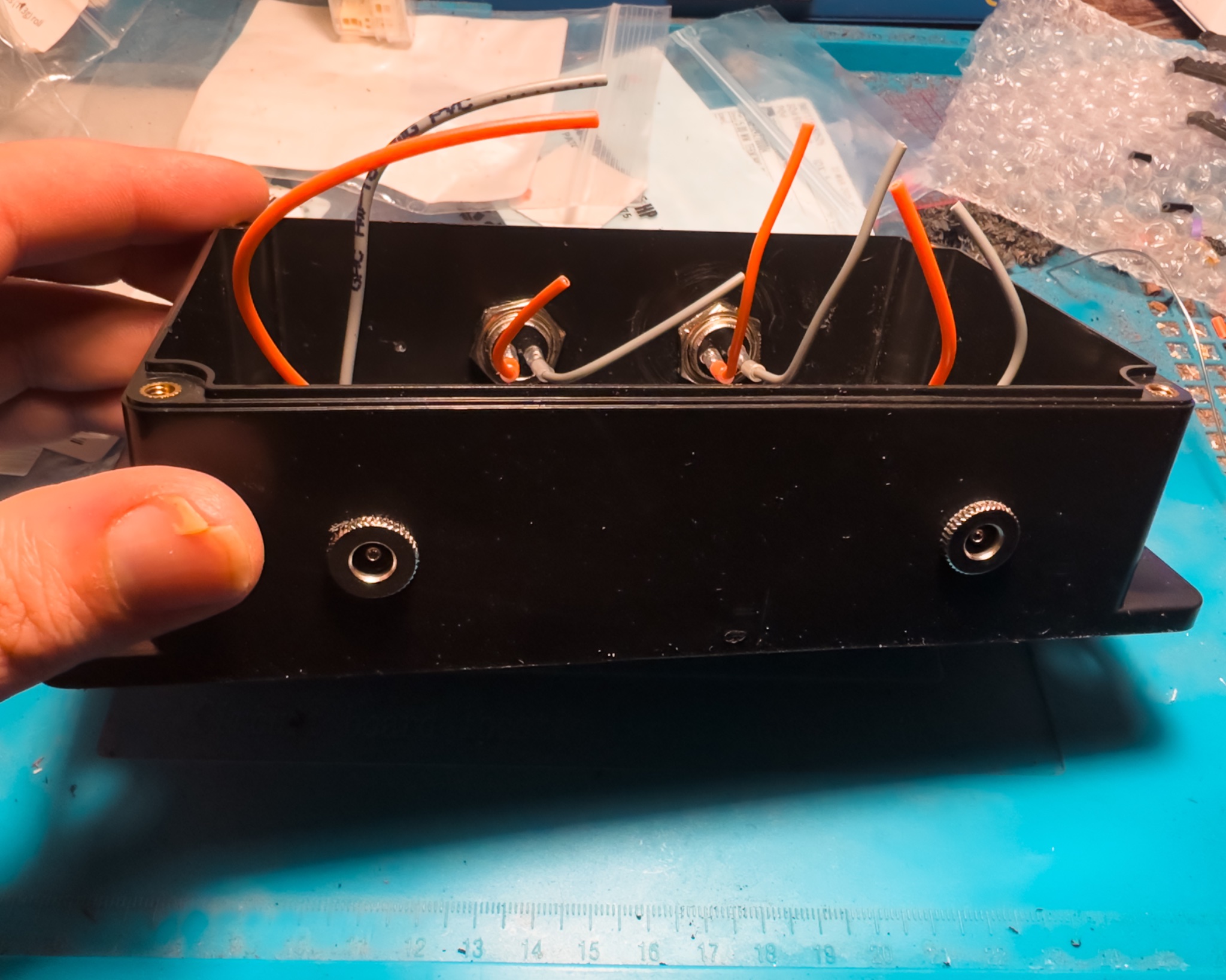

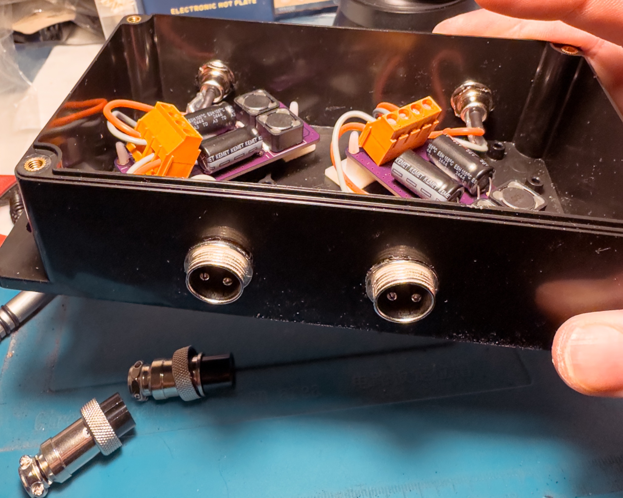

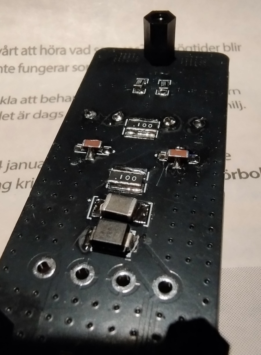

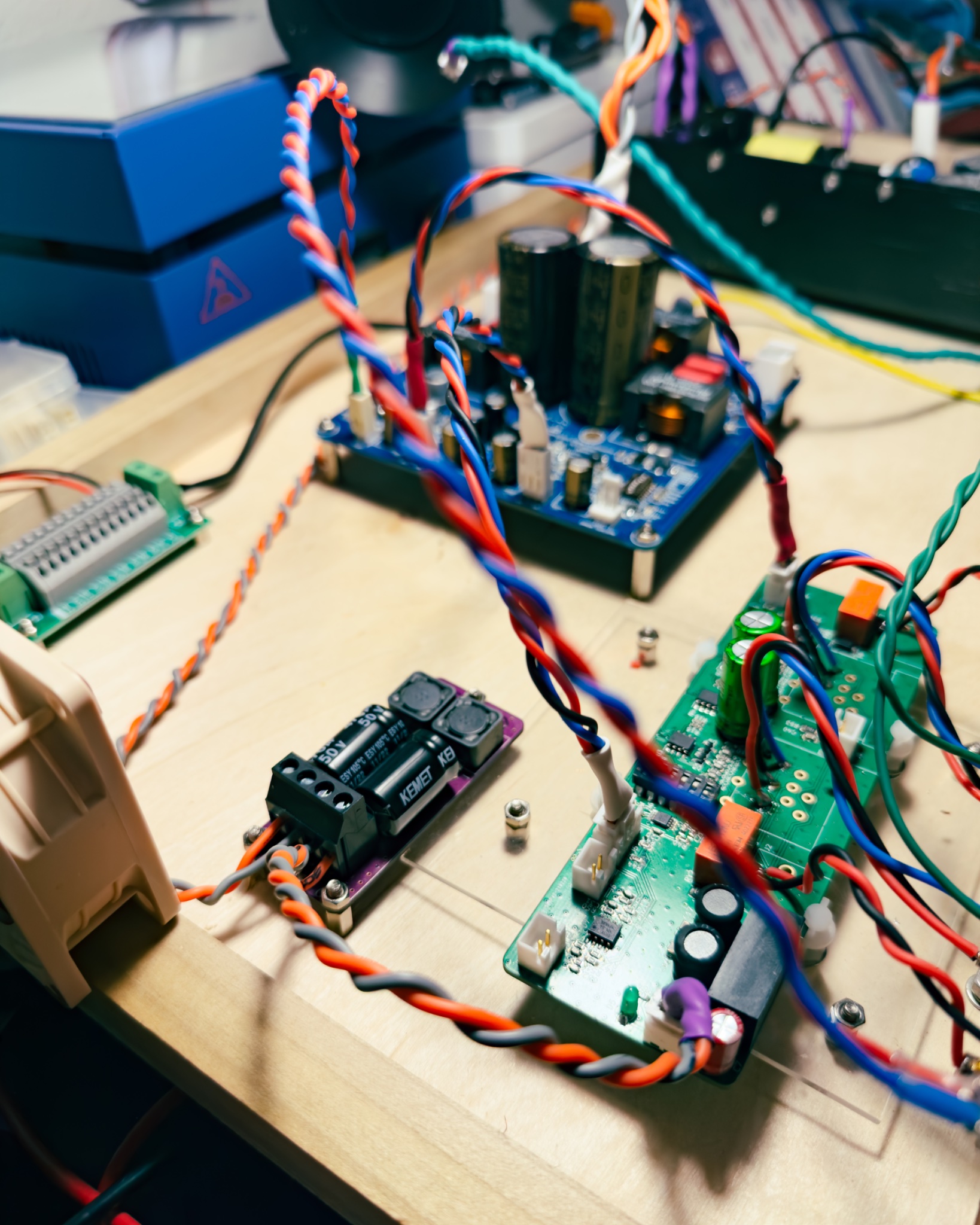

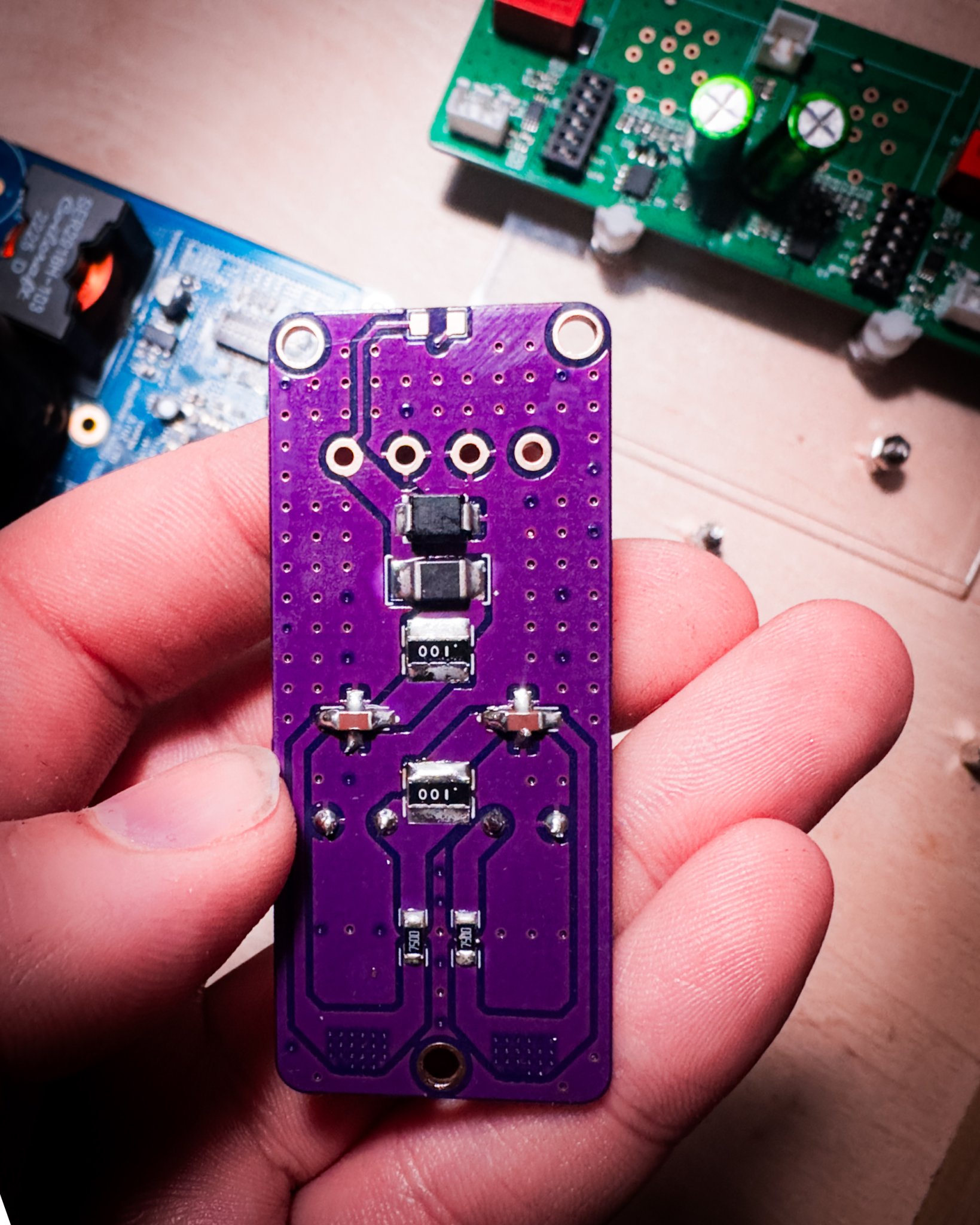

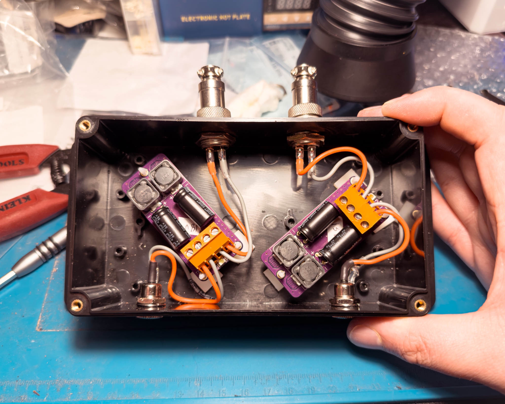

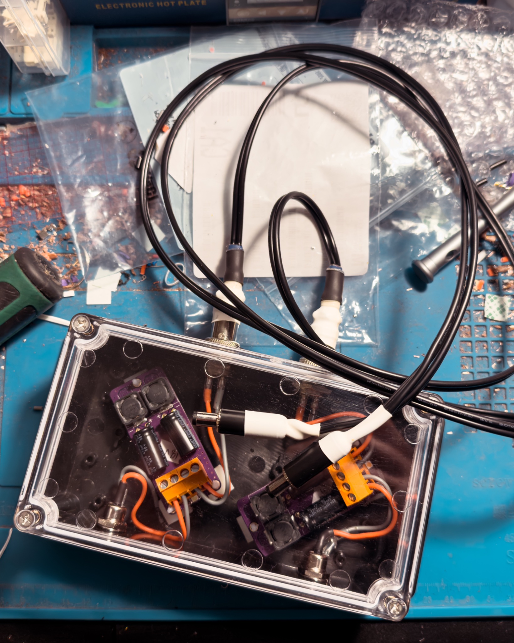

Wanted to share a couple that I built. First one was to filter from a SMPS to a balanced buffer for an amp I’m building. Then I built a double filter box for a phono preamp and an audio interface for a record ripping setup. Ordered like 20 PCB’s so planning on putting them on everything!
Thank you for the design!
