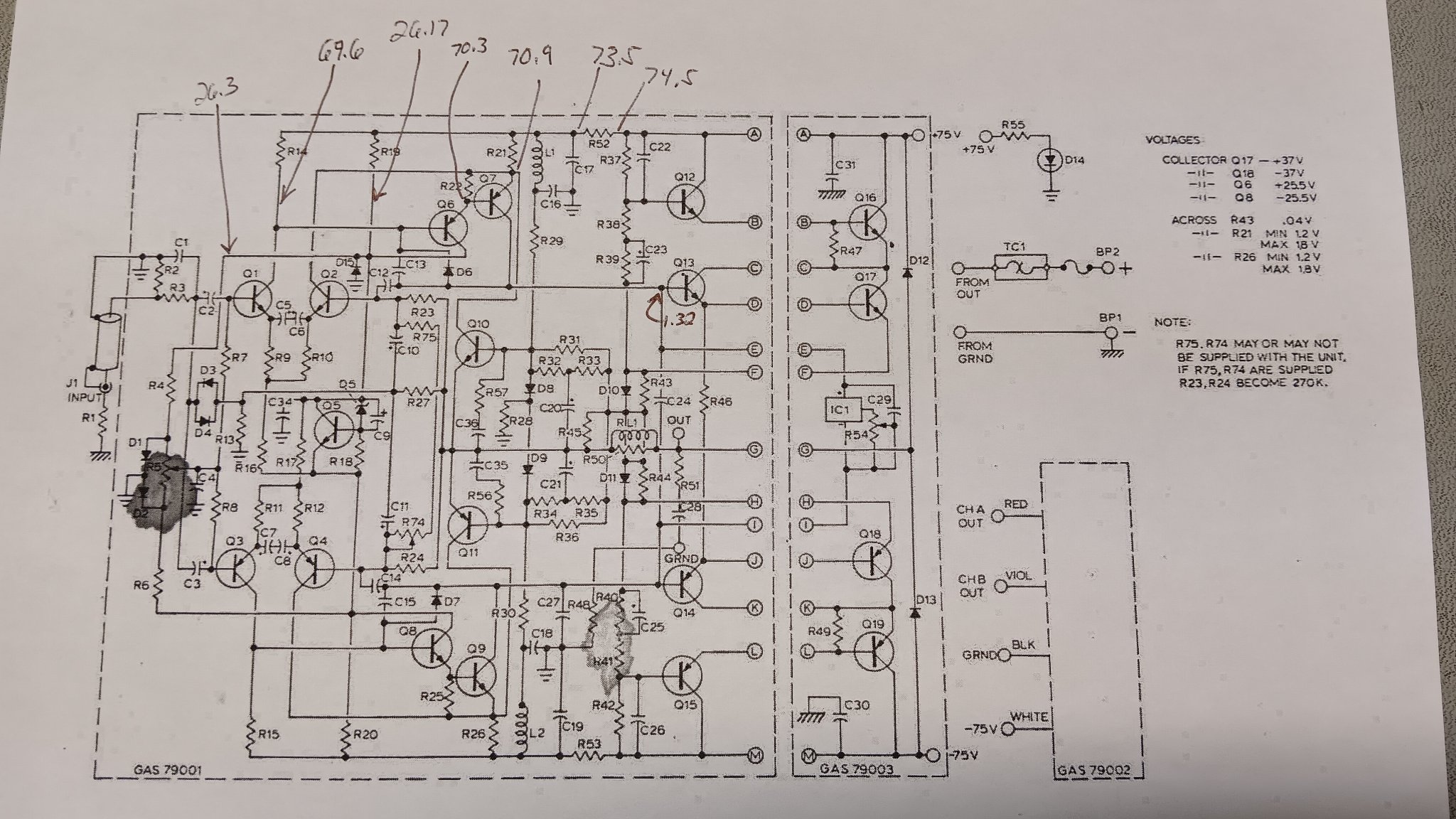

Yes, I'm at 2.6 on each (R21 & R26). I see on the top right of the schematic, it says 1.2 to 1.8.
I do see how the collectors of Q7 / Q9 tie directly to the Bias adjust. So am I looking an issue with the operating point of Q6 / Q7 and Q8 / Q9? I get a bit lost in the details here. I'm curious how the other chimney acts now. All new components are same value as what the manual calls for and I didn't find any thing different when I removed old components.
Here are my values that I measured. Negative side is identical.

I took one channel of the problem chimney to investigate and repair. I replaced all the original MPSUxx transistors with 2N5401/5551s. That did bring the voltages across R21 and R26 down to 1.9V, but that is on the high side of the range called out on the schematic (1.2 to 1.8V). The voltages at R19, R14 and the collector of Q6 are still a bit high compared to the other channel. Actually about half a volt higher than what I documented here: https://www.diyaudio.com/community/...33fc66d4c7684cca99c41e8eb.jpg?hash=h62rBUns9u

Try reducing R23/24, what do you have that's a bit lower than 150K? The SAE 2400 used 270K for R23/24 and then has a 100K resistor and a 100K trimmer. Do you have the empty locations for another resistor and trimmer?
My boards have provisions for R74 (potentiometer) and R75 (resistor), but they are not installed [and this applies to the boards that act properly and the boards that do not act properly].
I put a resistor in parallel with R23/24 to drop them to 100K and it didn't do much to change Q7/Q9. This was BEFORE I replaced the MPSUxx transistors. I'll try again.
I still don't understand the Bias being backwards. Unless it is because there is an imbalance between the base of Q13 / 14 where the Bias is located. On the good amp, the voltages are 1.12 and -1.12 (at the base of each w/ respect to GND). On this problem amp, it measures 1.32 & -1.12.

Problem 1: MPSUxx transistors in the front end doing weird things with quiescent current through Q7/Q9. Replaced with all new matched 5551/5401 devices.
Problem 2: Zener Diode removed from circuit and inspected. It was a 45V zener. Throwing front end voltages off after new Transistors installed. I already had new 51V Zeners ready to go.
Problem 3: Current throught Q7/Q9 was still a bit high and voltage across the 62 Ohm resistors was 1.8V. On the high side. I did look at the 2400 schematic to see how they implemented. I just changed the R23/24 150K resistors to 120K and that dropped the voltage to 1.6V. This also brought the Bias voltage down going into the Bias circuit.
Assembled and adjusted Bias per the SAE method. Sweet spot found and voltage across Q7/Q9 is 2.4V.
