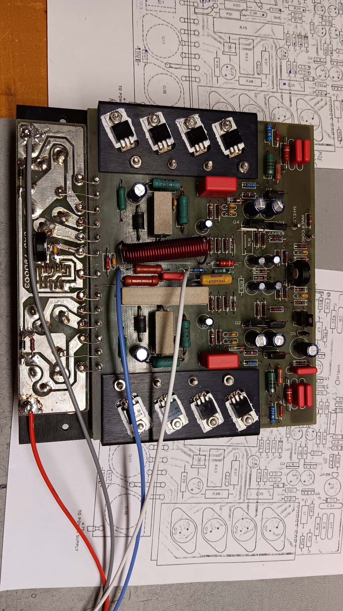

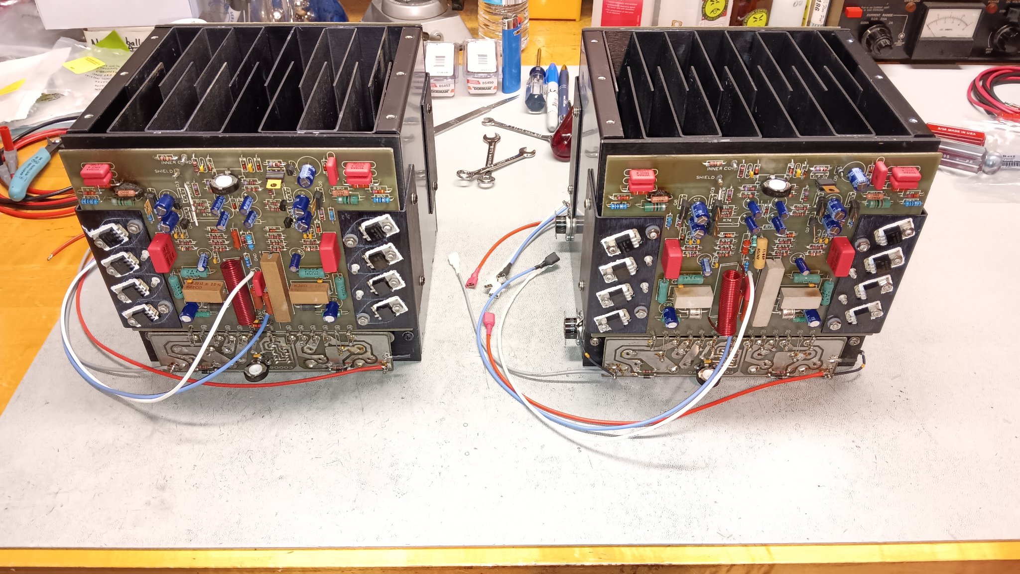

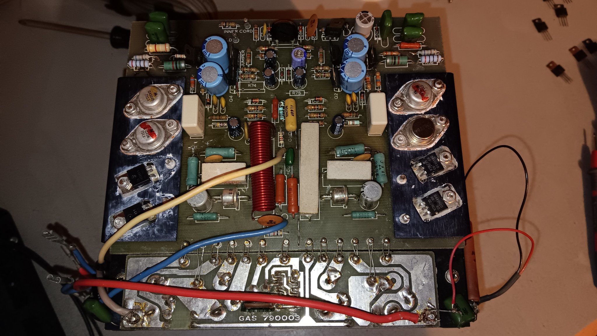

To wrap this thread up, I rebuilt 3 Ampzilla amplifiers (original). Some were kits and one was a factory built amplifier. I used MJE15028 / 29, MJE15034 / 35 and MJ15003 / 4 for outputs. I was able to obtain very similar numbers on all of them. Similar noise floors, distortion, frequency response, max output, etc.
Both channels driven, 1% distortion was at 238W. Harmonics started to increase at 220W. Single channel driven, 270W at 1%.
