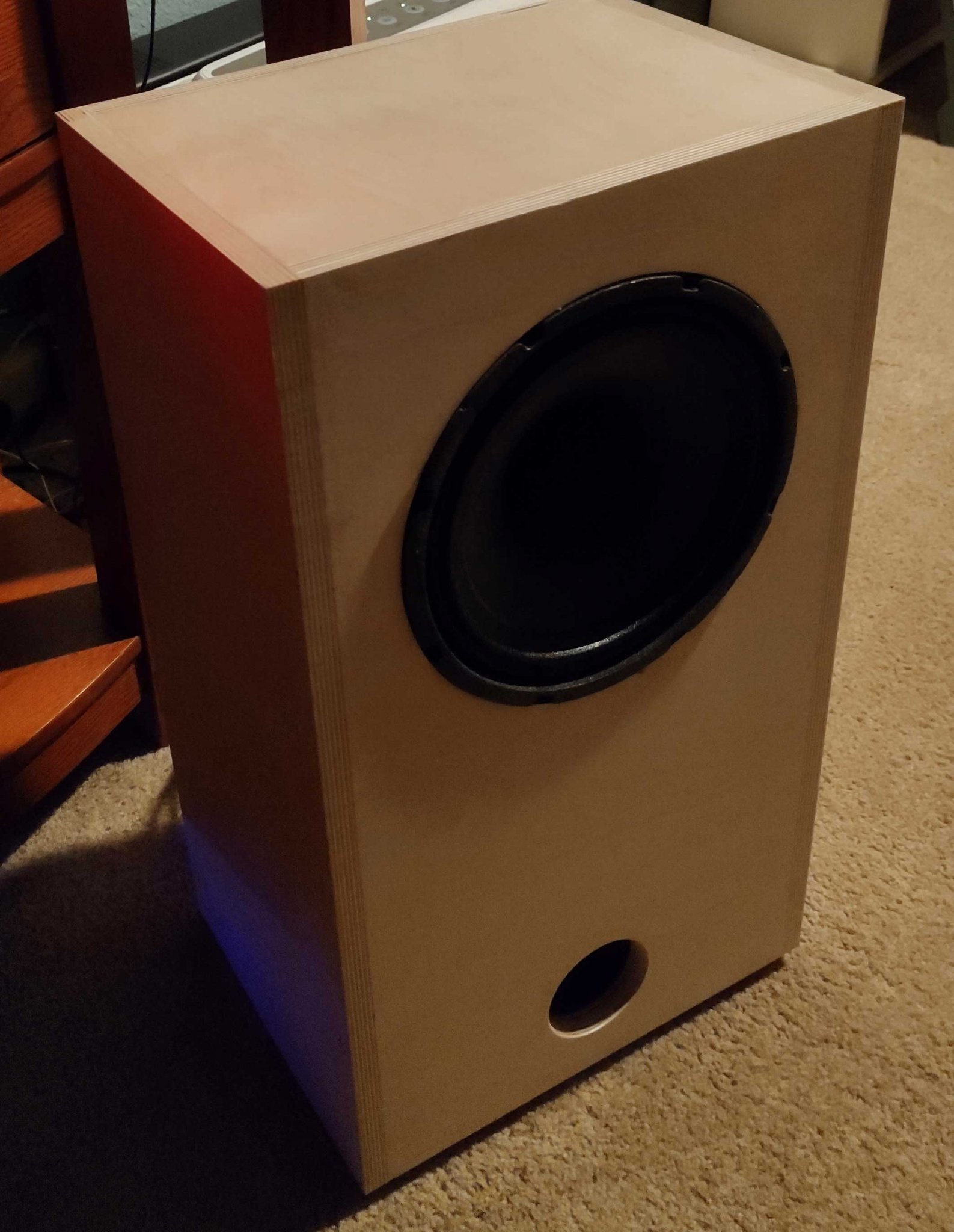

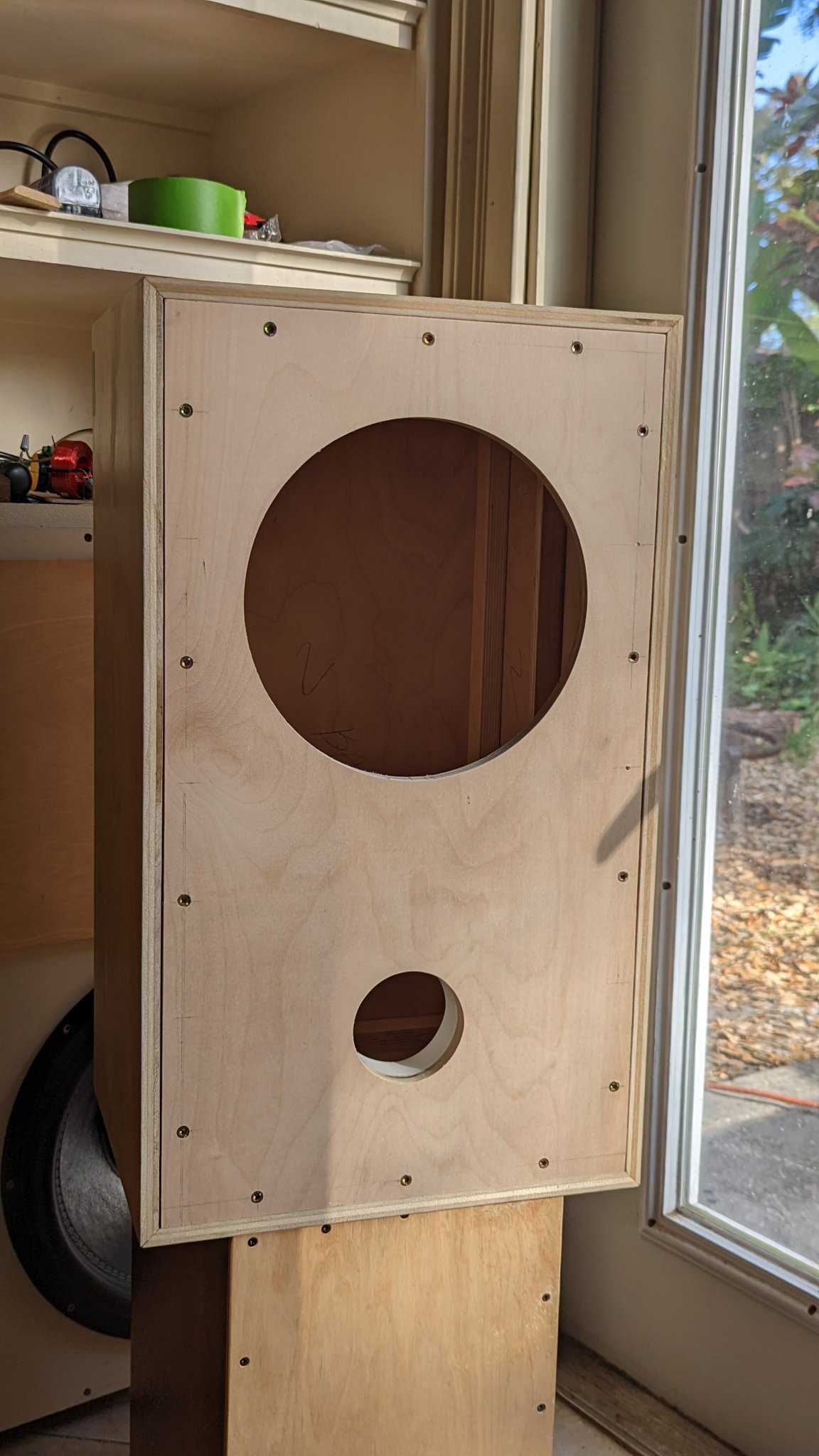

I am currently building the Osprey BR. Cabinets are half done. Front and rear baffles are pending completion. I have the driver and x-over components. Finding the time to work on them is the hardest part. I previously made another design from Michael Chua of AmpsLab and was happy with it. Just checking to see if anyone else has completed these.
So close. This will not be the finished front baffle. Looks like a classic Harbeth speaker in it's current state. So tempted to install the drivers and crossover tonight for a test run. It's hard to not finish all the details before taking it for a test drive.
I have my Osprey BR build up and running. They sound very good indeed. Michael Chua did a great job with this design. He must be commended for his contribution to DIY audio. He responds to emails fairly quickly and was helpful in clearing up some questions I had on another project. I'm sure he is a busy man and it's pretty amazing that he's is able to do all of this.@rongon Any updates on the build? I'm really curious to hear your impressions.
I had concerns about the jagged response in the upper treble. No longer! The Osprey BR sounds phenomenal. Imaging is great. Much better than other speakers I built using high-end SEAS drivers. "Effortless" is the best description I can use. Depending on the recording, they sound like I have a performance in my room. Very life-like. Vocals and acoustical instruments are very natural. These don't play very deep but that's the price you pay for high sensitivity. Higher sensitivity speakers usually have a higher Fs and light cones. But it's not a bass-shy speaker either. The bass is does have is very good. Just don't expect much below 50hz or so. I'm using a 12 watt El84 tube amp and it plays very loud. I haven't had the chance to swap it out yet for my old ADCOM GFA-555. I'm curious to see what a beefy 200 WPC will sound like. These are pro drivers that are able to produce a lot of sound.
