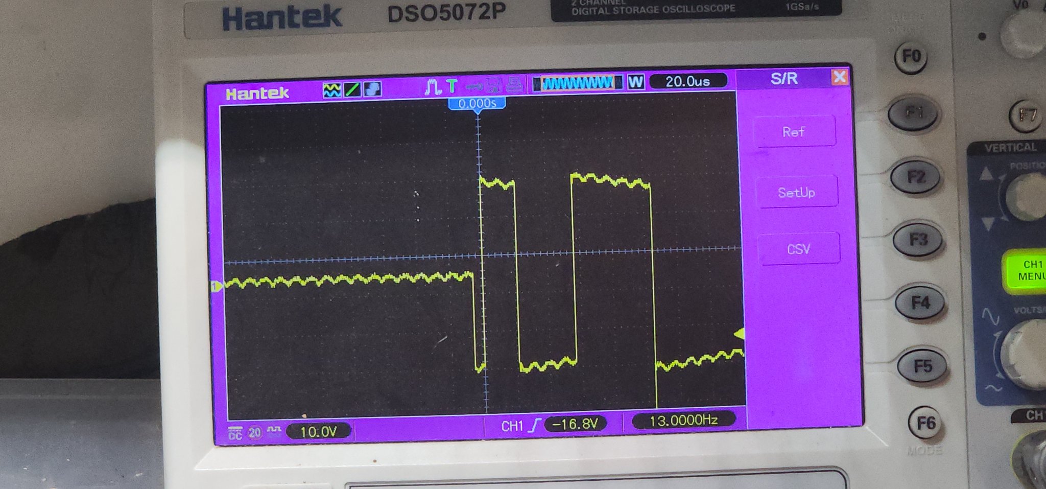

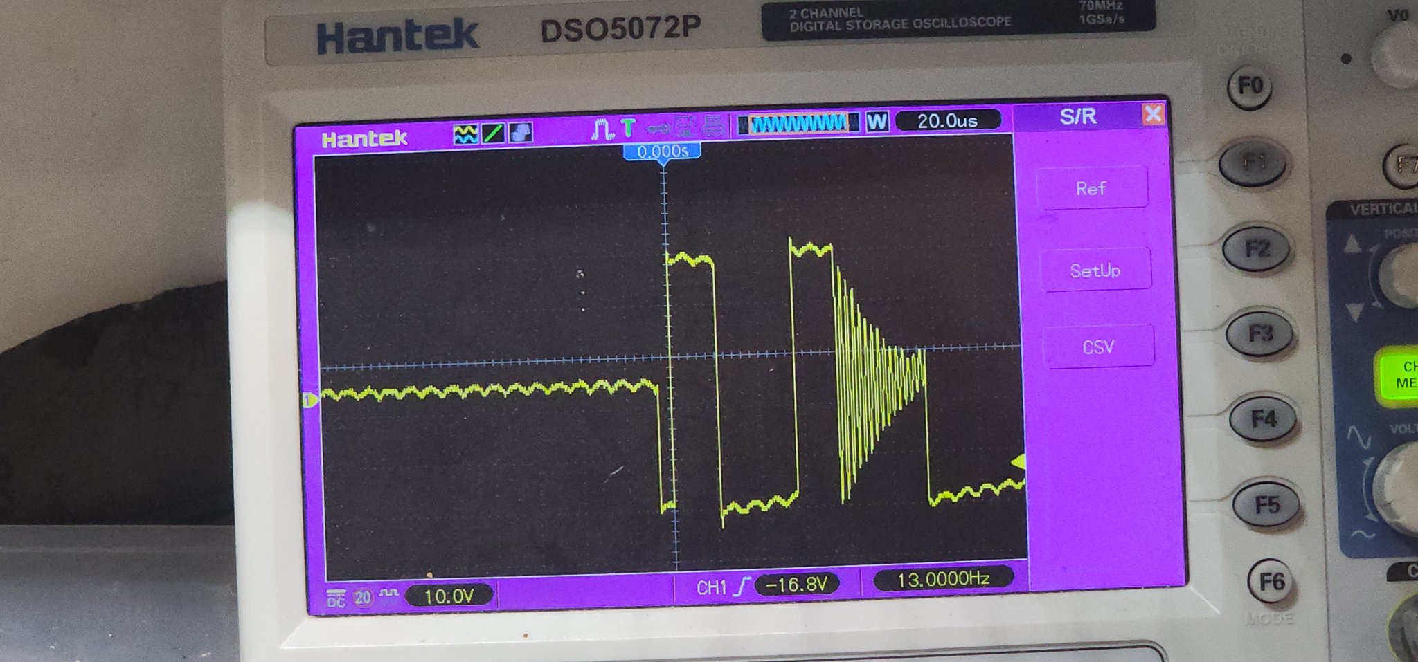

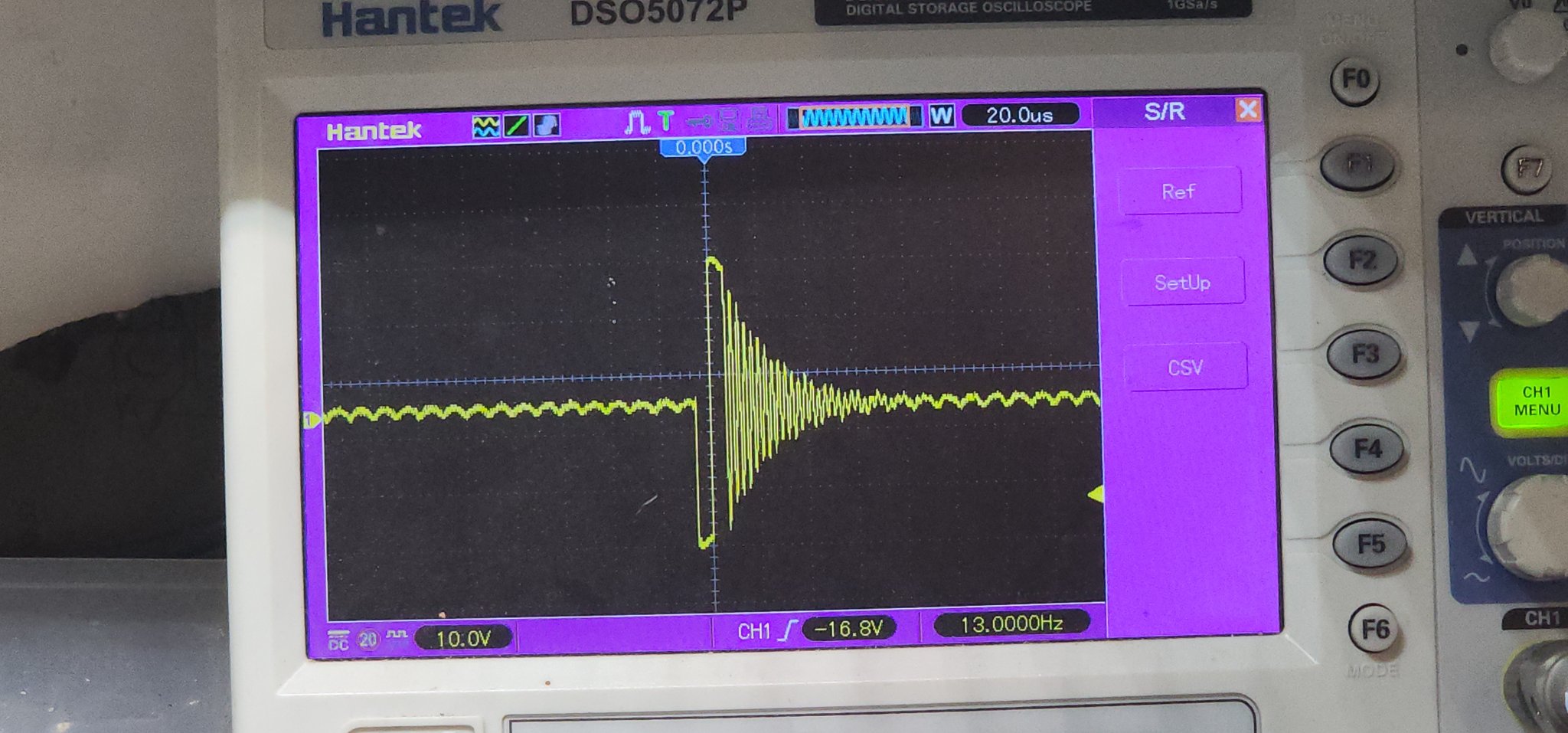

Without fets everything looks fine again but now when I put the fets in it attempts to start but there is what appears the be ringing on the high side. The pictures are a progression of the high side wave
Im just glad I'm not blowing chips anymore with the fets in
