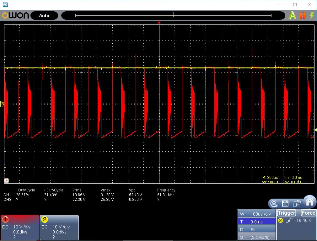

When the FETs were in the board and you were driving a signal into the amp (frequency?) and you did not get rail-rail oscillation, how far did the drive signal get?
Output of the TL072?
Output of the LM211?
Input of the 21844?
Output of the 21844?
Do you have a signal generator that can generate a triangle waveform at approximately 100kHz?
Input of the 21844?

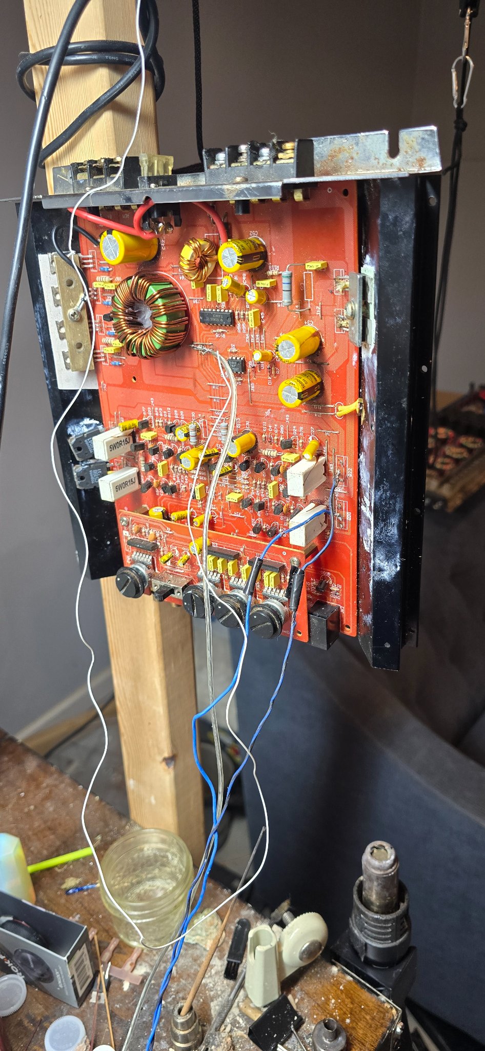

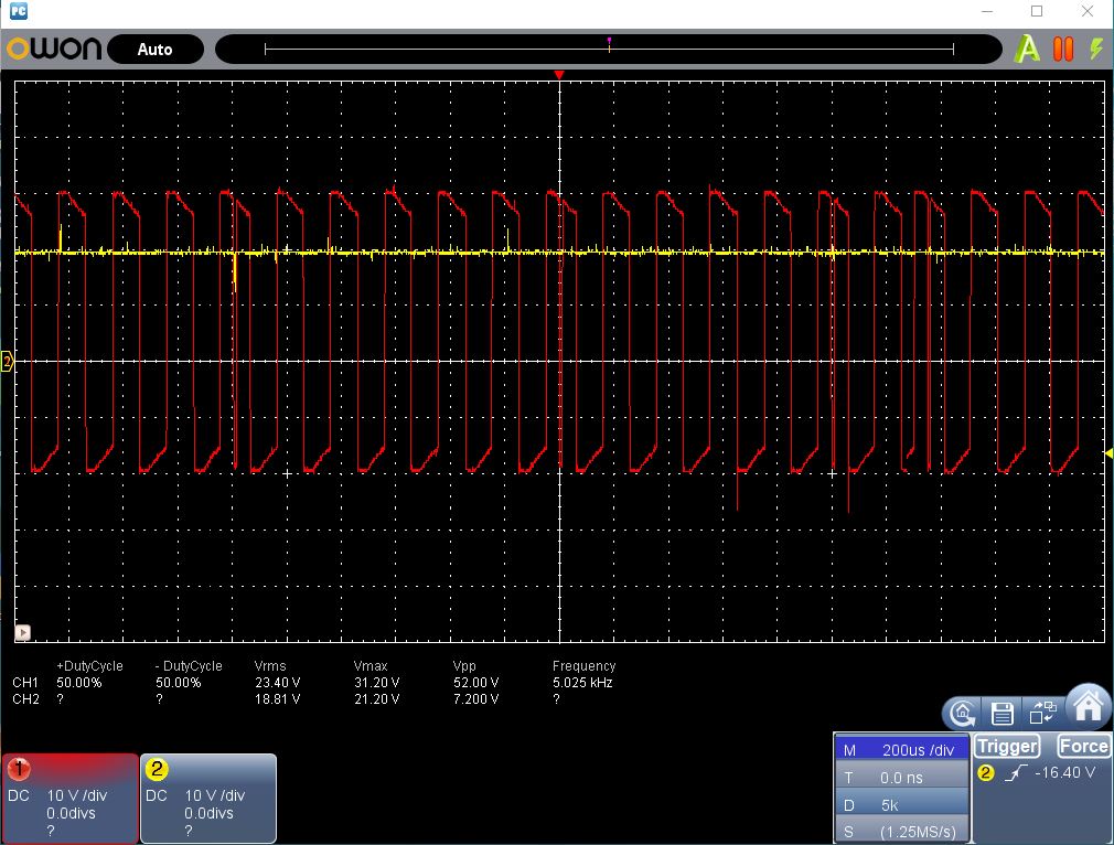

Pulled this amp back out for another go at it.
The output section is separated from the ps for safer low voltage testing. +/- 20vdc on the rails
This amp uses the ZNCM_HP style driver card
My question is, how important is the duty cycle on the output section at idle? I have 3 different driver cards for this amp that all work in another amp and they all behave differently with drastically different duty cycles.
This is all without fets in. As soon as the rail to rail starts the amp draws current and the fets heat up when they are in.

I don't get it. Without the fets everything seems fine.
Yep. It will start switching R2R with the fets in but it starts squealing and draws current causing the fets heat up.
Do ALL of the FETs heat up at the same rate when you have the FETs in the amp?
Did you confirm that the driver ICs had a good 12v supply for the low-side drive section?
What are you using for the ±20v supply?
So here's what's weird.
Depending on which card I have in the fets that heat up the most change.
For some reason today i can only get 1 of the cards to actually stay switching. Last night all 3 worked. I haven't touched it since.
And all 3 still work fine in a different amp.
With the card I can get to work now. 1 high side and the opposite low side heat up the most.
Another thing that isn't making sense is initially all rail voltages are correct the amp tries to start switching then shuts down. The moment it shuts down I get full neg rail on the center leg of the high side
Also it's starts switching well before the rail voltage is built.

I usually drive a 50hz wave for testing but it starts switching without signal.
Yes I have a .01uf cap
Does the 50Hz signal produce the square wave at the output FETs?

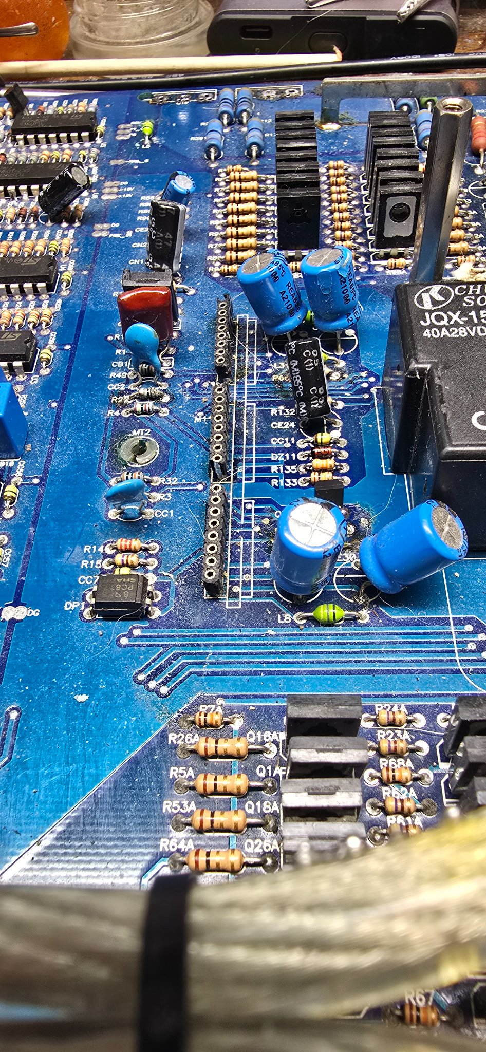

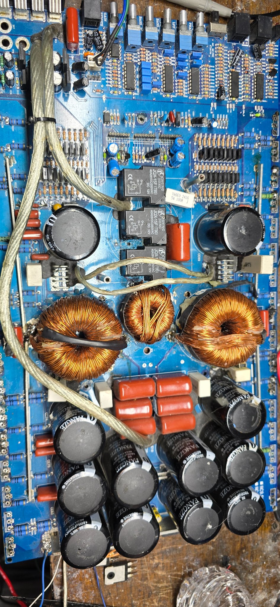

Post a photo of the main board in the area of the driver board and output locations.
I was asking about signal at the gates of the output FETs. Are you saying that you don't get signal on the gates of the FETs when the FETs are installed?
Drop some FETs into one side. It can be a single FET in each bank. The FETs don't need to be the originals. They can even be PS FETs. Does that side oscillate normally?
