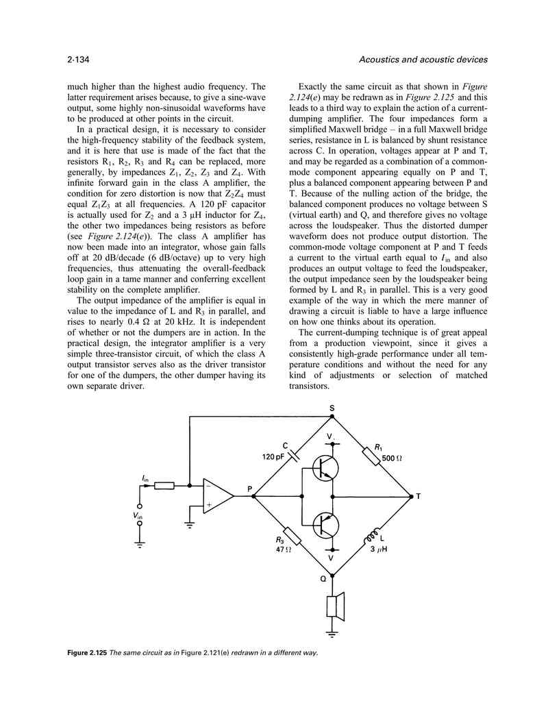

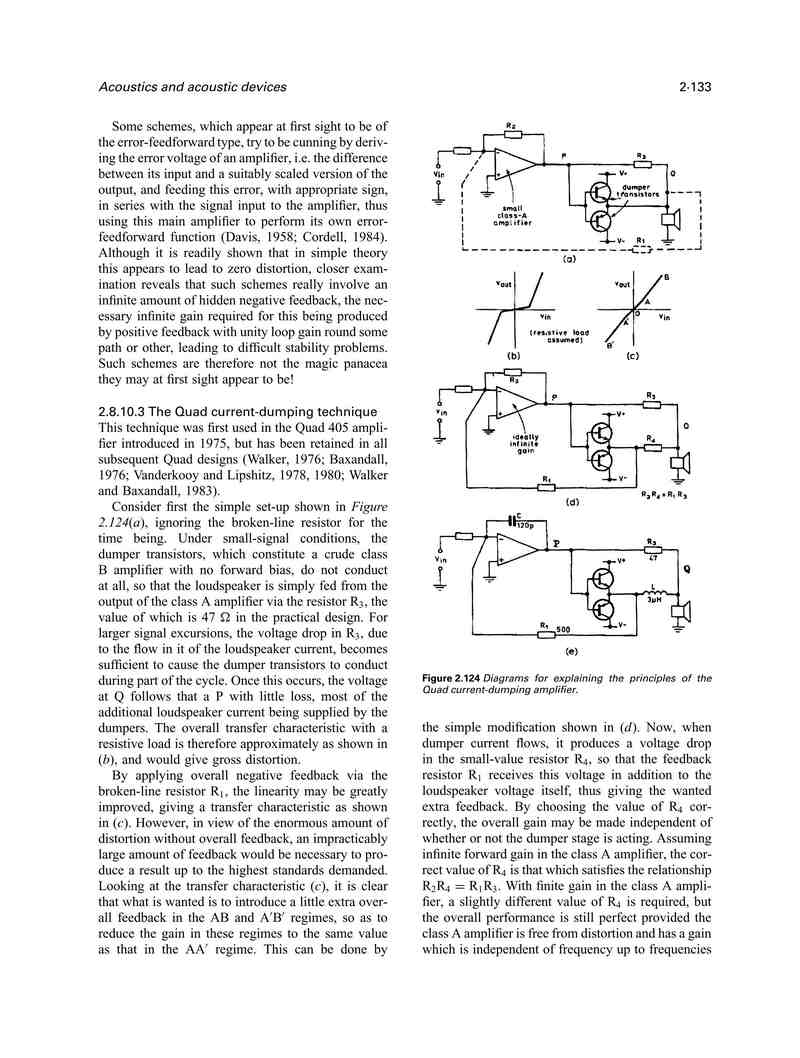

About your base-emitter resistor mullings I recall Peter Walker developed current dumping around it and got knighted for his creation. Peter Baxandall wrote a simple explanation of its development in Michael Talbit-Smith's Audio handbook and I attach the two relevant pages (assuming it's legit) since you are following a similar path of development here🙂. R3 in this text is the "base-emitter resistor".
To read it save the file and open in a picture viewer.
Sorry, I didn't respond to your post asking I try your circuit. I have been away for a while. I'm thinking about it.
