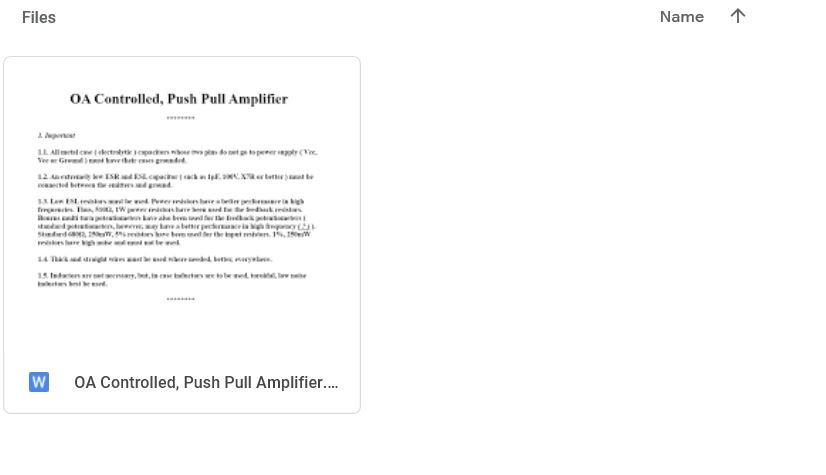

I am incredibly proud to announce I have made an amplifier with a schematics I have dreamt for a long while. I have only done very preliminary tests which are excellent. I have not yet written up the document, but, I am impatient to provide this information.
At present, the document contains the schematics only and will be updated, hopefully, soon.
Here is the link : Amplifier - Google Drive

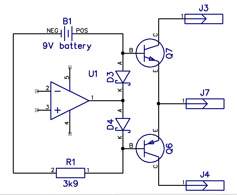

Steven, I assume you have picked transistors that are available in a metal case because you like the appearance but these are RF transistors and you could pick more appropriate ones for audio that are less likely to wind up with unwanted behaviour. BD139/140 would probably do nicely.
'Nice effort with drawing package though.
Steve are you aware that your output stage has no bias and thus will show appreciable cross-over distortion?
In fact, with the 100mA current capability of the opamp you probably don't need the output stage at all, depending on the load you want to drive. What is this amplifier meant for?
Also, the input impedance of 620 ohms is very low and will load down heavily on your source, not a Good Thing!

Interesting circuit. Inspired me to take a look at the datasheets.
The output of the LM7171 is very resonant into a capacitive load of the order of 100pF, possibly becoming unstable in the 50MHz region. I'd worry about that myself. A ferrite bead probably needs to be deployed to isolate the opamp's output from any capacitive load.
That opamp looks like its designed to drive 50 ohm stripline, not audio output devices!
I note its high current voltage swing is rather limited at +/-10V or so.
Alas the noise performance of the LM7171 at audio frequencies is poor. Being an RF device the 1/f knee is way up at 10kHz, so that voltage noise at 20Hz is about 60nV/sqrt(Hz), which could be popcorn or flicker noise or a combination of both. Popcorn noise would be bad!
With 9V rms (about the maximum usable at +/-15V supplies, you need to handle 1.1A or more to drive an 8 ohm load - those transistors can't take that. But then the output swing limits of the opamp mean 7Vrms is actually the practical max output, even so the transistor current handling is going to limit the performance.
I note the extremely low current gain of the output devices at high current, and therefore the large variation of gain with current through the cycle, basically a non-linearity.
The class BC output stage will of course have crossover, and even with a high speed feedback path to sort that out, its a glaring issue.
[ I say BC because the transistors will not be conducting for the full half-cycle duration ]
The CMRR of the LM7171 is fairly low at 70dB or 75dB worst case, but that might only be at RF frequencies. I note the distortion graphs seem to be OK at audio frequencies. The very low open-loop gain is notable as that will limit the ability to reduce the cross-over distortion, especially at low signal levels.
Unlike many amps this design is likely to hold its properties upto the MHz region due to the frequency response of the parts. The very large input capacitor would help prevent spurious HF junk getting into it, but it still seems extreme and the very low input impedance is unusual for audio.

The main reasons to pick these transistors are
* Their low parasitic capacitance values and, therefore, a fast jump switch from - 0.7V to 0.7V, i. e., their speed.
* Power of 1W to 1.5W, 1.2W OK.
* Possible to use a standard heat sink.
The disadvantage of these transistors is :
* High Ucesat.
* Max Icerms and Iberms of 0.4A. Not so bad.
* Very low B of 5 at high currents.
These transistors are, therefore, only for lower power, yet, higher than the amplifier.

Steve are you aware that your output stage has no bias and thus will show appreciable cross-over distortion? <snip>
The output current has been addressed in the previous reply.
The most important feature of the amplifier is to provide a general feedback which increases the speed of the jump and increases linearity.
620Ohm is one of the standards for audio, although very old. However, a preamplifier is supposed to be able to handle such an impedance. The best is to include the preamplifier in the same circuit. I have decided to have them separate in this stage. Own design preamplifier is to be used.
Headphone outputs can drive 32Ohm loads, sure they can do 620Ohm.
The low input resistor Ri is for :
* Comparable offset voltage to the one introduced by the feedback.
* To allow preamplifiers with DC filter capacitors which will not be charged by the bias current.
Obviously, the input resistor can be easily changed to the standard 10K and another 10K resistor can be added in series to the positive input for protection. This introduces offset which is OK for low gains and output DC filter capacitors which have been removed in the new version.
The whole idea of the output stage is not to be biased. The crossover distortion is not present with output capacitor from emitters to ground as well as with high quality power supply capacitors. This is addressed in the new document : Amplifier – Google Drive

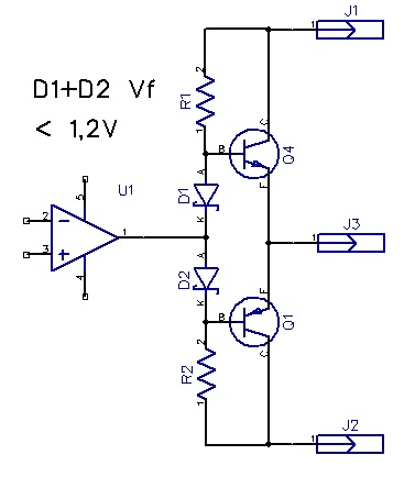

What about "not to be biased" ===> "almost not biased" ?The whole idea of the output stage is not to be biased.
With the addition of two (or maybe three?) shottky diodes and two resistors, would an "almost not biased" version provide additional benefits in terms of lower switching distortion?
As instead of switching 1,4V .... reducing this switching range to a "lesser value" of switching volts?
A smaller "switching delta". Smaller hysteresis.
{{ this is not a fleshed out schematic detail - just the "general idea" }}
... if, for example, you find a low forward voltage diode, Schottky type, such as with a forward voltage of 0,45V, then two of such total 0,9V, hence potentially decreasing the switching / hysteresis region from 1,4V down to 0,5V.
Each output transistor would be slightly pre-biased, with 0,45V, which is basically insufficient to turn it on, except for maybe a trickle (non-critical) standing current, and I am guessing that it would be of a value in the miliamps range.
Further, I would consider co-locating the Schottky diodes on the output transistors themselves, so as to achieve good thermal tracking. If using a TO-247 / TO3P / TO-264 enclosure type device, this would be easy - simply bolt the Schottky diode down directly to the top side of the transistor enclosure, with some thermal grease coupling them.
Not sure how to ensure good thermal tracking with the currently used transistors though. Adjacent on same heat-sink, would be the next best guess.

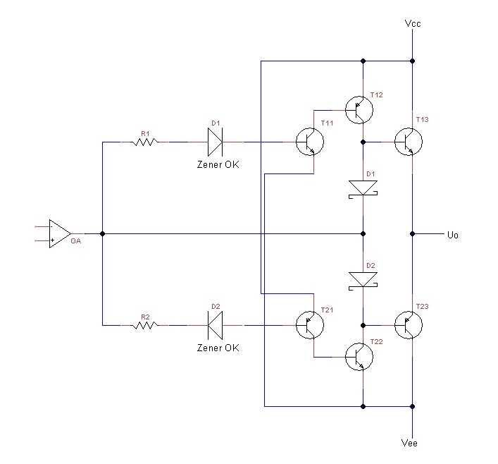

Another variation of this schematics is a common emitter transistor and diodes. This is a standard approach in OA design.
The idea to add some bias, but, not full as with Schottky diodes is OK as far as power consumption is concerned. However, the introduction of resistors is something I would like to avoid as well as the parasitic capacitances of the diodes which can be low with low power Schottky diodes, but, then, the resistors must be high.
Also, this will only half the jump which is will not save very much even with Darlingtons.

OK, ... so strike the resistors.Another variation of this schematics is a common emitter transistor and diodes. This is a standard approach in OA design. <snip>

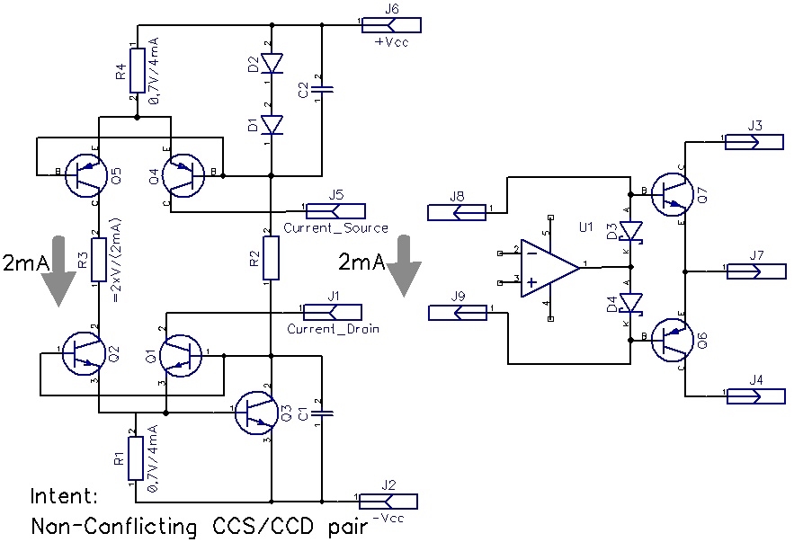

How about a floating current source, from a totally separate set of transformer windings, that provide a constant and steady current across those two or four under-bias diodes of mine? And since separate and floating, such current from current source could be actually set per preference, as to what the circuit would work best with.
Yeah, I know, slight overkill, a separate floating circuit and all, but maybe the distortion specs could be improved significantly? Would it be possible to simulate this scenario and see if it gives a chance for value added?

Interesting development. I think that I "feel" where this concept is intended to be going, but I am not sure about some details here.Although I am only interested in the direct circuit and not in any other, as mentioned in the previous reply, I decided to try to make your idea not so much resistors dependent, because, your idea is brilliant and is not so standard. I used a standard approach of replacing resistors with transistors and, although I have not had the possibility to check the circuit logic, I have decided to post, because your idea is brilliant. I also do not remember to have discussed your idea in previous posts.
The transistors will allow for a larger current flow when the output transistors are fully or close to fully open. During the jump, they are not so important as not so much current is needed.
Again, I have not checked the schematics, hopefully, I have not made a logical mistake.
a). What does 'Zener 0V' mean?
b). As soon as D1 starts to conduct, T11 switches on. Will it not fail? (I am afraid that at start of conduction of T11, jointly T11 and T12 will create an inter-rail conduction path, a "short", with no limit to the current, and this could result in failure of these transistors).
c). In this transistor-assisted-Schottky concept, that you are thinking about, would the condition be fulfilled / met, that the Schottky diodes are conducting constantly, all the time? Or would they have periods where the one or the other is inactive? My gut feeling tells me, that the Schottky diodes "should" be conducting all the time, but maybe you see some alternative mechanism, concept, solution here? What is the intent?
Was thinking about how "not to interfere" with your design goals (resistors, capacitors, et al). Was thinking about how to "force" a constant current flow through the Schottky diodes, irrespective of the fact that they are riding "on the signal", or "floating" on the signal and jumping all around across all possible values ranging from the plus supply rail to the minus supply rail. How do you make a "floating" CCS-CCD pair? I don't know. Not sure. I tried to envision such a "floating CCS-CCD pair" that would be capable of floating on the output of your op-amp, and (possibly/hopefully) not interfering with your circuit too much.
I came up with this stuff. A combination of two series connected CCS (top side) and CCD (bottom side). But in order so as not to antagonize them against each other (so that they do not "fight" against themselves), added a mirror. Result: hopefully a "floating" current source. Probably nonsense. But maybe? Just take a look. Should this floating CCS-CCD be powered from a separate DC power source, or can it be powered from the same Rails as your amplifier? Not sure. The safer bet would be to power it from something separate. But maybe it could also be powered from Your rails. Then You probably would "loose" some 2 volts of your maximum possible output swing. But my bigger concern is that if powered from "Your rails", then there is the risk of various "capacitance" or other problems likely to emerge. Whereas when powered from a totally "separate" power source, there is a higher chance that the floating CCS-CCD would not in any way "interfere" with your low-capacitance Op-Amp concept. Just thinking out loud, fishing for some alternative ideas.
How about conducting a "Simple and Stupid" experiment? Because if no practical value gained, then not worth all the talking. A 9V battery. In series with a 3k9 resistor. Voila! A KISS floating current force. Two Schottky diodes, ... and Rock and Roll. Hopefully.
D1 and D2 are to ensure T11 and T21 can be fully closed. Not much of a deal. Zeners can close amplifiers which are away from the rails by more than 0.7V and a better closure of all amplifiers. I wrote Zenners OK. I meant D1 and D2 can be replaced with Zeners.Interesting development. I think that I "feel" where this concept is intended to be going, but I am not sure about some details here. <snip>
Here is the principle :
Assume the amplifier has an output of 0V. Then, T11 and T21 are open and their base resistors ( and collector resistors ) ensure to what extent they are open. Say somewhere in the half of the needed collector current. Exact values are not important. When the output of the amplifier goes high, T11 opens more, T21 closes more. T12 opens more, T22 closes more. T13 can get more current.
T13 and T14 are still governed by the Schotkys and the output of the amplifier. Their bases are 0.35V away from the amplifier. Just the same as resistors.
Of course, precautions must be taken for the currents not to be too high. This can be done by the base and collector (not shown) resistors of T11 and 21.
Need to think more for logic and values. But, generally, I replaced your resistors with transistors which open a lot when the output voltage of the amplifier is very high (or very low). They are opened normally (and, theoretically, equally) when the voltage of amplifier is 0V (in the middle).
I do not have the possibility to look at this schematics closely now, but, looks like you have combined the standard approach of a common emitter transistor and your original circuit. Good think is you tried to replace the resistors with transistors too.Was thinking about how "not to interfere" with your design goals (resistors, capacitors, et al). <snip>
Separate source of the Schottkys is much better. I am still worried of the resistor, though. Your original idea with a current source must be OK.How about conducting a "Simple and Stupid" experiment? <snip>

The schematics is in the ADDENDUM of the document as per the link, posted and repeated on many occasions. Here is again : Amplifier – Google Drive
I get the picture shown .
Sorry. Please, read this :
With this post, as well as, with many more, I upload a document on Google Drive and make the folder as well as the document " Public ". Anyone who goes there can download the document. The document contains a lot of explanations, formulae, schematics, etcetera. However, the main schematics is in the Addendum of the document. Addendum is a strange word for the end of the document where information is added. Addendum is a Latin word, but, is used in British English and the root of the word Addendum comes from the English word Add.
Although to add the main schematics is strange, I think the word Addendum means a chapter of the document where specific information is published. Thus, I, usually, publish complete information in the addendum : complete schematic of the device as well as pictures of the device. The rest of the document is explanation and, yes, there are explanation of the complete schematics, published in the addendum, but these are still part of the explanations.
In the explanations section, I, usually try to explain the logic of the electronics and not the mathematical descriptions and formulae unless these are necessary for the explanations, which is seldom the case as electronics is logic and not mathematics. This is why there is a specialty called Electronics Engineering and, another, called Mathematics. Electronics is usually taught in Technical Institutes, whereas Mathematics is taught in real Universities.
However, because of stupidity, some teachers who want to sound scientific and justify their titles and salaries have decided to teach mathematics in Technical Institutes which is a crime against humanity. There is almost no mathematics and whatever there is is very basic and simple and can be figured out in a week or two. Has to be mentioned as a result and not to require theorems to be proven, etcetera in classes of Higher Mathematics.
The biggest stupidity is students of Computer Science are also needed to study mathematics and the only thing they need is to add, subtract, multiply and, occasionally divide. True in binary, mainly and in Hexadecimal, but still.
In Automation theory and control systems, mathematics seems to be necessary, but, this is not true. Only seems. They still use simple end results such as imaginary, filter and system response, etcetera.
In terms of study and use of Mathematics in engineering, I claim to be a specialist, because this is what I have studied for 5 years and, thus, I know how wrong to study mathematics is. The biggest stupidity is to concentrate on integrals which are not used even in integrators.
This is why I strongly fight for electronics, as well as any other engineering, even control systems, without mathematics and only with logic. There are two types of logic : analogue and digital. Analogue logic is more like a process which happens for a give period, although, this period is, usually, accepted to be 0 because electrons travel with a speed of light ( nearly ). However, to accept the period to be 0 is wrong. Thus, even without capacitors and other delays, the current flies slowly with the speed of light and not immediately. Digital logic is self explanatory. There, processes happen immediately as the processes are not part of digital logic but of analogue and, yes, physically, digital systems work in an analogue way, but this is not important. The digital logic they perform is.
In summary : this is why I divide the documents in two :
1. Main Document : Logic : Explanation of the used electronics by logic without mathematics. I try to go as low as possible, such as, how a transistor and a diode work.
2. Addendum : The full schematics and pictures.
Thus,
1. Click here to go to the document : Amplifier – Google Drive
2. Click on the document to download the document to your hard disk or you may just open the document. The best is to use " Save As " and download the document elsewhere, say, on your desktop and, after use, delete the document or move the document wherever you want.
3. The document is written with OpenOffice for obvious reason ( free ), but, should be possible to be viewed with Microsoft Word for Windows 97 and newer. Once the document opens, press Page Down to reach the Addendum. The schematics is first in the Addendum and pictures are second. The schematics, in this case, shows only one of the two stereo channels. The other is identical. Basically, the main components of the simple schematics is one amplifiers, two transistors and one capacitor Co and the cousins of Co, Csi.
You can use the scroll bar, but, you may miss the schematics. Page Down is preferable. There are not so many pages. After each press on Page Down, wait for the page to load fully and include graphics.
